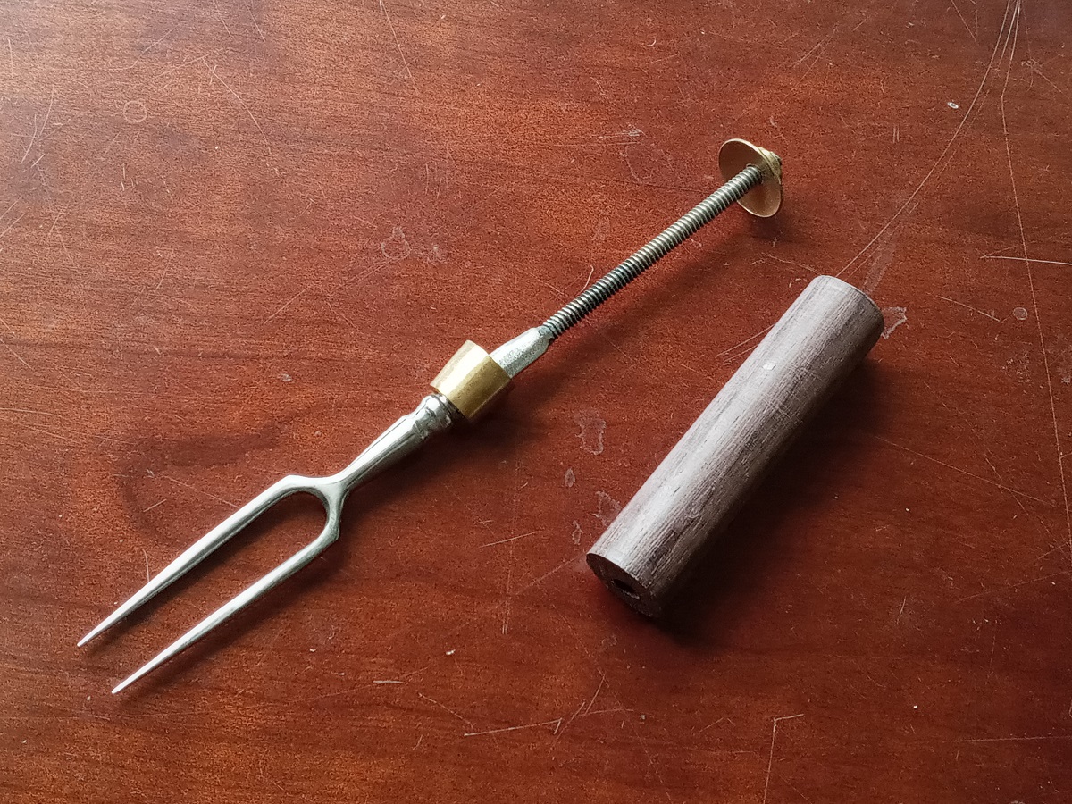

Well, I examined a number of old pickle forks but I eventually settled on cutting the handle off a Crazy Crow fork and getting a threaded rod welded on. I'm satisfied with where it is; just need an opportunity to take the lathe outside and shape the grip (it being rosewood, I don't want to do that part indoors).

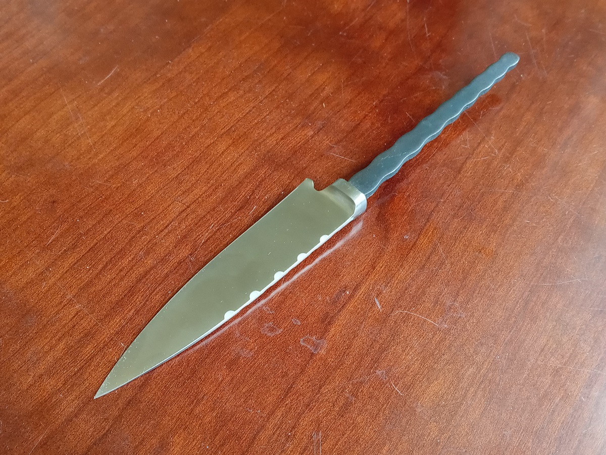

PostPosted: Sun 27 Jun, 2021 12:27 pm    Post subject:         Reply with quote
Seigen gaucho-style blade 4.88" long, should go well with a large, broad-bladed dirk. More distal taper than I'd like, but it does start at a good 3mm. The slightly square bolster will need to be ground to a more circular shape and I should probably get rid of that little thickened bump on the shoulder, which is a sort of proto-finger guard that I've never seen on an 18th-century knife, although it does make the shoulder much more comfortable against the forefinger.
