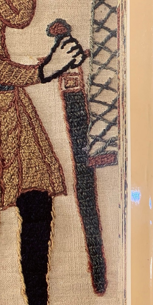

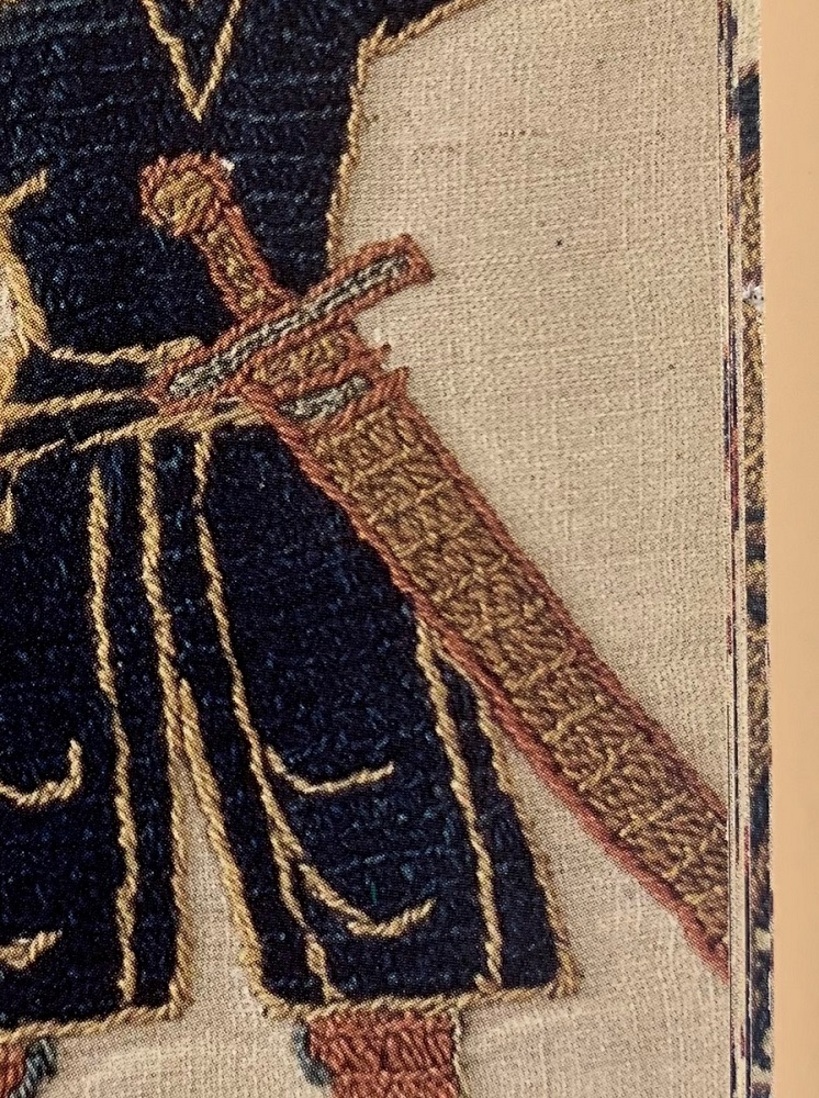

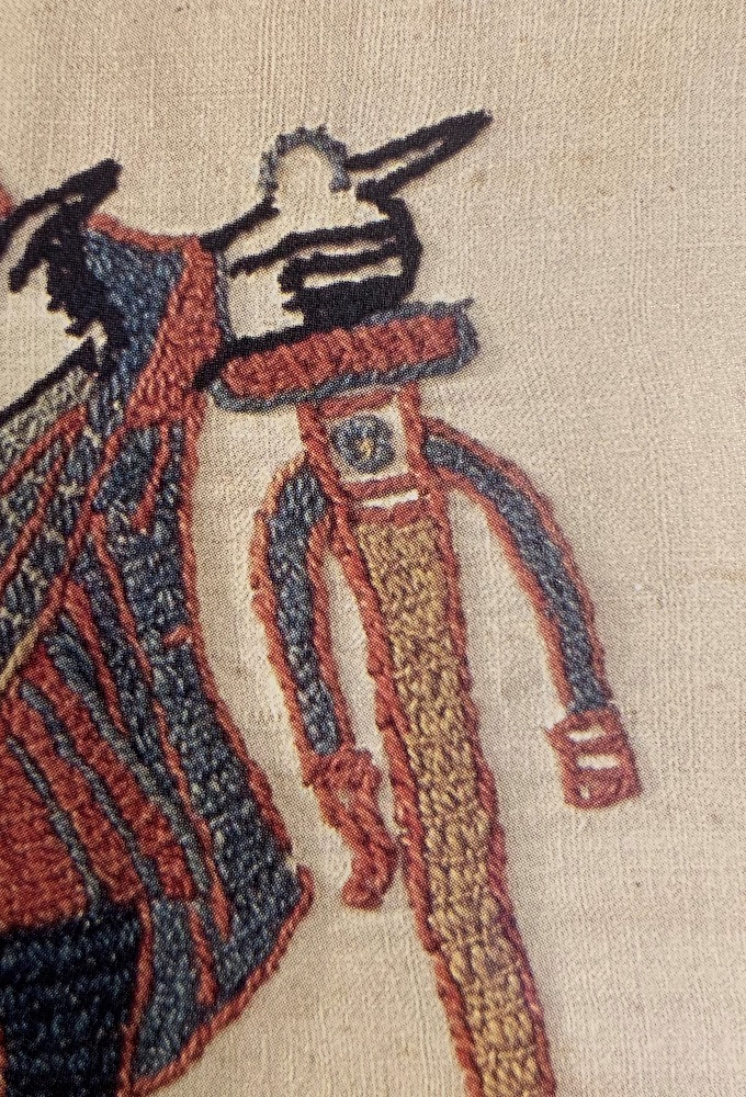

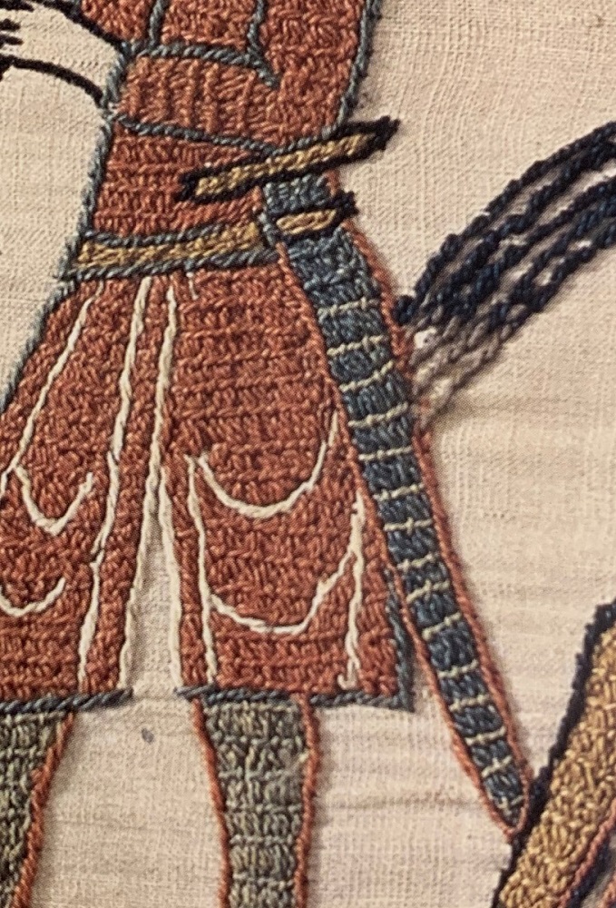

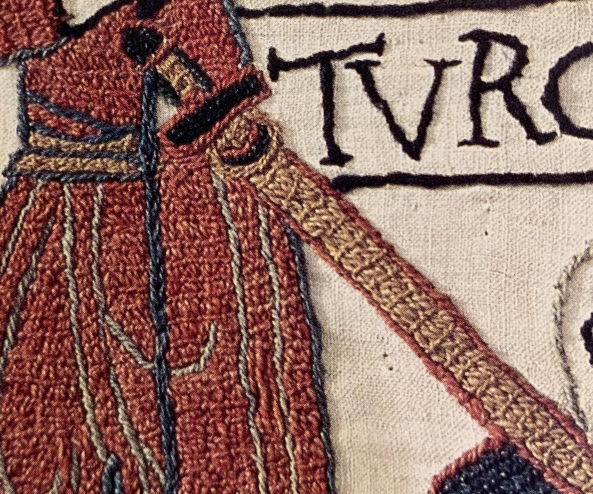

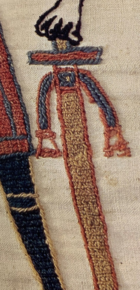

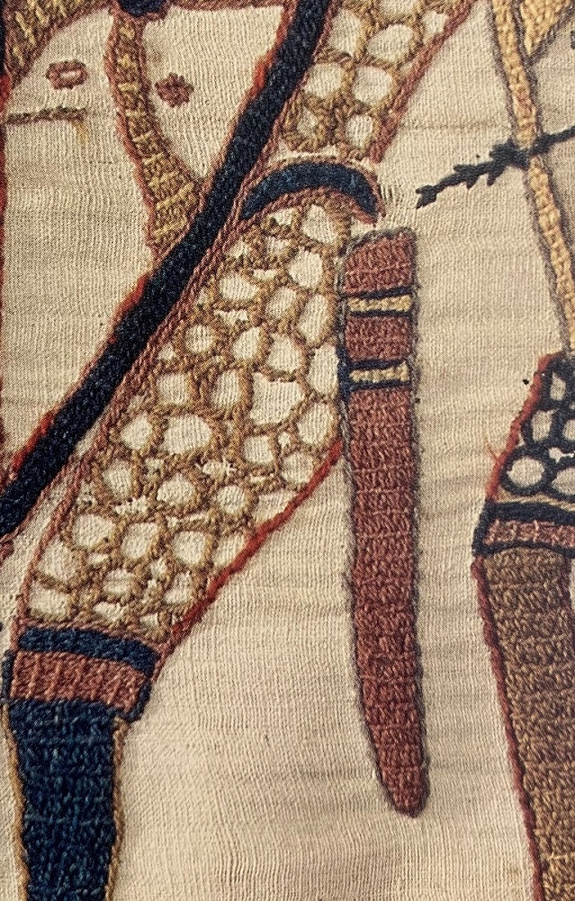

Got a few better pictures of the scabbards of the Bayeux Tapestry (attached below).
I'm not sure about what to make of what is going on at the top of scabbards 1, 2 , & 5. I have interpreted it as the slider showing up between the wrapped belt as I mentioned above. There also appears to be a section of white covering at the top of the scabbard under the wrap. Perhaps this is similar to some of the decoration that is seen at the top of scabbards depicted in the 12th c. Here are some examples of what I mean:
https://manuscriptminiatures.com/4087/12054
https://manuscriptminiatures.com/4087/12056
https://manuscriptminiatures.com/4087/12055 (guy at the bottom)
Scabbards 1 & 2 also show the buckles nicely. Again I'm not totally sure what to make of it. It almost looks like there is a similar buckle on each end of the belt (especially #2), and they appear too short. Perhaps they attach to another belt. Anyone seen anything that could match this in other art or archaeology?
I also threw in another wrap option that makes a shape similar to what scabbards 1, 2, and 5 look like, but it's just a complete stab in the dark.
Feel free to disagree with any of my idea/assumptions. Happy to hear any other possibilities of what could be going on with these scabbards or with any others from the 11th c..

Harry Marinakis
Posted: Thu 18 Mar, 2021 6:06 am Post subject: |
Fascinating work.
I agree with your conclusions, with one exception. I don't think that there is a vestigial slider. The belt is probably woven through the leather scabbard cover.
Kai Lawson
Posted: Thu 18 Mar, 2021 8:31 am Post subject: |
I also agree by and large with your work, and appreciate your scabbard wraps and variations. However, while I agree with your analysis of belt widths for this time period, earlier Continental Ottonian manuscripts of the Reichenau tradition (c. 990-1020/1030) seem to show holdovers for the narrower belts along side wider, non-buckle pale belts, which could well be cloth or tanned leather. Indeed, there is some chance that the belts in question could be fabric--including tablet woven examples--or leather, or fabric-and-leather combo belts.
Additionally, how would you reconcile the narrower strip work of your scabbard wrap examples with wider belts for around the person? Do you suppose that the belt ends are separate for each side, weaving together in some way, similar to later integrated suspension systems, or do you think that the belt was extra long with a narrower section that forms the scabbard wrap portion? Or neither, and the belt is just wider throughout the whole thing?
Curious to hear your opinions.
EDIT: I agree that the slider is likely not present later in the 11th century, especially on the Continent or in places of strong Continental influence, where they may have disappeared as early as the first quarter of the 11th century. Areas of Scandinavia or northern England/Scotland/Orkneys might show slides as late as mid 11th century, but by 1066, I think it would be unlikely in a general sense.
"And they crossed swords."
Tyler C.
Posted: Thu 18 Mar, 2021 9:19 am Post subject: |
Harry Marinakis wrote: | Fascinating work.
I agree with your conclusions, with one exception. I don't think that there is a vestigial slider. The belt is probably woven through the leather scabbard cover. |
Thanks for the comment. I'm curious, what makes you lean to that conclusion?
Kai Lawson wrote: | I also agree by and large with your work, and appreciate your scabbard wraps and variations. However, while I agree with your analysis of belt widths for this time period, earlier Continental Ottonian manuscripts of the Reichenau tradition (c. 990-1020/1030) seem to show holdovers for the narrower belts along side wider, non-buckle pale belts, which could well be cloth or tanned leather. Indeed, there is some chance that the belts in question could be fabric--including tablet woven examples--or leather, or fabric-and-leather combo belts.
EDIT: I agree that the slider is likely not present later in the 11th century, especially on the Continent or in places of strong Continental influence, where they may have disappeared as early as the first quarter of the 11th century. Areas of Scandinavia or northern England/Scotland/Orkneys might show slides as late as mid 11th century, but by 1066, I think it would be unlikely in a general sense. |
I'm glad you brought up the belt width because I was just rethinking that original estimate. My original number was based on relative size in the Bayeux Tapestry, but I think this may be more to do with the limitations of the medium as many of the similar manuscript example show much narrower belts. My thinking now is closer to ~0.625 width.
Regarding the slider, same question as for Harry. I agree that the use of the slider as a slider was gone by this point, but is there anything to suggest that a similar feature of the scabbard (i.e. a hard structure of wood/bone/metal) was not used under the cover material to help keep the belt wrap in place. I'm not saying I have evidence to support that it was still present, but I would like to see any evidence in either direction.
Harry Marinakis
Posted: Thu 18 Mar, 2021 9:47 am Post subject: |
Tyler C. wrote: | Thanks for the comment. I'm curious, what makes you lean to that conclusion? |
The slider was long gone by this period. It's also way too high for a slider to be present.
https://manuscriptminiatures.com/4688/12045
Of course, good luck proving that I'm right, or proving that I'm wrong.
Greyson Brown
Posted: Sun 21 Mar, 2021 12:43 pm Post subject: |
At least a couple of those "slider" pictures look more like slits in the leather to me. A slit in the leather would serve a very similar function to a slider, and be in keeping with the attachment of integrated belts that we see in only slightly later periods, so I am inclined to think that is what is being depicted, but I don't have any hard proof for that.

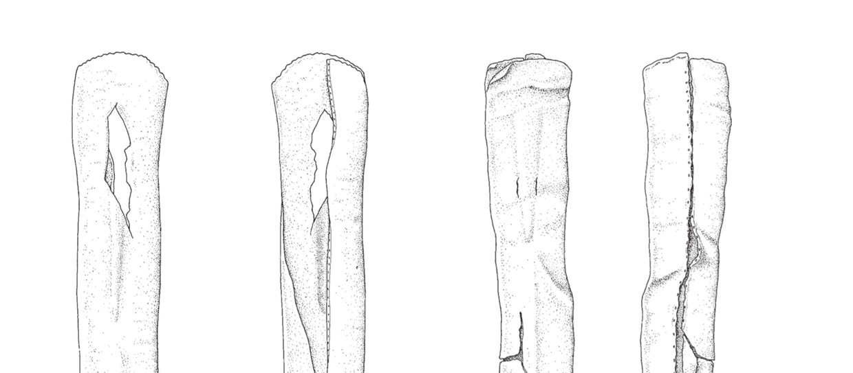

I was just reading in “Leather and Leatherworking in Anglo-Scandinavian and Medieval York” by Q. Mould, I. Carlisle, and E. Cameron. In this report they discuss a few interesting scabbards. Here is a short excerpt describing a couple:
“15837 comes from a late 11th- to early 13th-century context (2050) and is chronologically the earliest. This find represents two scabbards, both of which have features in common with pre-Conquest examples including convex shaped mouths edges with binding stitch, a strap-slide impression bordered by slits, and linear decoration raised in relief."
One of these scabbards is described as having "abraded marks suggest two lines radiating downward.". This could possibly support the idea of having the belt crossing the front like some of the possibilities I have shown. I wish that a picture of this fragment was included. Later in the document they stated the the dating of these two examples was changed to pre-conquest (I believe this means early 11th in this case).
There are also a few other examples from early 11th century contexts with sliders. One fragment also had evidence of a slider and a raised central ridge running down the entire length of the front. There appears to be at least some evidence that sliders were still present on scabbards into the 11th century in the York area.
One common feature of these finds that I can’t figure out is the convex upper edges. I can’t recall seeing that anywhere in scabbard depictions of this period. It appears a lot in later scabbards that have edges that rise above the mouth and cover the sides of the guard, but not so much in 11th century and before as far as I have seen. In the document, it is attributed to the curvature of the guard, but I don’t buy it. The curvature is much too steep to match the curve of guards at the time, and there are a few that even have right angled points. These especially are not matching the curve of a guard. Bit of a mystery to me at the moment. Any ideas?
Also, If anyone has any more sources or theories in anything related to 11th century scabbards and suspension, please do not hesitate to post it even if it does not flow with the discussion. Would love to hear your thoughts.
Kai Lawson
Posted: Wed 31 Mar, 2021 7:13 am Post subject: |
I'll add a photo of my old scabbard (unused now for some time) to illustrate what I meant. I did not make it, but there are only 2-3 risers and laced belt straps holding the whole thing up. It was made for my Albion Gaddhjalt, which isn't particularly heavy, but has quite a bit of blade, and that moving back and forth would put some decent stress on the leather, I should think. Still no obvious stress marks. Just some staining.
I'm very curious to know how the analysts verified that there was a possible slider impression and possible diagonal impressions (belts, as you said?). Would love to see an image of that, and get an idea as to the leather thickness.
As to the sliders on scabbards in York in the 11th century: if you look at an image of the York scabbard (drawing or actual photos of the find), you'll see both a slide impression and a gently curved top section, with what could easily be described as holes or perforations for lacing. I've attached another scabbard leather image that shows the same thing.
I still say that slides could be found all over Northern and Western Europe until 1030 or so, and like longer in some places where the tradition held out. Based on what I've seen so far, I would hesitate to ascribe them a 'common' status past 1050 or so, in a general sense, though I'll concede that they could have existed into the first quarter of the 12th century, though I feel that they would have come across as a bit old fashioned and 'backwater,' even if they were modified to be small and were covered with an integrated belt. For the sake of erring on the side of caution, I would make belts after 1050 laced for Continental contexts, unless you are citing a specific find with strong evidence of a slider.
That said, if you feel that you'd like the extra security of a small metal piece for security reasons, as long as it isn't really visible, go for it. I put a thin brass ribbon cut into a 'chape' at the end of my scabbards before I cover them. It isn't visible on the finished piece, but it helps stop the thin slats I use from splitting over time when the sword is sat upright on hard surfaces.

Tyler C.
Posted: Wed 31 Mar, 2021 4:55 pm Post subject: |
Kai Lawson wrote: |
I don't know for sure, but I would assume visually. In the fragments that I have seen pictures of it is actually quite obvious where the slider is and what shape it is by the impression left. It was also easy to see where the wear had happened on the outside surface. Not sure if there were more technical processes used to confirm these observations.
Kai Lawson wrote: |
Are you suggesting there that the holes in the top could be lacing for suspension? I have always assumed that these are for attaching the mouth/lining of the scabbard or finishing the top edge. Not sure I've seen evidence that this could be for suspension.
Kai Lawson wrote: |

To respond to your responses:
I wanted to get more information for the strap impression analysis because I have seen artifacts mis-labeled or mis-identified a number of times, and didn't want to assume that the fragments had been correctly analyzed without question.
Secondly, I think that the upper edge of the scabbard cover fragment drawings I showed would be sewed to a liner, in my opinion. I agree with what you said, but included them as you mentioned in a previous post that you were having trouble picturing a convex scabbard 'mouth,' and I assumed the authors were referencing the scabbard covering and not the wood beneath.
I would personally describe an 'integrally laced belts' as something that can work with and without sliders, and I'll admit that most of the art/sculpture I have seen shows ambitious attachment methods, including the possibility of sliders (see the image linked from Spain, listed as being from 1050--1100. Based on the style, I would lean earlier, but it would still likely be around or after 1050, and the scabbard lower right sure looks like it has a slider).
I am quite aware of the 'hidden-ness' of sliders from the Migration era through to the end of slider use in Europe. The external visibility of sliders is a separate but potentially related issue. That being said, though I dislike citing evidence for X using material of 100+ years off in either direction, I do want to point out the scabbard of the sword of Sancho IV of Castile, as well as Fernando de la Cerda, both of which could admittedly be burial items. The actual leather belt of Sancho's sword was cut off but the suspension around the scabbard was left in place, and does not show strong stress marks related to holding the sizable sword (aside from the little bit of bend for that central Z strap. I'm specifically looking for stress on corners or edges). A non-integrated suspension option is absolutely possible for the period in question, and is likely attested in some of the Ottonian manuscripts. Fernando de la Cerda's sword is a little worse for wear, but again, not many obvious stress marks on the scabbard for a minimally integrated belt. These are royalty items, so how much use they saw and their treatment for burial is questionable, but their status doesn't automatically preclude them from being somewhat representative of lower-status swords as well.
The point being, sliders could well be present, but it can be difficult to identify them in art or sculpture. However, non-integrated or minimally integrated belts are also a possibility, and could possibly hold and retain a sword well enough with non-obvious stress indicators, and could also appear similar to a hidden slider in some of the art. Mix-and-match suspensions with lots of variation and parts of multiple systems could also be present.

Just to throw another thing in the ointment: I’ve also attached an image of non-integrated belts that look like integrated systems, which is also a system we could be seeing (out of period? Yep. Did I just notice the suspension system today? Also yep). How likely is this? No idea. Possible? Yeah. Reasonable? Perhaps. We have numerous images and finds from around 1000 AD that show either slider traces or fairly clear non-integrated systems. Would elements of each have carried on for 100 years? Likely depends on the place. Art and sculpture is tough, because often there is no visible suspension detected, as you know, so we have to ask if it was left out, or truly not visible to the viewer? It could be a single slider on the back, but maybe not. There is enough variety during this period depending on decade or location, and enough of a paucity of evidence that it’s hard to draw solid conclusions. Based on what I’ve seen over the years, and functional notes of reproductions and my own experience (not the best data, but it’s what I have), I feel that partially integrated belts or non-integrated belts are likely the ‘norm,’ such as it is, for most of Continental Europe from about 1050 onwards. I don’t feel that the slider is required to have a belt pass through the covering bordered by risers and wrapped around once, but I don’t have a specific thing I can print to and say "see? this is a real thing from X place at X time and shows what I mean.”
Attachment: 114.69 KB
Attachment: 26.34 KB
