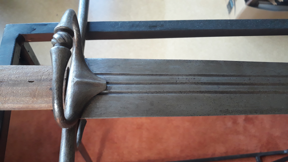

I've begun another project sword. This one is using the blade from a Windlass German Bastard Sword, an unknown old pommel and cross guard.
I ground three fullers in the blade and have begun dressing them with riffler files.
I filled some ugly details that were on the quillons with some weld beads and blended them in.
I turned some finals on a lathe, forged them to shape, then spliced them into the side rings for some added detail. I don't really have a historical precedent for this specific detail, but aesthetically I felt it needed something.
I plan on welding in a projecting tongue on the quillon block to give it some substance, you might be able to see the sharpie outline in one of the photos. This will give me some space for a bit more detailed file work.
I'm just improvising with this piece, making use of some pieces I had in the shop. I wish this was modelled after a specific historical piece.

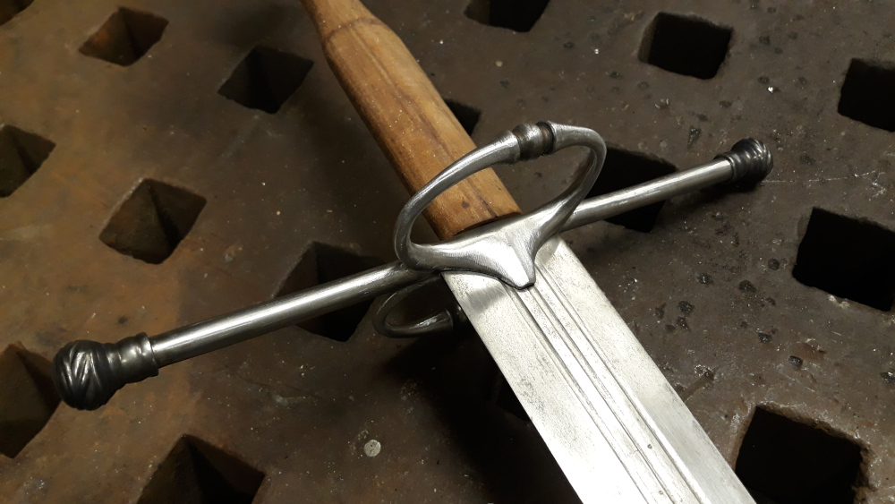

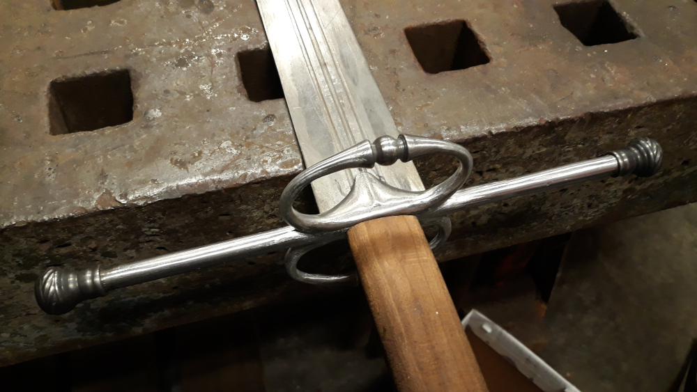

Tonight I welded in an extension to the quillon block. I also built up some weld beads at the base of the side rings to make a tapered transition.

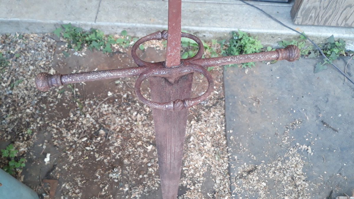

Posted: Tue 01 Jun, 2021 7:29 am Post subject: |

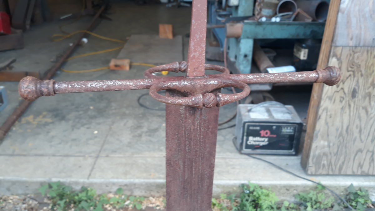

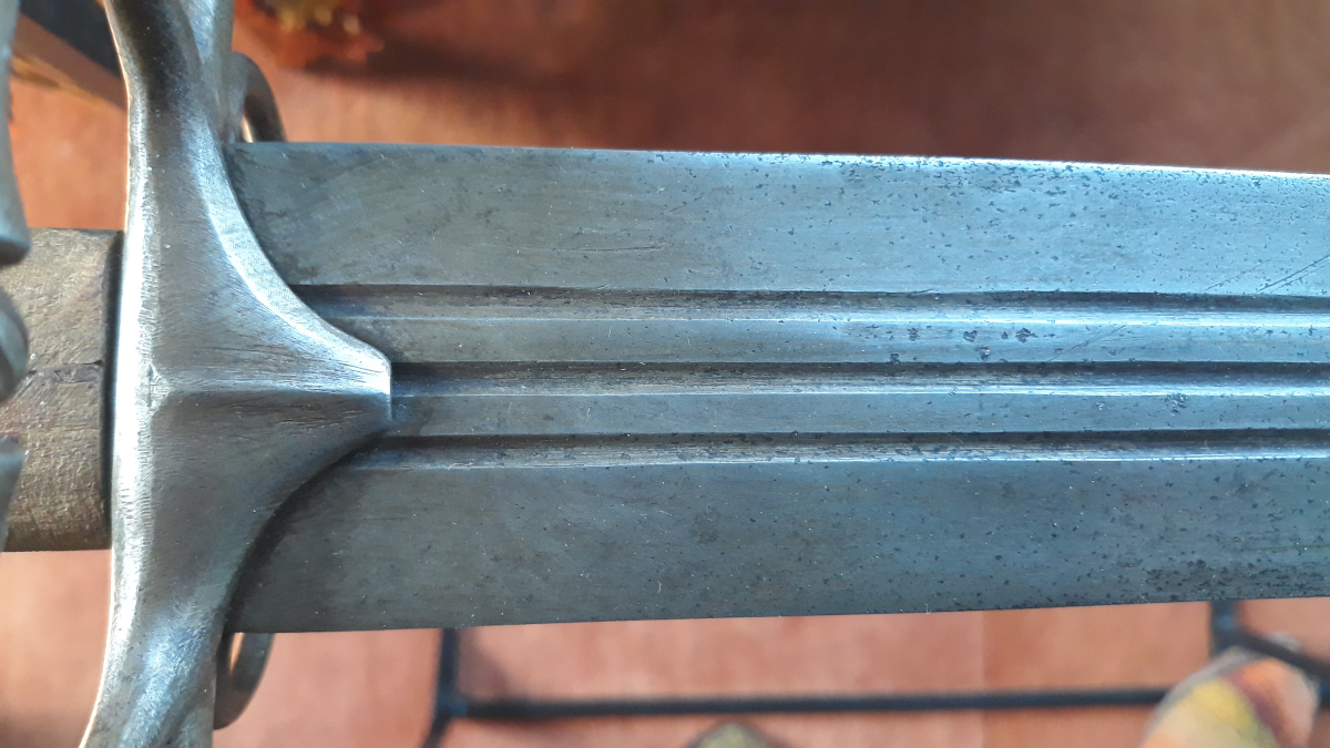

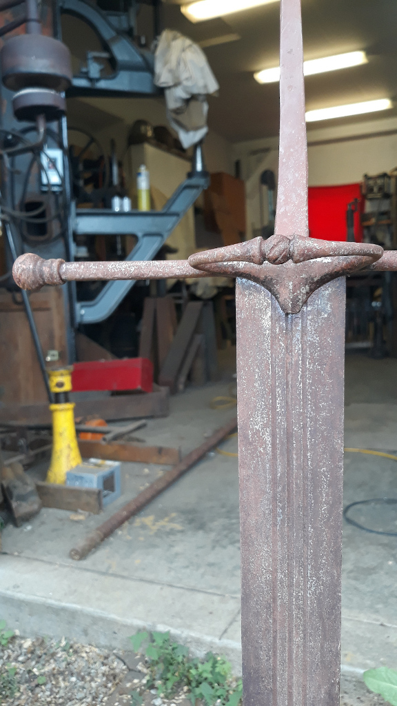

I found time to pick up this project over the holiday weekend. I finished the guard with my finest files and a bit of emery paper. I then drove the guard on for final fitting and center punched around the tang. For patina I started with reverse electrolysis for a couple hours until the surface texture was fairly uniform. From there I used a vinegar and salt solution to advance the rust. I'm still exploring how much texture I want for the finish. I've been very curious how the welding on this project might become apparent when I began to deliberately corrode the piece. So far nothing is jumping out at me through the oxide.

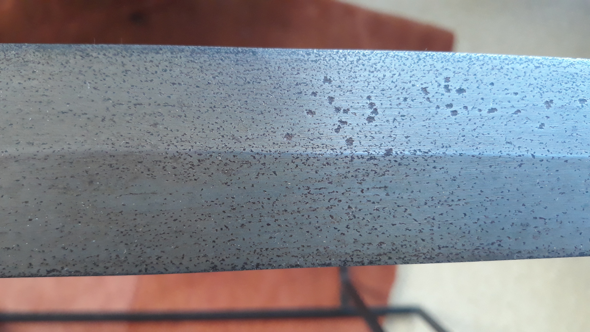

M. Adair Orr
![](images/avatars/180791484560ba4607ed686.jpg)
Posted: Thu 03 Jun, 2021 11:02 am Post subject: |
To continue from the last post:

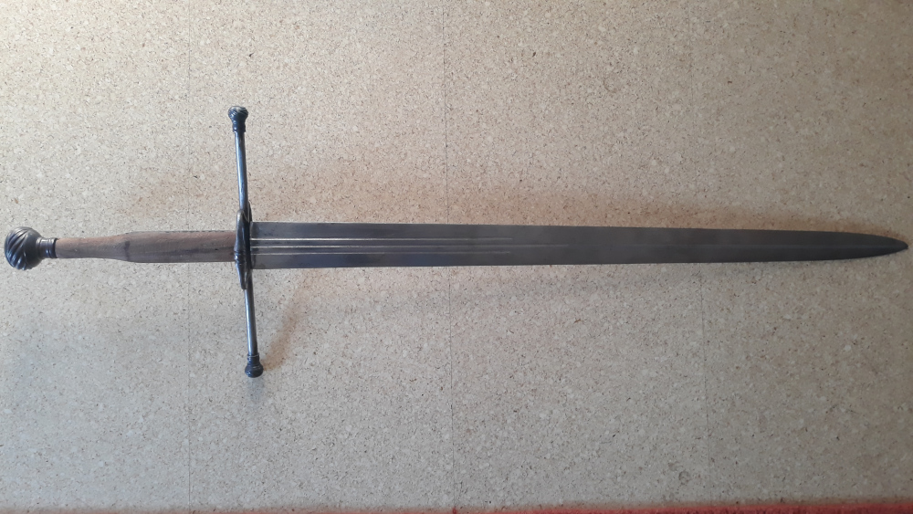

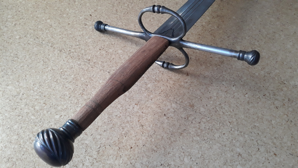

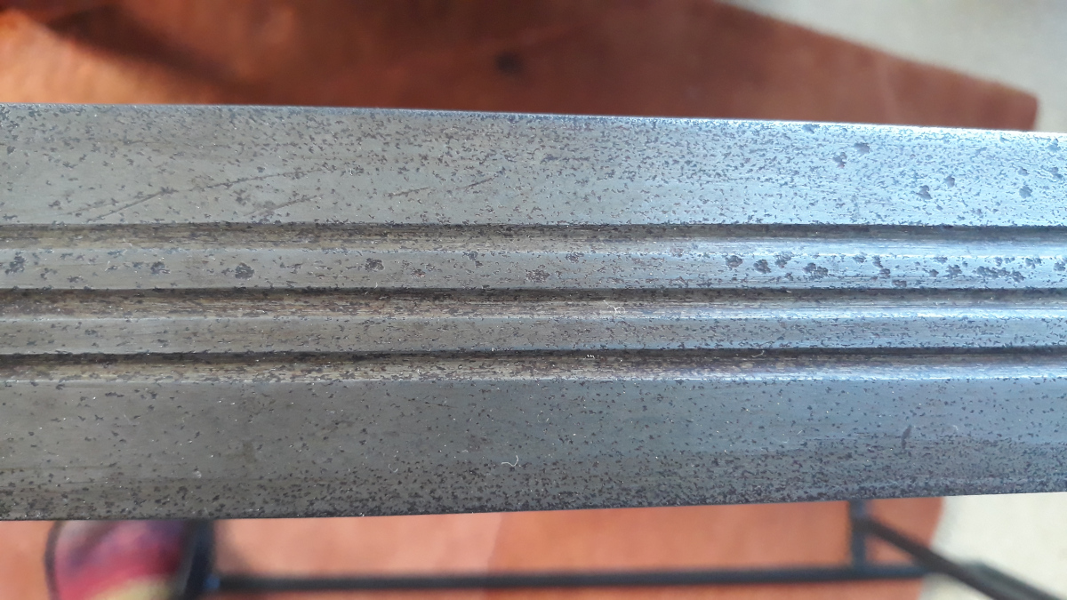

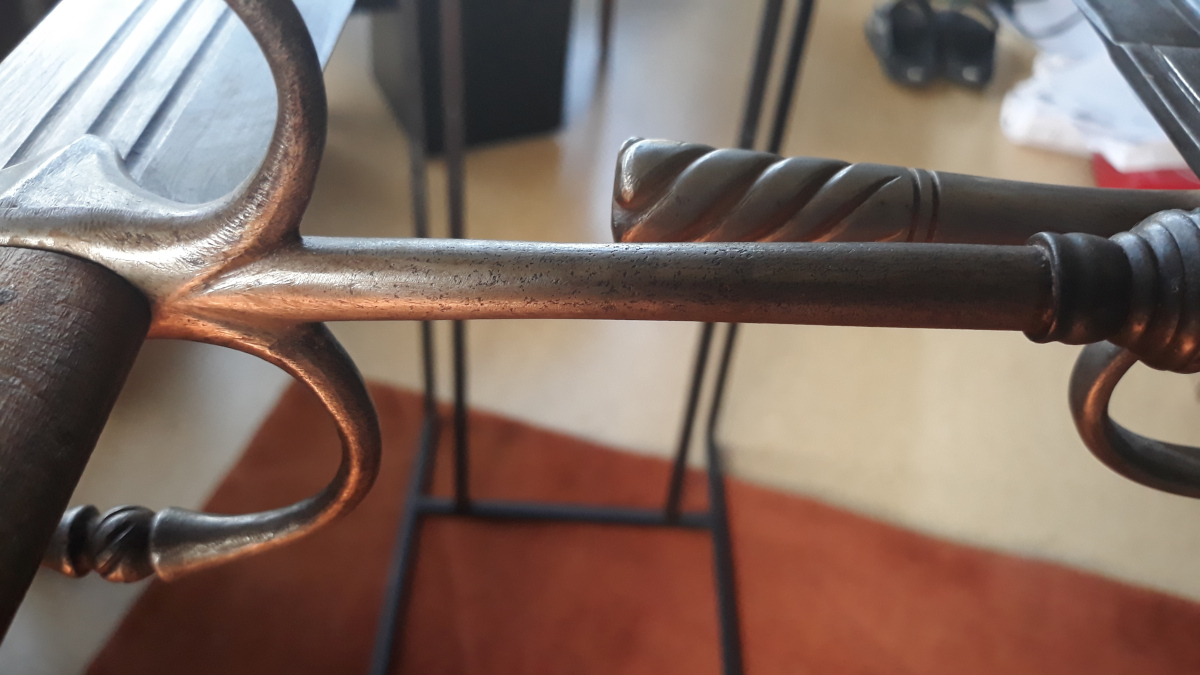

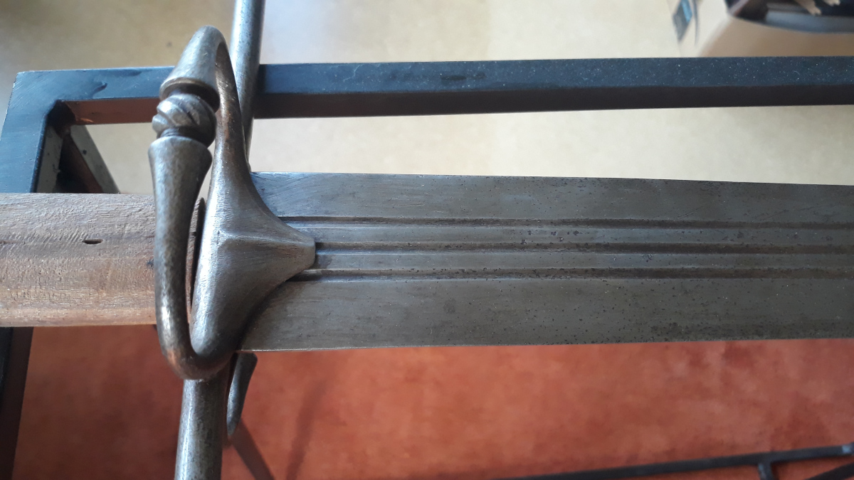

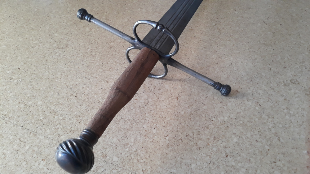

I continued to spray the sword lightly for a couple days. Every time the moisture evaporated I would hit it again. Below are the results after removing the loose oxide with steel wool.
My welds did react differently than the parent material in some instances. They don't show up in these photos but with some scrutiny the eye can pick them up. In the future I'll have to gas weld with matching filler material if I want to avoid this.
I think I went overboard with the reverse electrolysis. The process tended to pit in random areas even though I had anodes spread evenly along the work. No matter, it's all an enjoyable experiment. On the next project I'll have a bit more command of the techniques and be able to anticipate the results.
I'll wrap this grip and add it to the collection. I do like the aesthetic of visible tool marks, scratches and pitting on a satin grey surface.
