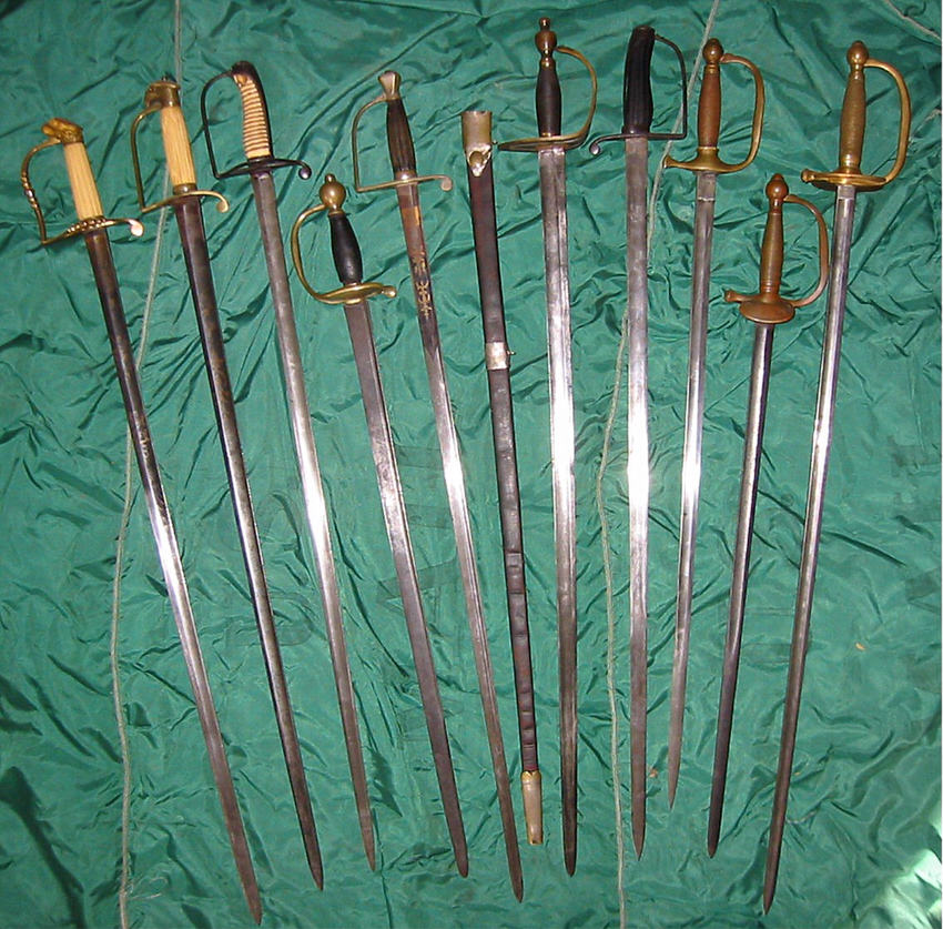

The short straight blades were favored by the French until the briquet sabres with cast grips. Both double and single edge.
The US made good use of short backsword blades with nco swords from both Rose and Starr from the early 19th century until the 1820s and beyond.
GC

Sabre Troupes Marine
Half hilt

Starr 1818

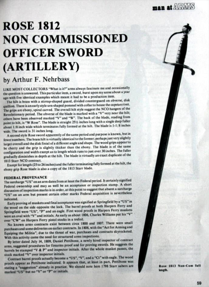

Rose brief [ Download ]

I own both a sister of the 1750s French sword pictured and that is my Starr 1818 above. I did buy a repro of the Rose swords which is very close to true and with the longer blade of this auction. Owing many period swords, I am quite impressed with this India made reproduction.

Having owned many spadroons, these short and wider blades aren't really spadroons but what's in a name. Here is also an old picture of my French hanger with longer spadroons. The short sword on our right is a US Marines musician boy sword.
GC
