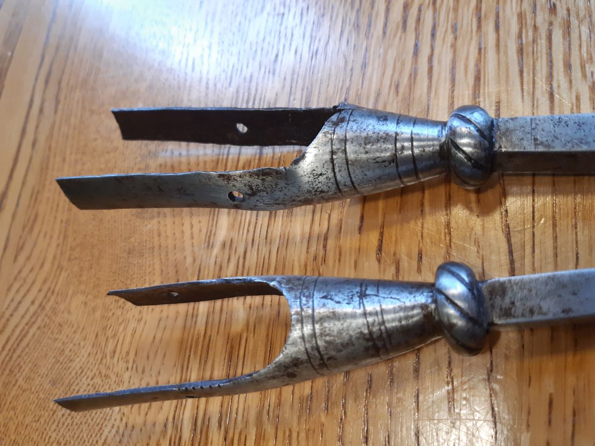

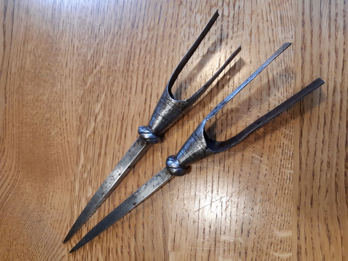

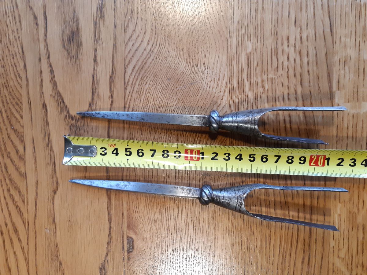

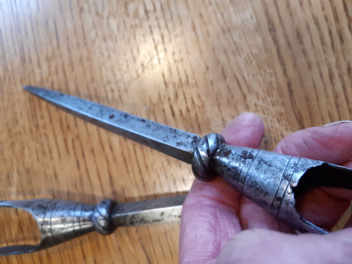

I've posted this pair of pike heads also on a other forum. Not quite sure what they are. Someone suggested there that they might be 1500s armor piercing pike heads. Can anyone clarify this? Thanks
 Attachment: 203.42 KB
 Attachment: 161.52 KB
 Attachment: 105.36 KB
 Attachment: 176.55 KB

Dear M. Hermes,
These are pike-heads with bodkin points, rather than leaf-shaped points. The bodkin style is less common than points with leaf-shaped blades, but not by any means rare. I'm not aware that there's any evidence to suggest that bodkin points were considered especially well suited to piercing armor. Perhaps they were more durable, but mostly I think they were simply a different style than leaf-shaped blades. They may have been easier to make, but the ornamental work on the points that you show suggests that any potentially greater ease of manufacture is unlikely to have been a significant factor in choosing one style or the other. The spheres between the blades and the sockets suggest, as your other informant indicated, that these are sixteenth-century examples. There's some evidence that this ornamented style may have been most popular early in the century, before 1530, at least in England, but it appears to have persisted throughout the century, particularly in Italy.
You can see bodkin-point pike-heads and pike-heads with beads and decorated sockets like those you show, on the British Royal Armouries' Web site. If you prefer, you can also go to their collections search page and look for other examples. My search was for "pike" in the 16th century (the first entered in the dialogue box, and the second chosen in the date filter).
I found two photos with other examples like yours, combining bodkin points with the spherical ornaments in the Royal Armouries' collection:
Object Number: VII.767
Object Number: VII.137
(I'm not sure that the object numbers in these cases refer to the points showing both bodkin blades and beads. In fact, in the first case I'm sure that the object number is for the other pike.)
Edited to add: Here's an ornamented bodkin point from the seventeenth century:
Object Number: VII.2952
This is just a quick answer without extensive research. You may well be able to find more.
I hope this proves helpful.

Nothing to add to Mark Millman's identification but the langets on your examples are very short and oddly squared off. Be worth a look to see if they have been cut down when the object has been removed from the pike shaft to make them more convenient as stand alone pieces.

Dear M. Hermes,
You're very welcome. I'm glad I could help.
Do please note that, despite your flattering reply, my answer is far from comprehensive. I looked for examples in only one place, because I already knew that the Royal Armouries have pike-points ornamented like your pair in their collections. You may well be able to find closer matches in other museums' on-line collections if you want to make a more precise identification.
As Anthony Clipsom says, if you have physical access to the points rather than just photos, you may want to try to determine whether the languets have been cut short. That could be another clue to identification.
Edited to add: On a second look at the photos, I'd bet that the languets have indeed been shortened. If they had originally been their current length, I'd expect their nail-holes to be right at the ends of the languets (in that case I imagine the complete pikes would have had additional, much longer iron straps, the tops of which would have fit under the languets).

Hello, I bought them at an auction last week and have them at home. Unfortunately the langets are indeed shortened as you thought you saw.

I have a much less in depth question: what is the cross section? Square, I assume?

Yes they are more or less square. It differs slightly between the two and also on wich side you measure. About 9mm.

Interesting dicussion! On the other forum someone suggested that they might not be pike heads at all. He keeps open the possibility that it is the butt end of pole weapon like a halberd or another pole weapon.I don't think that a butt end would have had langets.
Mark Millman
Joined: 10 Feb 2005
Posts: 592
PostPosted: Thu 28 Jan, 2021 12:09 pm    Post subject:         Reply with quote
Dear M. Hermes,
I can't say definitively that no staff weapon would have had languets on its buttspike, but I'm confident that he is wrong. Even a cursory inspection of the pike points in the Royal Armouries' collection will show that your examples are so similar in general and in specifics to other pike points that they really can't be anything else. A key distinction is that a polearm sophisticated enough to have a steel buttspike would not have had a haft with a circular cross-section, because hafts circular (or for that matter any other regular polygonal shape--square, hexagonal, or octagonal) in cross-section make aligning the weapon by feel much more difficult than hafts with more-or-less rectangular cross-sections.
