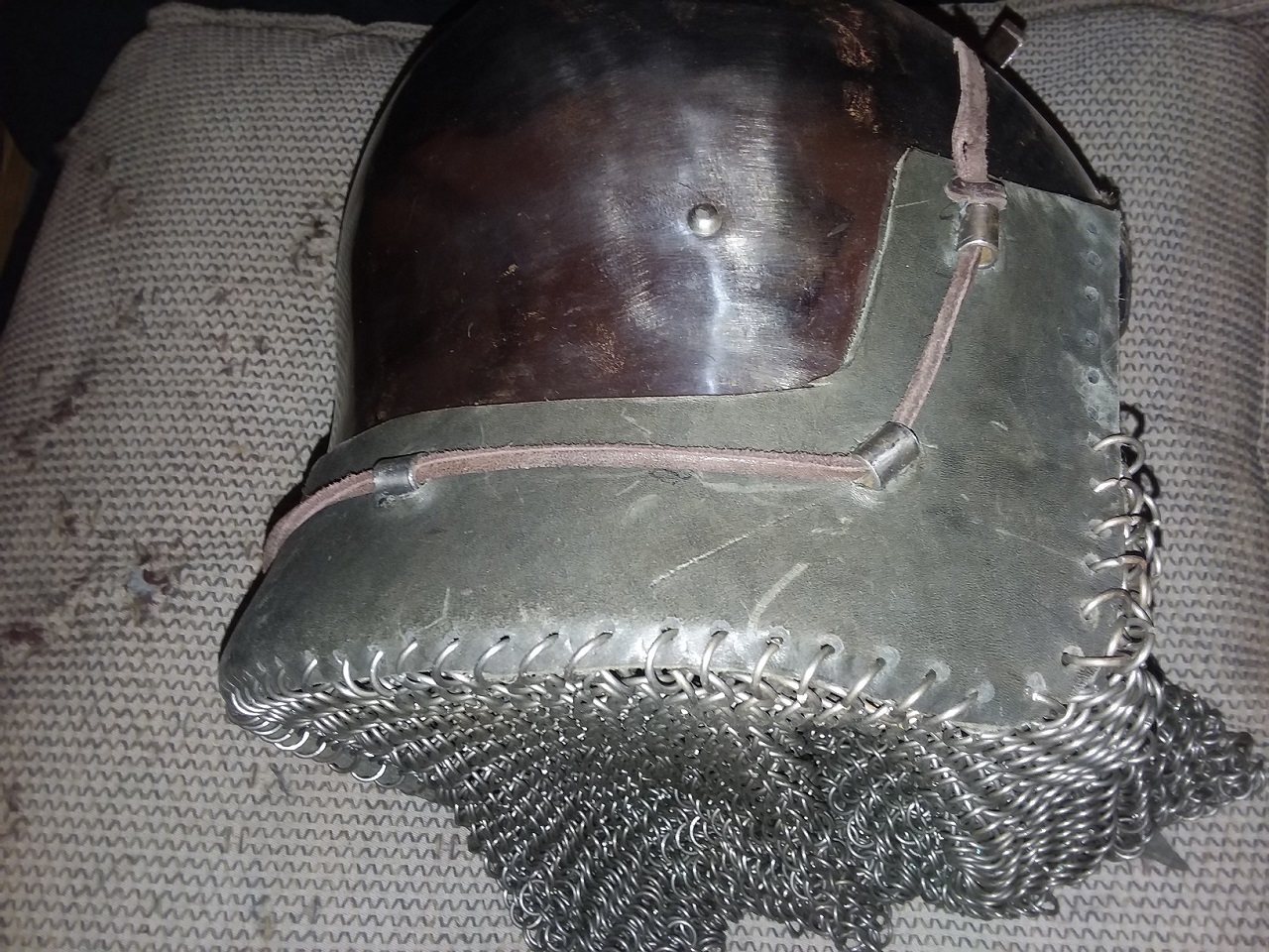

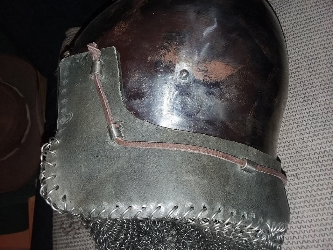

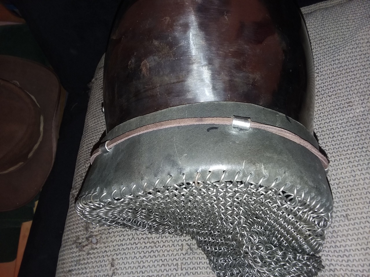

This is how mine was done. Mid-14th klappvisor bascinet with pipe/barrel vervelles. This was a Germanic style. The leather holding the maille (I didn't spring for the more accurate riveted at the time) is slotted for the vervelles and a heavy leather lace is strung through the vervelles to keep it in place. The maille is affixed to the leather with a row of rings.
The main difference with stud vervelles is the shape of the hole in the leather and a smaller hole in the vevelle for a wire rather than a leather lace. I suppose you could use bigger studs with bigger holes to accommodate leather lacing if you chose - not sure that it is more or less correct using the wire.
 Attachment: 432.24 KB
Left side [ Download ]
 Attachment: 476.61 KB
Back [ Download ]
 Attachment: 520 KB
Right side [ Download ]
