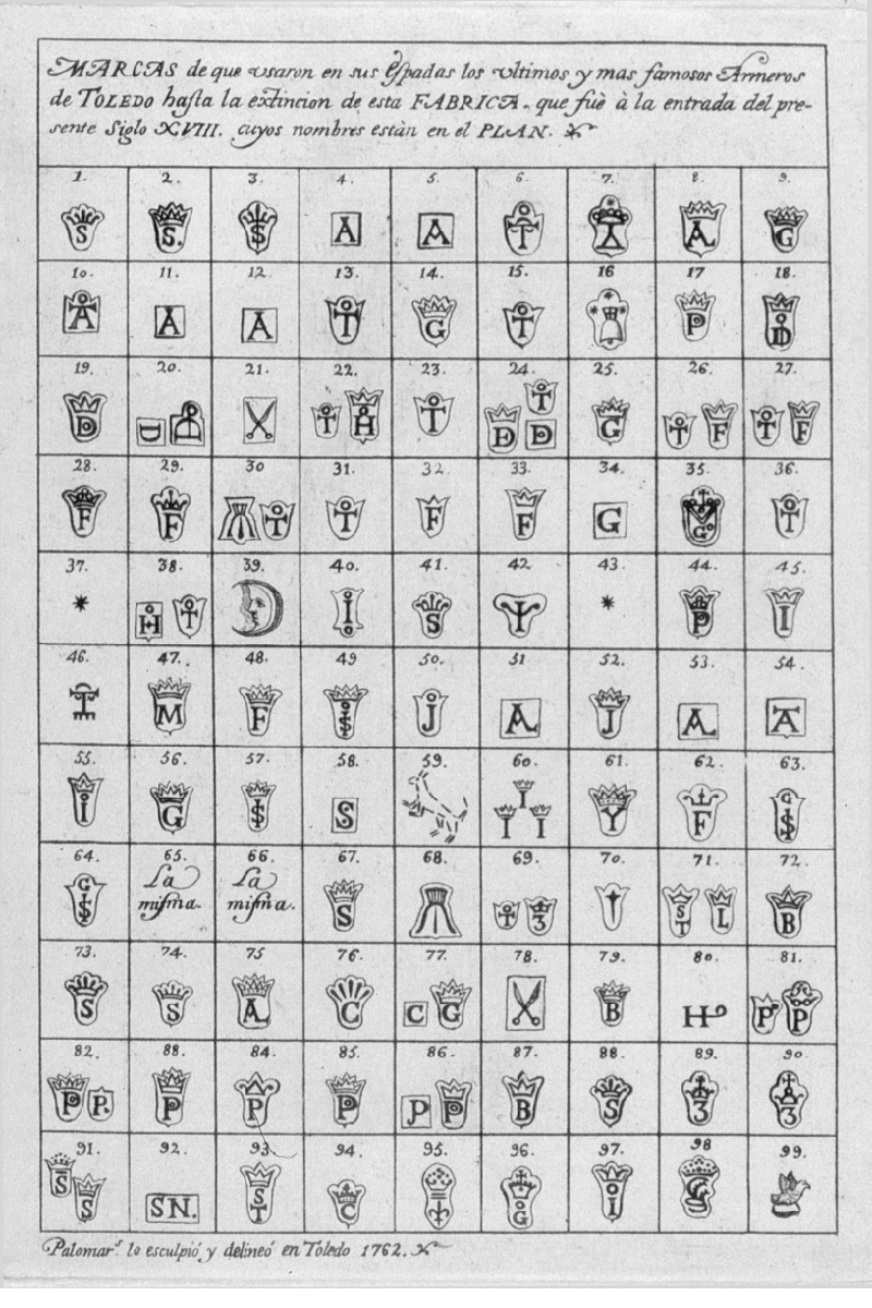

Shannon,
I'm guessing you found this already since you mentioned that the mark on this blade is similar to the marks of Toledo smiths, but #50 on the sheet below is one such mark that indeed is very similar to the mark on your blade. This is the mark of Juan De Salcedo (who also worked in Valladolid). the text on the top of the sheet says something like "Marks that the last and most famous armourers of Toledo saw on their swords until the extinction of this factory that was at the beginning of the present 18th century. Whose names are in the plan", so I assume these are makers marks from the early 18th century or late 17th.
Here is the table of makers:
These are from: http://www.vikingsword.com/vb/showthread.php?...&pp=30
Yes I found those maker's marks. I am excited that the mark on my sword at least conforms to the style of marks used in the 17th and 18th century. I am cautiously optimistic that the blade may indeed be pretty old. I mean if it is a complete forgery of a medieval sword, then they did a pretty lousy job. It makes more sense to me that it is a Victorian or slightly earlier era blacksmith's interpretation of a medieval sword. I don't know if I will ever know definitively.
