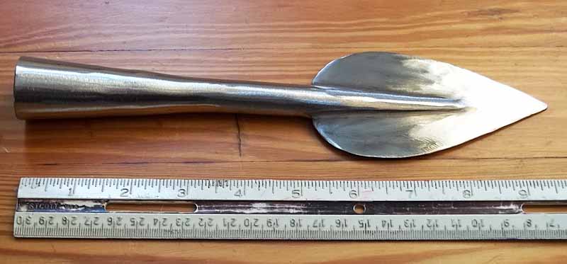

I've modified or converted a bunch of things in my time! And made swords by grinding from scratch, using nothing more than scrap steel and angle grinder. So it certainly can be done! As has been said, though, the problem with a spear or polearm is the socket. And often the transition from socket to blade, which a modern shovel really won't match. BUT there are modern tools with more potential, such as the heavy-duty scraper I rescued from the trash:
Less than an hour with the angle grinder, and I had this:
So I'm thinking that if you find a cheap repro polearm that is at least reasonably constructed (not just flat stock bolted to a piece of pipe, for example), you and your angle grinder could very well make it into something quite nice.
