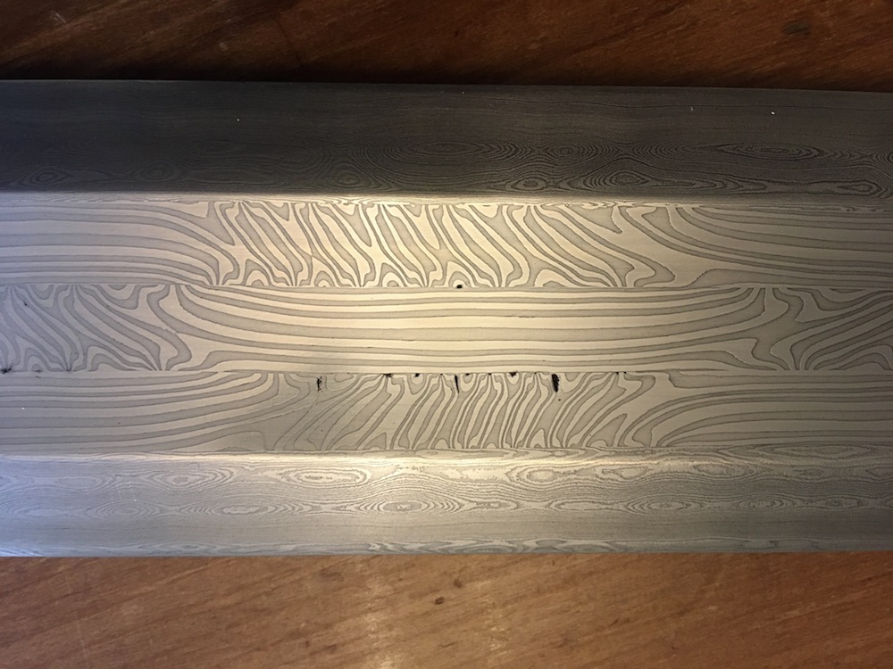

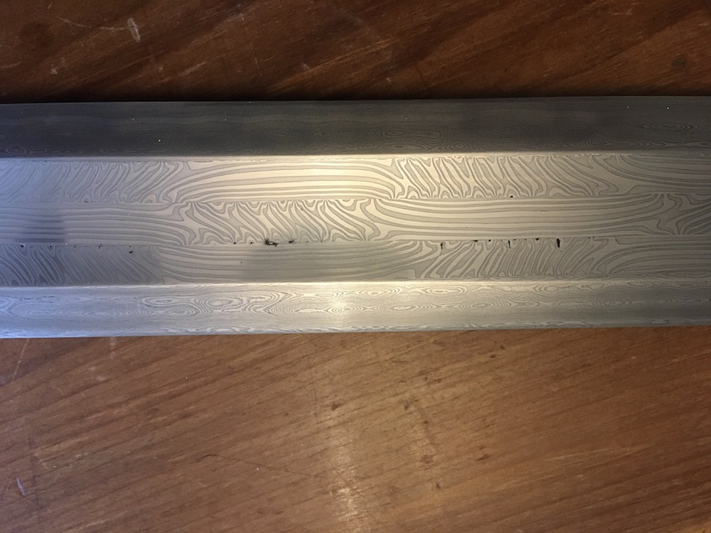

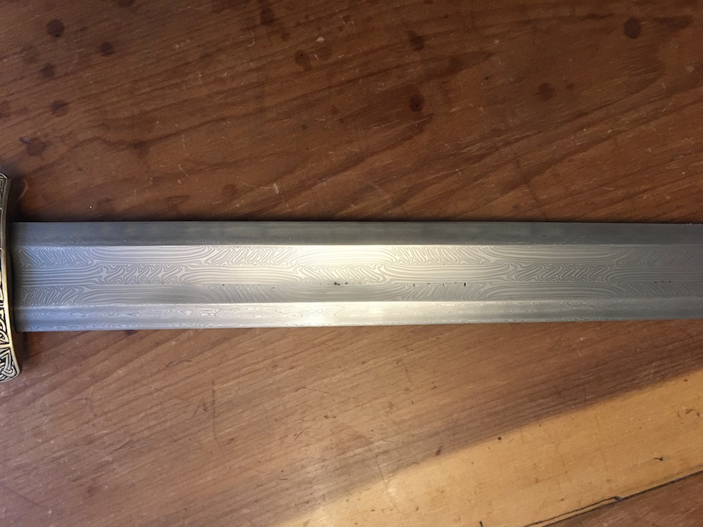

In 2016 I commissioned Rob Miller of Castle Keep to make a Viking era sword with pattern welded. Rob told me that the blade was forged by Mick Maxen.
I was and remain impressed by the craftsmanship and balance of the sword but would like some members opinions on the blade.
You will see from the photographs that the blade contains small pits, little holes in the steel, which over time attract moisture. I did raise my concerns with Rob Miller, but he assured me that this is normal, and referred to the pits as 'inclusions'.
I am not qualified to comment, other than the fact that I own several antique pattern welded swords from Solingen that do not contain these 'inclusions'. I also have studied the pattern welded replica of the Sutton Hoo sword at the British Museum, and can find no pits in the blade.
Could members of this forum please express their honest opinion. I did pay £2,700 for this sword, so would like to know if the blade is 100%.

Hello,
I would say that he is right, in a sense, those are from inclusions causing a poor/imperfect surface on the weld line. Is this correct to the period? Yes.
Is it a fault? That depends. A pit like the ones shown, but in which the weld is solid is not a *fault* per say, it is only a cosmetic issue. A deep pit/ that causes a pause of cohesion in the weld (essentially a bit of delamination) is. This is hard to prove from the photos, but it looks like the welds are solid.
You could, however, get a much better surface and weld. It is a cosmetic issue at the least. Prior to finishing the blade he would have been able to notice the pitting and throw it out. I’m surprised he didn’t. That isn’t something you see come out of the shops from most of the top of the line makers these days.
You are on the cusp, £2,700 is the budget end for top of the line (with exceptions) for a patternwelded sword like this. That being said, the hilt furniture isn’t overly complicated (i.e. there is no complex inlay, etc), so I would think that a huge part of that was going into the blade (where you would expect numerous throw outs for bad pitting like this).
It depends what you are after —a perfect sword, or a historically accurate sword. That being said, I think I too would be disappointed, given the price.

Greetings,
Your post motivated me to closely examine the only pattern welded sword that I own. It is a Viking style sword made for me about thirty years ago (OMG !) by a U.S. knifemaker, who was intrigued by the challenge of making any sword, let alone a pattern-welded one. After two unsuccessful attempts, he made one that he was satisfied with, and so was I. So anyway, I examined the welds carefully, and I could not identify any inclusions. So, there's that.
Your sword is aesthetically more attractive than mine, as are the patterns. I quite like the look of it, especially that wide fuller which I am guessing, probably gives the sword a lively feel due to lightness. Mine is somewhat blade-heavy. I confess, the only information I have about metallurgy comes from watching a weekly US television show called "Forged In Fire." I cannot venture an opinion as to whether those inclusions are "normal," or not. Purely as an aesthetic opinion, they would bother me somewhat. Due to the overall appeal of the sword, however, I might learn to live with them, or perhaps not, I cannot say.

Do you think that these pits could be ground out and the blade re-etched and polished? In answer to your question, I was looking for a perfect blade.
Sorry, but no they can not be.
Unfortunately there are two factors with pits like these. They will be quite deep. The first problem is that if you could grind them away, in order to grind enough material off to make them ‘disappear’ you would make the blade far too thin to be structurally sound. The second problem is that as you remove that material you will likely expose other pits and/or widen/enlarge those that are already there, rather than make them go away. Often the pits only appear as you start to remove significant material (i.e. grinding in a fuller) and actually show that you have already ground too far, rather than not enough.

FYI —I once bought a pattern welded blade like this (as in it had a similar amount of pitting). It was being sold by Paul Binns in the UK for £300. He was selling it ‘as is’ and cheap, as there was nothing functionally wrong with it... and like Hadrian said it is probably historically accurate... but he didn’t want to mount it/sell it with the expensive commission he had been intending the blade for. As the welds were good, just pitted, he finished the blank and sold it to me cheaply, and remade a new one for the commission.
