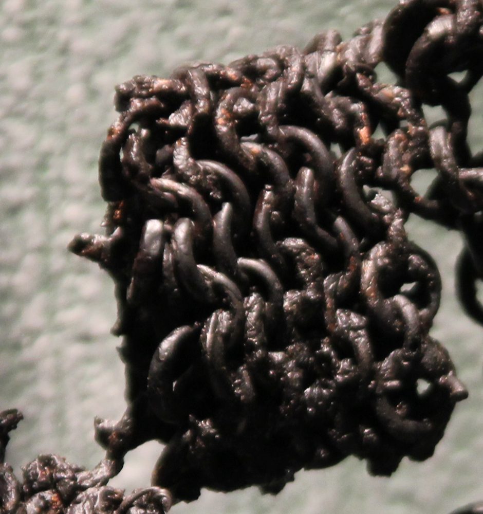

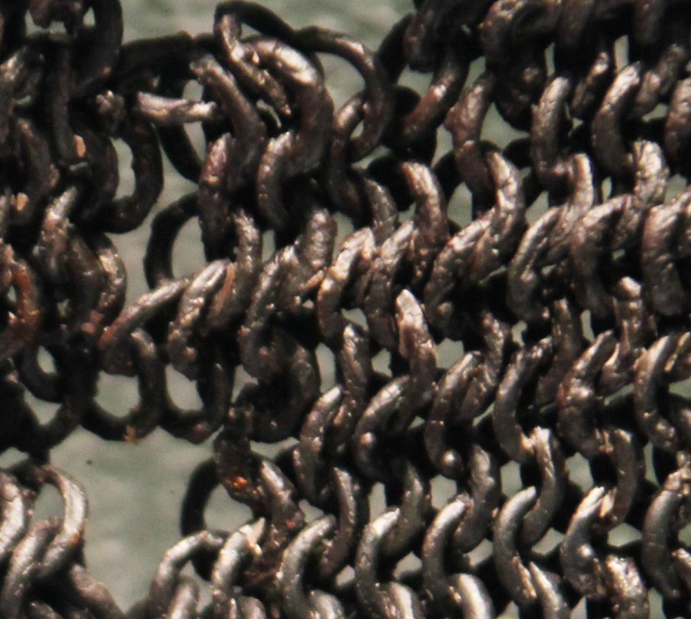

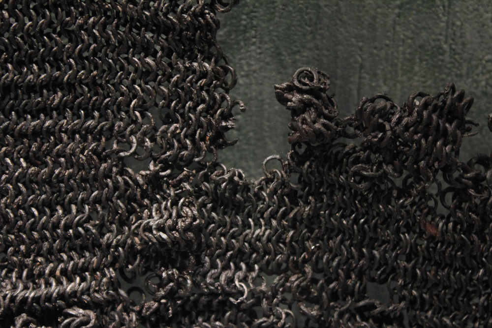

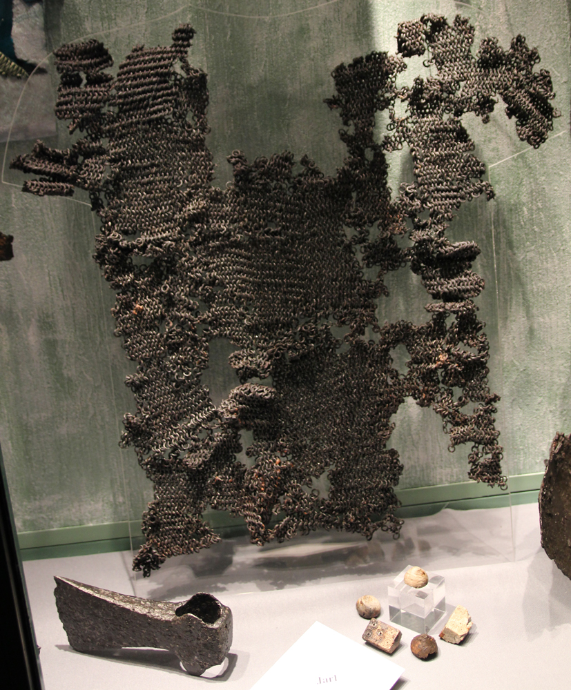

Paul, I can't see the galleries either so I would greatly appreciate if you could post pictures. Any and all would be of help.
If anyone has a picture of a the back side of a round riveted museum piece from 13th-14th century that would be gold. What I'm really after is to know if the round riveted rings look the same on both sides (i.e. domed) or if there can be variations. The Gjermundbu mail just looks wedge-riveted even when ground down. I assume they used coned rivets, rivets with a nail head, or a dimpling rivet technique suggested by Mike Cervantes on Ironskin's webpage?

Paul Hansen wrote:
Vikverir used to have some good photo's of Viking age mail here: http://www.vikverir.no/ressurser/hist_mus_oslo_no_viking/
Here you go, hope it's helpful.
 Attachment: 824.67 KB
