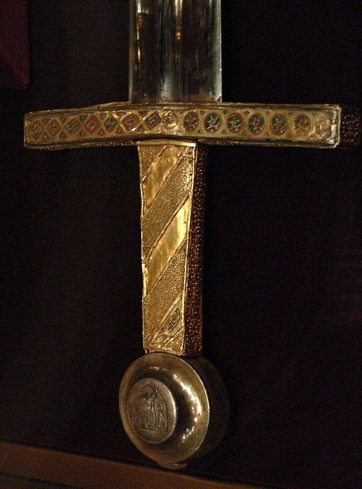

Hi all,
I recently ran across this beauty. I can't recall ever seeing decoration like this on a 11-12th century hilt. Does anyone know of any other examples of 11-12th century hilt decoration?
Thanks to Niels Provos for his pictures from the reichsstadtmuseum in rothenburg. For more go here: https://www.flickr.com/photos/nielsprovos/7574638152/in/album-72157630586189982/
 Attachment: 130.4 KB
Decorated 11-12th century hilt

PostPosted: Thu 16 Apr, 2020 11:11 am    Post subject:         Reply with quote
Dear Tyler,
Where is this located?
Best,
Mark Millman

PostPosted: Thu 16 Apr, 2020 11:29 am    Post subject:         Reply with quote
Mark Millman wrote:
Dear Tyler,
Best,
Mark Millman
Hi Mark,
It's in Rothenburg.

PostPosted: Thu 16 Apr, 2020 12:37 pm    Post subject:         Reply with quote
Well, the hilt of a Finnish sword from the same time period discussed in this old thread is entirely covered with silver inlays in a somewhat similar style.

PostPosted: Thu 16 Apr, 2020 1:11 pm    Post subject: Decorated Hilt.         Reply with quote
Rotenburg ob der Tauber. A German medieval town, in Southern Germany, which fortuitously managed to evade any damage during the war. I stayed there once overnight, the room had three foot thick walls and a thick down duvet. A bit out of the way, but well worth a detour if one is reasonably nearby.
Henry

PostPosted: Thu 16 Apr, 2020 1:22 pm    Post subject:         Reply with quote
I forgot about that blade. I have definitely seen it before but I guess I had Oakeshott type A or B pommels and type 1 guards in mind. This one, however, certainly fits within the time frame, so thank you for the reminder.

After looking at the pictures that Niels posted it has risen very high on my bucket list of destinations. Hopefully I can make it there sometime.

PostPosted: Thu 16 Apr, 2020 2:58 pm    Post subject:         Reply with quote
There are some very cool, unusually well preserved, and highly decorated swords in this museum. But I believe it has a reputation for dubious authenticity. Maybe some are Victorian era reproductions?

PostPosted: Thu 16 Apr, 2020 6:51 pm    Post subject:         Reply with quote
Nathan Robinson wrote:
Yes, many/most pieces in that collection are examples of historicism.
That's good to know. Do you happen to know if the sword in question is an original?

PostPosted: Fri 17 Apr, 2020 8:08 am    Post subject:         Reply with quote
Just a quick side note. I had another very close look at the pictures that Niels posted and I have a hard time picking out very many that I would categorize as suspect. To me they seem to show an appropriate condition for their age which is consistent on all parts of the piece. The blade forms and hilt shapes also appear to match. That being said, there are a few that I would say are somewhat off. I think these examples are perfect for another discussion topic that I had posted (Examples of Victorian Era Reproduction Swords, link below). If you are interested, have look though Niels's images and post what you think in the other topic. I am very interested to hear what others see in some of these examples.
http://myArmoury.com/talk/viewtopic.php?p=339511#339511

PostPosted: Fri 01 May, 2020 8:08 am    Post subject:         Reply with quote
I took some detailed photos and measurements of this sword. Some of the pictures are below, the link to the album is at the end. Sorry about the mix of units of measure, I had a very narrow window of time with a pile of weapons so had multiple measuring tools.
OAL: 40.25"
Blade: 33.5"
POB: 7" from guard
Guard width: 9"
Fuller length: 30"
Blade width at base: 6cm
Blade width half way: 5.5cm
Near tip: 2.74cm

PostPosted: Wed 06 May, 2020 8:23 pm    Post subject:         Reply with quote
Daniel FitzEdward wrote:
The first examples that leap to mind (especially when looking at the logical bounds of what 'the most decorative' looks like) are the swords of the Holy Roman Emperors. These were swords designed to be used in the coronation ceremony, and as with most other regalia represent the extreme upper threshold.
The sword of Otto III and Otto IV both date to the 12th century, and both are decorated- Otto III with a repeated geometric pattern (that switches, half-way across the guard) an the sword of Otto IV with a Latin inscription on one side of the blade, "REIGNAT : CHRISTVS : INPERAT"- (Christ triumphs, reigns, rules).
Daniel, Thank you for the great examples. While looking at your suggested coronation swords, I also came across this paper that discusses the polish coronation sword. It's has some great information on these polish blades.
http://archiv.ub.uni-heidelberg.de/artdok/342...c_2011.pdf
While interesting to study and certainly relevant to the topic, I'm keeping in mind that these are in a group of their own and not representative of what you would find on swords built for use and carry. I hope we can find more evidence/examples of decoration on swords made for use.
Michael, Thank you so much for the extra pictures. Really really enjoyed the closer look and details. This sword is very similar in many respects to the Albion Gaddhjalt. I had to get mine out and wave it around for a bit after looking at your pictures and dimensions. I believe we have established that some of the blades in the Rothenburg collection are embellished or fake, but you also mentioned that there is "quite a bit of real". Having handled these in person I wondered what your thoughts are on this particular blade. Would love to hear what you think regarding its authenticity.
