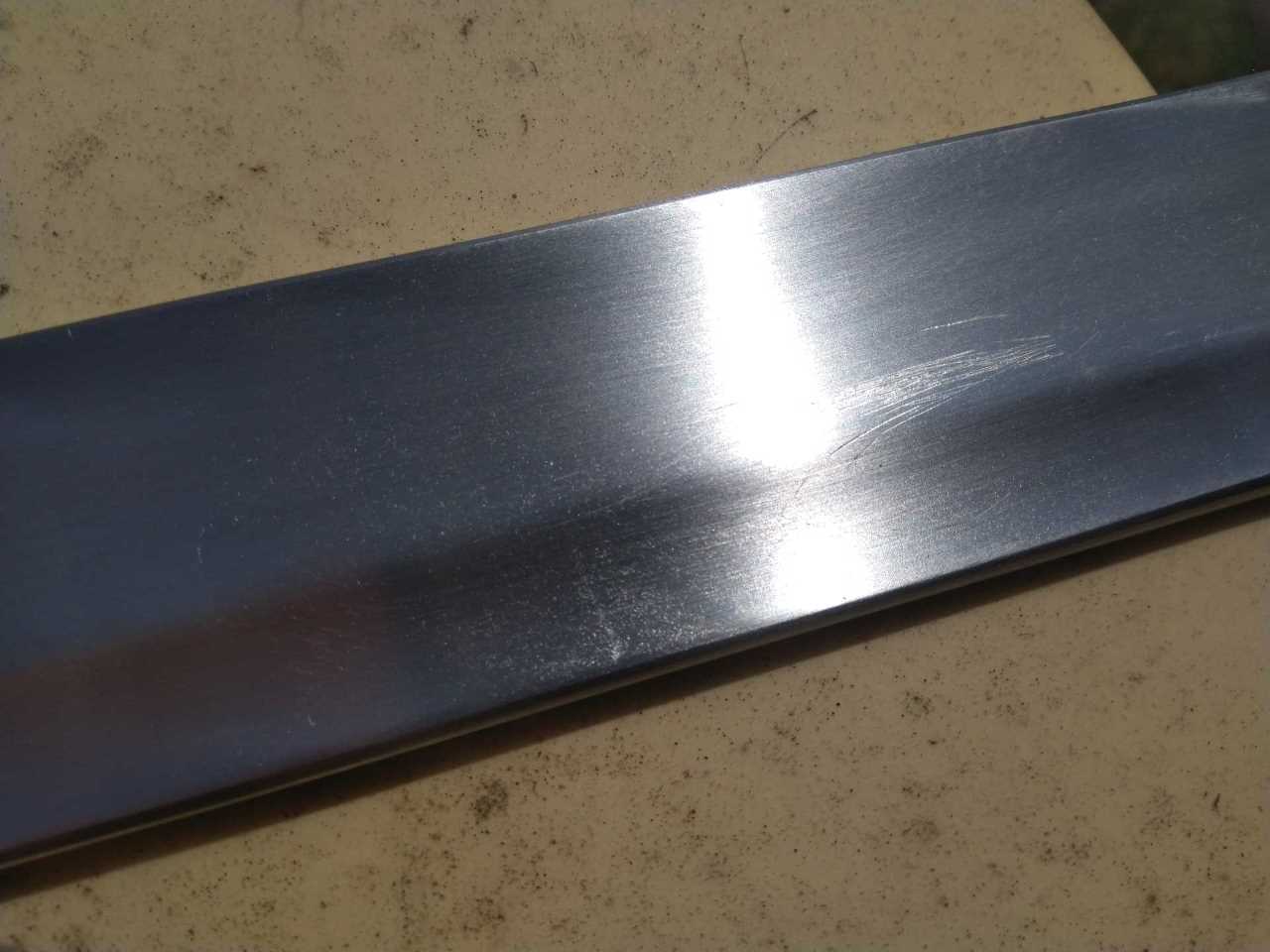

The grind of the blade is overall nicely even and smooth, the lines more symmetrical than on my Gottfried blunt. I love blades with a satin finish, and this one is overall pretty good. There are a few places where some grindmarks remain visible, but many of those will go away with use and cleaning, and they also don't look out of place from a historical perspective. It is a sparring tool, after all.
Unfortunately there is an unsightly step that does stand out right before the heavily reinforced point on either side of the blade. Adam agreed that he should have cleaned that up better.
In other aspects I have to praise the grind: The distal taper is spectacular. The massive thickness of the base material was a big selling point for me, as it's rather rare to see this historically relatively common feature in reproductions. As far as production pieces go, I‘ve only seen it in Albion‘s discontinued Knecht and Nielo Swords‘ Kriegsmesser offering (according to KultOfAthena‘s descriptions).

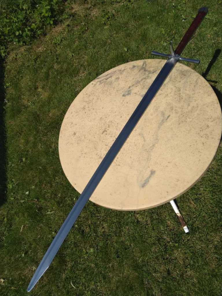

It is heavier than previous prototypes at 1650g, with the center of gravity a few centimeters closer to the hilt at 15cm. They've experimented with the flex as well. The first iteration was allegedly a bit too floppy, while the second one came out overly stiff. I think this one is perfect. It's still on the stiffer side, but I prefer it that way, and it's not for tournament use anyway. It's stiffer than both my sharp and blunt Swordmaker Marienburg Longswords, which are on the more flexible end for „real“ swords.
With 24cm of handle and 94cm of blade, it is not an easy blade to wield. It's also not exactly light, with the balance further out than any of the other long swords I've handled, so it ends up feeling pretty choppy. Trying to force it instead of working with it will end up hurting your joints and tendons more readily than with a lighter, more nimble sword.

Some more measurements on my LKE KM:
Overall Length: 120cm
Blade Length: 94cm
Weight: 1650g
Center of Gravity: 15cm from the cross
Centers of Percussion:
Handle node: 1cm behind the guard
Blade node: 27cm from the point
perceived pivot point: 15cm from the point
Hilt length (usable): 24.5cm
Quillon block length: 1,5cm
Nagel Height: 6.8cm
Cross width: 19.8cm
Width of grip: 2.65cm ~ 3.35cm, linear increase towards pommel
Thickness of grip: 2.0cm ~ 2.6cm, linear increase towards pommel
Width of blade: 4.0cm at base, quickly tapering to 3.5cm, which it pretty much maintains until the clip.
There are only few flaws with the blade that I do mind: The aforementioned step near the point should have been cleaned up, and there is a set of deep scratches where, I assume, someone slipped with the grinder while flattening the Nagel‘s peen. Everything else about the blade is fine.

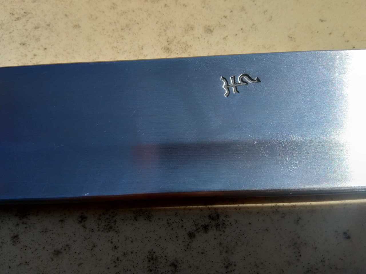

They‘ve also stamped it with their relatively new maker‘s mark. It sits about 1cm before the PoB and is slightly canted. I like it.

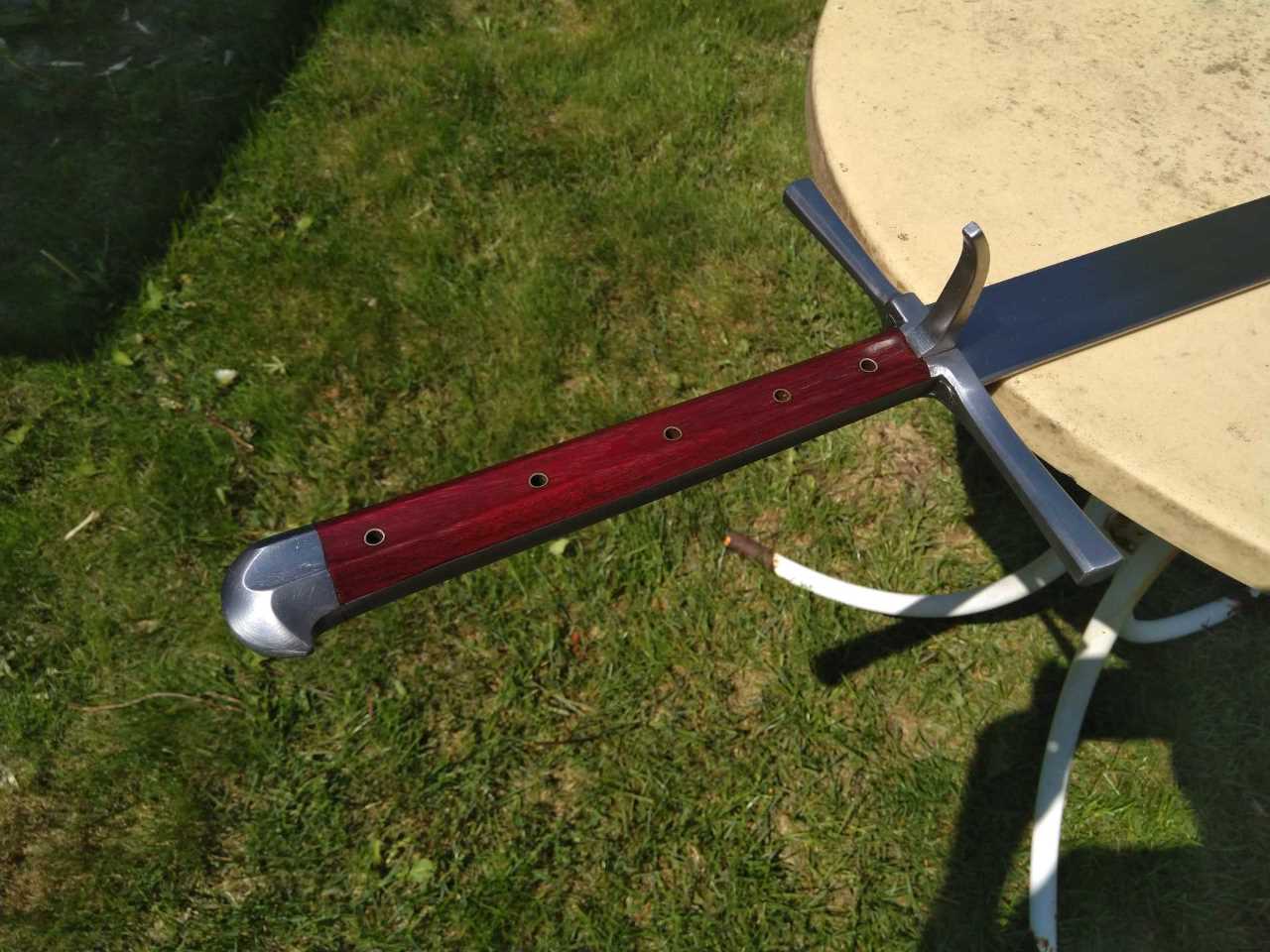

Moving on to the hilt. The handle scales are beautiful, the purpleheart really pops in the sunlight. In darker conditions it‘s more of a dark purple, which is still unique and beautiful. There was apparently a small crack or crease on one side, which has been patched. I‘d also like to point out that some of the brass from the tubular rivets got stuck in that patched area, giving it a small golden glitter. I like that accent.
The hollow brass rivets are pretty well finished. They‘re entirely flush with the wooden slabs, though one of them sits on the edge of aforementioned cracked section of the handle slabs.
They are extremely comfortable to grasp, and the transitions from wood to metal can barely be felt. I also like the added girth compared to the single-handed offerings.
Here‘s hoping that it holds up to the stresses of sparring, so far I've only had about 15 minutes of pure bouting time with it and can't make a final judgement.

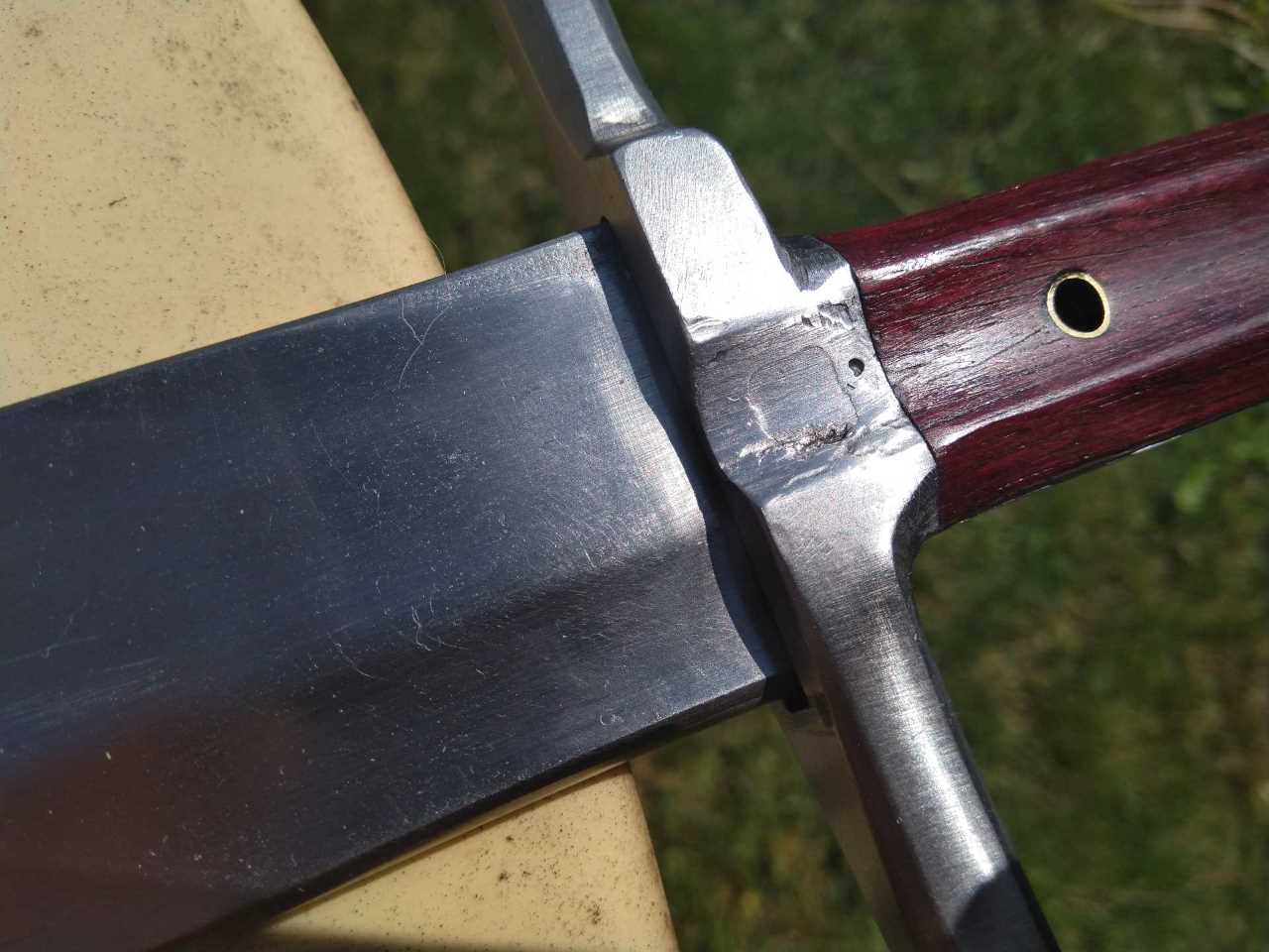

The crossguard is substantial, notably thicker than on the single-handed Gottfrieds. It has also been back-peened to the blade, which should make for substantially better durability rather than it loosening after its first evening of bouts. Very happy with this change, and it‘s executed fairly cleanly and well.
The pommel is a slightly larger CC1 style pommel with a beak. While the beak does give great retention, I‘ve had to tak a dremel to it and round off the point a bit more. Now it‘s very comfortable with gloves, and good without. A CC2 pommel might be a bit more comfortable, as the beak can still bite uncomfortably into the hand when grasping the hilt "wide".
Speaking of the pommel: it is peened on, and the peen is ground down and finished so cleanly, that I‘ve had a hard time seeing it initially. Full marks on that one. The pommel itself is not perfectly symmetrical, and its bottom edge isn‘t perfectly perpendicular to the tang/blade. That‘s absolutely fine with me, I could well see exactly this „feature“ on an original.

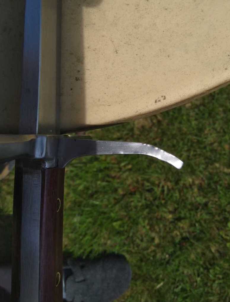

My biggest gripe with the hilt is the Nagel, sadly. It is somewhat thicker (if narrower) and taller than on their one-handed offerings, so it may be able to withstand the impact of longswords and similar weapons a bit more easily, but unfortunately its angle, curve as well as its peen are somewhat sloppy.
It doesn‘t come out at a straight 90° angle relative to the flat of the blade, but clearly favours towards the edge side. That I can live with and accept as paying homage to imperfections we‘d see in originals.
Bending it to the desired curvature, apparently the final step of messer creation, was quite obviously done in a hurry, with little regard for cleanup. As such, the bent portion is riddled with dents and compression marks. Additionally, it is not a continuous bend, but rather a visible series of kinks. This was markedly better executed on the flared Nagels of both the blunt as well as the sharp Gottfried that I have. It‘ll probably not be a visible issue anymore after all of two or three sparring evenings, when the Nagel has taken its fair share of hits. Still, I am rather disappointed with how this one turned out, considering the price and how well they can do it on their cheaper offerings.
The peen side is also a mixed bag. On the one hand the Nagel peen was ground flush, as opposed to my two Gottfried Messers, where the „rivet“ is slightly protuding. I don‘t mind the rivet, but the flush version is undeniably more comfortable to „thumb“. Unfortunately it was also cleaned up less diligently. There are even more unsightly creases, dents, and discernible angle grinder marks on the KM than on the Gottfrieds, despite this clearly being a part that shouldn‘t take significantly more effort to clean up on either type of Messer. Doesn‘t bother me as much as the sloppily bent Nagel, though. Perfectly fine for 300€, but not what you would expect at the given price.
I‘ve communicated my gripes to them, and they were rather accomodating, so we reached a mutually acceptable solution. Everyone makes mistakes, but it‘s important to own them and learn from the experience.

At least the sharp KMs in the past did not have their crossguard back-peened to the blade. While probably not historical for Messers, doing so prevents the crossguard from coming loose with little use, which would be very unfortunate in a sparring piece at that price. I had criticized that about my blunt Gottfried and specifically made a remark to this when placing the order for the KM, and I am very happy that they seem to have come through on that end.
