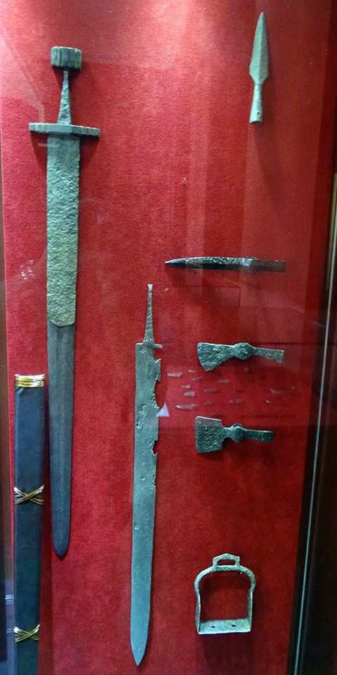

I've seen mentioned a few places swords showing influence from both Scandinavian and Byzantine tradition, assumed to be weapons of belonging to Varangian guardsmen. However, I have trouble finding good source material, especially good quality pictures. The best I've been able to dig up is from an Osprey book ("The Varangian Guard 988-1453"), which includes the scan below. It's a start, but I'm trying to find better quality pictures and, if possible, other materials about this and similar finds.
The end goal, of course, is to have one of these made.
Help?

"Drastar" was an important castle near the modern-day town of Silistra here in Bulgaria.
Your post brings me a couple of years ago, when this particular sword was in my field of strong interest, but the realities evolved in quite different direction and the project was abandoned in very early stage.
Do you want me to try to find some more info?
Just have in mind, any written text most probably would be in Bulgarian (you'll need a translation), good pictures could be a problem

If you could dig up something, that would be great! Even if in Bulgarian, at least I might find some pointers through translation.
Do you have any idea where the sword is located now? I'm sure it's in a museum somewhere, but haven't been able to find it. My next step is to try to find and contact professor Totev mentioned in the image description, but I thought I'd start here.

Well. Here are some samples:
http://sword-site.com/thread/1066/ornamented-...anufacture
http://sword-site.com/thread/766/viking-sword...cal-pommel
http://sword-site.com/thread/262/lenticular-v...provenance
And another from Bulgaria
 Attachment: 116.08 KB

After talks with some guys, including a short conversation with Boyan Totev, the real story of this sword was revealed.
In short - although NOT a fake, it is a result of wrong interpretation of the facts, made by the museum restoration workers.
The blade with the guard on it, plus handful of other iron/steel artifacts (including the triangular pommel) all of them found on a same place, have been bought by the museum from diggers*.
During the restoration process, the restoration workers put the pommel on the sword mainly because "it looks cool that way". All that has been done against the advice and will of Boyan Totev.
As a result - this is not a hybrid sword, but a wrong mixture of two different objects - blade+guard / pommel
