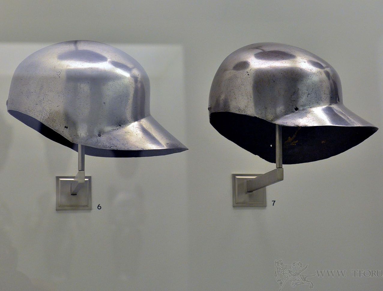

James Arlen Gillaspie
Location: upstate NY
Joined: 10 Nov 2005
Posts: 587
PostPosted: Wed 09 Oct, 2019 9:35 am    Post subject:         Reply with quote
Cortez had a motley bunch of merc's; there was even a woman among them who was NOT a camp-follower but a fighter, IIRC. Very exotic, that. For those who were actually from the Iberian peninsula, these helmets would have been very normal (minus the bling); these are on display in Toledo. They had a thing about bevors and gorgets, too, as though the Aztecs made a point of attacking the neck, IIRC.
 Attachment: 211.88 KB
 Attachment: 109.16 KB

William P
Location: Sydney, Australia
Joined: 11 Jul 2010
Posts: 1,525
PostPosted: Sun 13 Oct, 2019 11:56 pm    Post subject:         Reply with quote
so, essentially, most light early 16th century armours used in the iberian peninsula would do for an early conquestador.
meaning, any reasonable combination of jacks, brigandines, bresatplates, and any amount of mail armour would be just fine?
i am vaguely curious as well.
Dan Howard
Joined: 08 Dec 2004
Posts: 3,642
PostPosted: Mon 14 Oct, 2019 12:09 am    Post subject:         Reply with quote
Pretty much, yeah. Spain had just come out of the longest civil war in history (the Reconquista). The country was in ruins - its primary asset was a large army of impoverished, cynical, battle-hardened soldiers. The discovery of the New World came at just the right time for Spain’s rulers; many ex-soldiers, who might have turned to brigandage at home, instead sailed for the Americas to seek their fortune.
