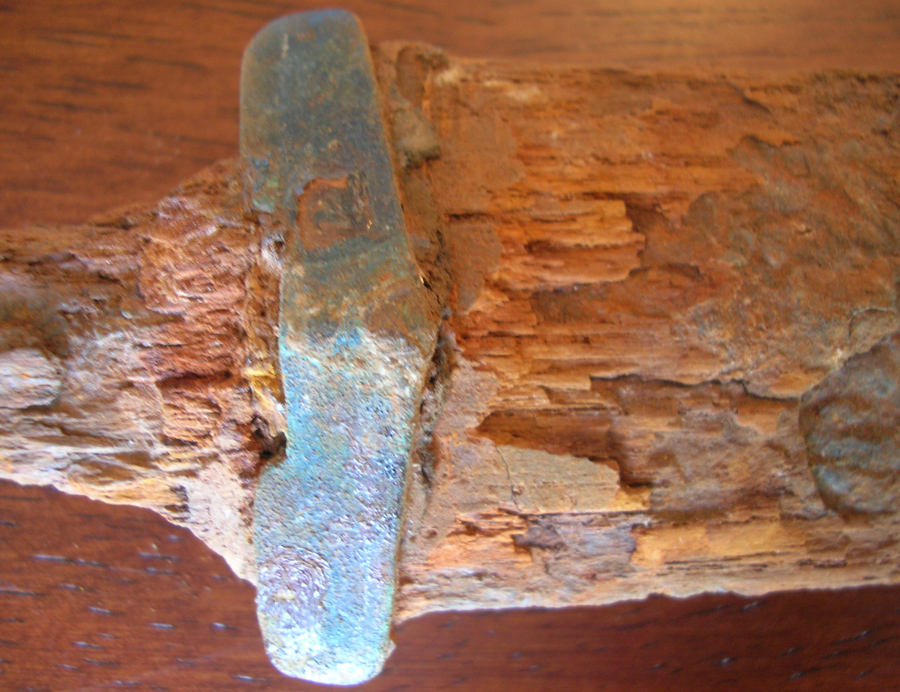

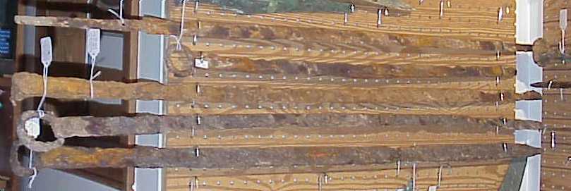

Attached are some pictures of Han dynasty stuff that I found in various places on the internet.
 Attachment: 48.04 KB
 Attachment: 68.21 KB
 Attachment: 62.62 KB
 Attachment: 10.83 KB
 Attachment: 397.38 KB
 Attachment: 149.68 KB
 Attachment: 32.67 KB
Thanks for sharing. If these are unsheathed swords, they're wider than the white arc is.

PostPosted: Sat 25 Jul, 2020 11:56 am    Post subject:         Reply with quote
Lancelot Chan wrote:
The top one, I think is unsheathed. It looks pretty narrow to me
The third one is with sheath, you can see the wood remains of the scabbard on the fifth picture.
Perhaps the White Arc is on the narrow end of the spectrum but Chinese swords are not sufficiently my area of expertise to say for sure...
