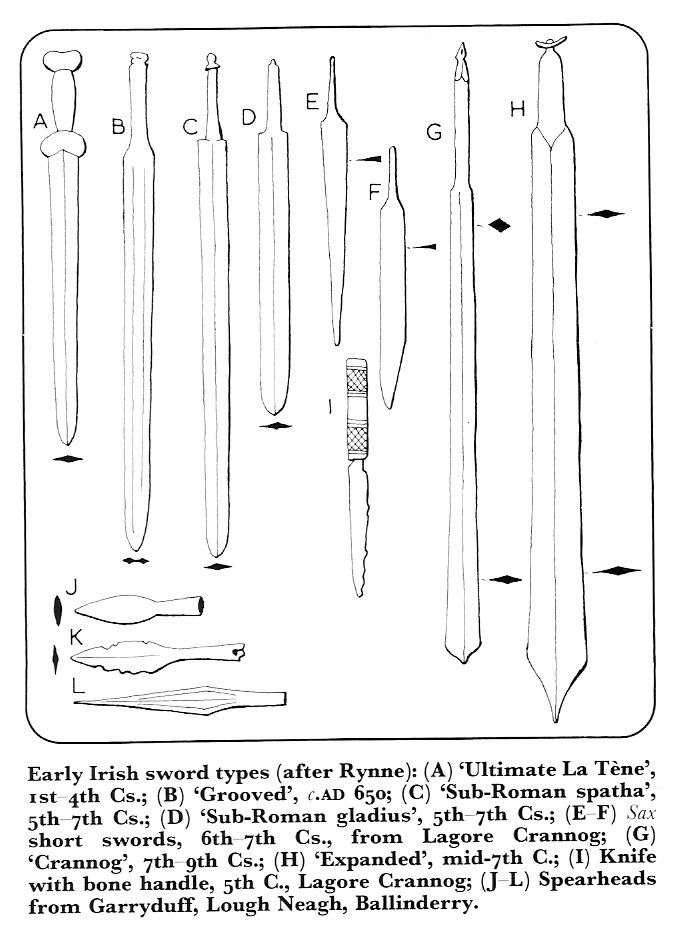

Found this on the internet. I don't know the original source, unfortunately. Maybe from the article already mentioned?
Attachment: 94.2 KB

Wow, Brian.....Can I ask where that page is from ? Mabye ' College of Cork's' - Documents of Ireland ? As my fellow Aussie Ally will find out...finding any info on Early Irish gear ( or ANY Irish gear for that matter) is like finding a proverbial Leprachaun !! I am especially amazed by the Swords no. G and H ....I've never seen any reference to swords like this before. And this is often the case.......I find that all thre interresting stuff on Irish gear is locked away in some obscure Journal and not in any book that I can curently find !
Merv
The page Brian posted is and isn't from the article I mentioned. I am almost certain what he posted is from The Osprey series, I want to say the Arthurian one. It is for the most part a copy from the article and the caption mentions "from Rynne." The "G" and "H" are the expanded end and crannog types from the seventh century. These should be in the National Museum of Ireland if I'm not mistaken, still looking for pictures.

Shane is probably right. It is probably from an Osprey book, as there is something familiar about either the artwork, the captioning, the design of the image, or all of above that reminds of me other images I've seen in Osprey books. I found it after googling the article author's name. Someone on a different forum had posted the image there without attributing it to a source. I had never seen the image before and also wondered often what a pre-Viking Irish sword might look like.
