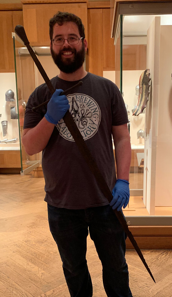

Michael Parker
Location: United States
Joined: 21 Sep 2011
Posts: 98
PostPosted: Wed 18 Sep, 2019 10:29 pm    Post subject:         Reply with quote
Here's what I've got on the Metropolitan sword. Assistant Conservator Sean Belair is the source of the photo where he's holding it.
 Attachment: 236.68 KB
 Attachment: 421.25 KB
 Attachment: 206.16 KB
