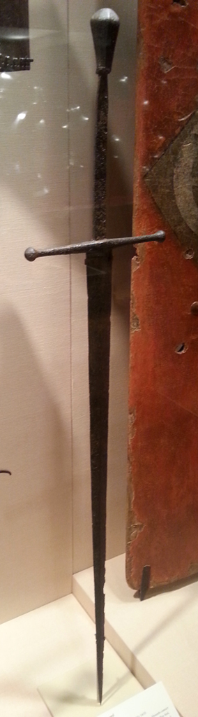

Michael Parker
Posted: Wed 18 Sep, 2019 10:29 pm Post subject: |
Here's what I've got on the Metropolitan sword. Assistant Conservator Sean Belair is the source of the photo where he's holding it.
Attachment: 236.68 KB
Attachment: 421.25 KB
Attachment: 206.16 KB
