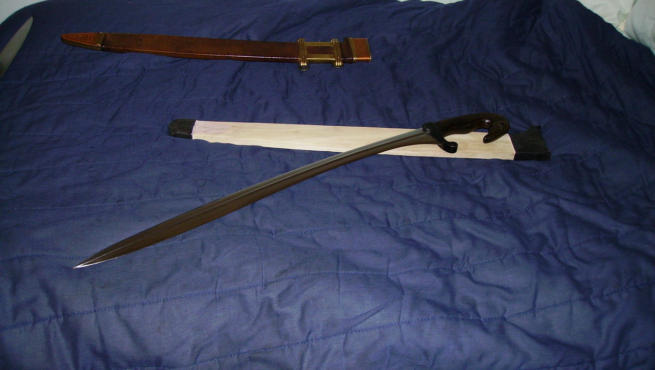

KRIS CUTLERY KOPIS

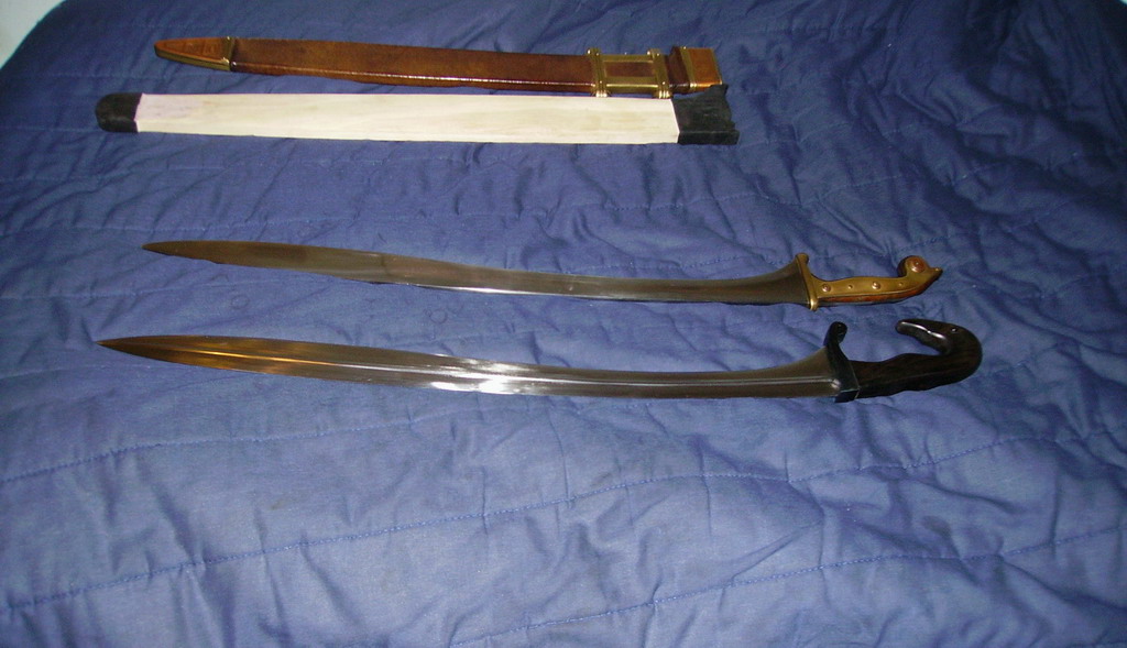

This sword seems to be based on a sword that is housed at the Corfu Archaeological Museum in Greece. That sword has a long and slender blade and a bird’s-head hilt. The blade has a medial ridge and a back edge. The hilt is not a direct copy, since the hilt on the KC sword is made of wood, whereas the hilt on the original is iron. The KC kopis handles very well, in my opinion; the balance is further out, as one might expect, but it doesn’t feel blade heavy, probably due in part to the weight (it’s less than 2 lbs). The blade is sharp (as one would expect from Kris Cutlery). The grip is pretty thick and a bit wide; I have medium-large hands and felt it was comfortable, but someone with much smaller hands may not appreciate it as much.
So, where does it fall in terms of historical accuracy? Let’s see:
Physical dimensions: I don’t have all the dimensions of the Corfu sword, but I do know that other earlier kopides had blades of 24 to 26 inches or so. The KC sword matches that, at least. It is heavier than the Corfu sword by more than a quarter pound.
Scabbard: It comes with a scabbard-ish thing. I call it a “Hellenistic Shirasaya”, as it serves the same purpose. As such, it is not quite ready to be called accurate, but it makes a great basis for something accurate. Really, all you would need to do is wrap it in leather, stitch the back, add a reasonable suspension system, and that’s it. Then it would be fine.
Hilt materials: There’s no brass or bronze, so that adds to the accuracy. The hilt on the original is iron (I am not sure how the iron hilt is fixed, if it’s riveted, soldered, or glued) and the KC hilt is wood (the guard is iron or steel), so it’s not an exacting copy of this specific sword, even if it looks right.
Full Profile Tang: Anyone? Bueller?
The truth is, I don’t know and can’t tell if there is a full tang here or not. The grip is wide and thick enough to conceal such a tang, and the presence of a through-and-through pin (the bird’s eye) gives me reason to believe that there might be a full, or mostly full tang. I have reached out to Kris Cutlery but have not yet received an answer. I can’t imagine that they did the kind of research they would have had to do on this sword and left out a major design feature, but I’ve heard of stranger things.
So, in the final analysis, it’s a mixed bag, historically speaking, but it’s still a better effort than most other makers in this price range. If it proves not to have a full tang, well, you still have a very nice sword that will perform as well as, if not better than, the original.

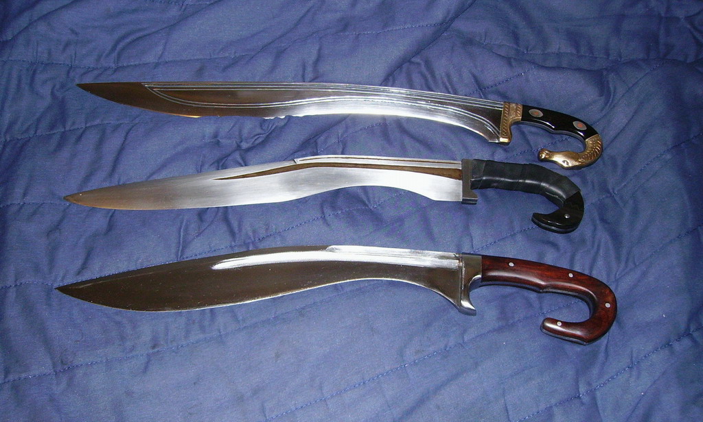

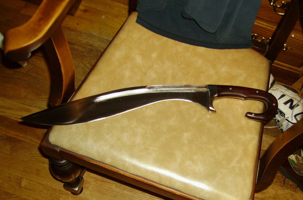

As mentioned, there are a few – very few -- fairly accurate kopides on the mass market. There are still no good falcata replicas on the mass market, period. Not a single sword marketed as a “falcata” is anywhere near accurate. Most makers (Windlass, Deepeeka, and a few others) base their falcatas on the Del Tin falcata, which was flawed from its inception. Windlass once made a decently accurate budget-level falcata with a wood horsehead hilt, but they quickly discontinued it (it was too accurate, I guess), but there’s been nothing since. Well, I just happened to stumble upon a maker of kukris (khukris, khukuris, spell it how you want) in Nepal who advertised a kopis. I took one look at the picture and said to myself, “huh, that’s not a kopis, it’s a falcata” (and yes, there are differences between the kopis and the falcata other than the fact that one is from Greece and the other from the Iberian peninsula, but I don’t want to bore you with an exploration of that right now). It was priced right, and only really lacked in one typical characteristic, that being a sharpened back or false edge. I put in my order and asked if the smith could add a false edge for me. He did so for no extra charge! So, when the package arrived all the way from Kathmandu, I was pretty excited. And what do you know, it’s a falcata! It’s capable of cuts and thrusts and does both well. It’s light and fast in my hands and is fun to wield. It is not based on any particular historical example, but it does have some characteristics of a couple originals. It does bear some similarity to the well-known falcata in the Metropolitan Museum of Art in New York, albeit shorter and a bit chubbier. In fact, the grip looks kind of like the cheesy replacement grip that was on the Met’s falcata (and since removed, from what I understand). It also bears some similarity to the Cerro Muriano falcata, which has a short and wide blade. So, how accurate is it?

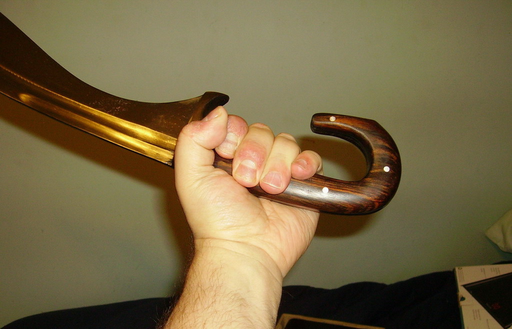

Physical characteristics: The blade is 16 inches, which seems to be in the range for most falcatas (the Met’s is 17 inches). Weight is nice (1 lb 14 oz), but about half a pound more than the Met’s. Original falcatas can have multiple fullers of varying length and depth; this sword has two fullers, one of which is longer than the other, echoing the original designs (but in a somewhat simpler way). The grip itself is HUGE. It’s comfortable (with nice rounded edges) and very roomy, but much, much larger than a historic original, so here’s one count against it. Take an inch-and-a-half off the grip and it would look (and probably handle) better.
Scabbard: Scabbard is nice, wood core wrapped with water buffalo hide. Historically correct? Probably not. Still, it’s a nice scabbard.
Hilt materials: No brass or bronze, which adds to the accuracy. Grips are wood panels riveted to the tang, which may or may not be totally accurate (at this price range, it’s probably fine).
Full profile tang: yep, got that.
To sum it all up, I think there’s more right here than wrong. Is it perfect? Of course not, but it’s decently accurate, considering the price range. I mentioned the huge grip to the maker, and he will change the grip design in future versions (the guy is responsive to positive criticism, which is always a good thing). Just remember if you want a falcata, ask the maker to add a sharpened back edge.
Neither sword is perfectly accurate, but both are better than most anything else in the price range. And, they're just plain good swords.
