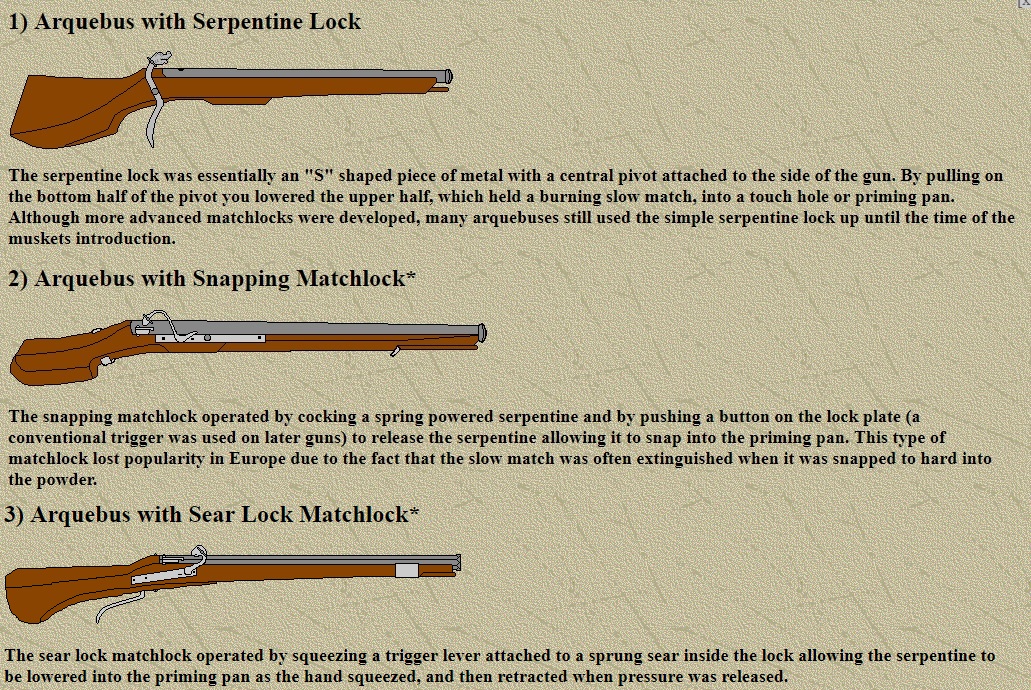

I don't know if this helps, but the following diagram comments a little more on the various forms of arquebus that existed. It comes from this website which no longer exists (save in archived form): https://www.oocities.org/yosemite/campground/8551/firearms.html
