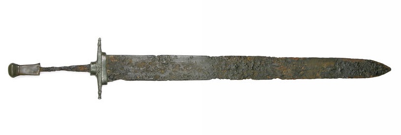

I’ll start this thread out with examples from Records of the Medieval Sword by Ewart Oakeshott, Beiträge zur morphologischen Entwicklung des Schwertes im Mittelalter by Dr. Alfred Geibig, and The Sword: Form and Thought by Peter Johnsson et al.
I want to emphasize: the comments below reflect likely modern perceptions of these swords. The purpose of this thread is to encourage people to recognize that these "flaws" were perfectly acceptable from a medieval perspective, and to encourage sword collectors and makers to explore faithfully recreating these eccentricities instead of trying to fix them or otherwise alter them.
1) Even before it suffered wear, I’m pretty sure this sword had a warped tang, as evidenced by this photo.
2) Notice from Geibig’s sketch that the pommel is asymmetrical, which can be seen from the shadow in the photo. The pommel is also canted to the left. I’m fairly sure the arms of the cross were never equally sized, even when the sword was first made.
3) This is a sword where the hilt portion appears somewhat out of proportion with the robustness of the blade.
4) Another asymmetrical pommel, and a second instance of a cross with arms of different thicknesses.
5) This cross would probably make most modern collectors want to scream—and I don’t think its size is just a matter of irregular wear and deterioration.
6) This sword, also found in Records, is a classic example of a sword whose pommel is tiny in proportion to the rest of the weapon.
7) The hilt of this sword seems entirely too small for the blade.
8) Yet another instance of mismatched hilt and blade proportions.
9) A pommel like this would almost certainly be viewed as entirely unacceptable by a modern customer, but it seems to be fine for the purpose of a fighting weapon actually used in the Middle Ages.
10) Another good example of a tiny pommel on a sword.
11) This sword is probably well known to fans of Records—it’s the sword with the exceedingly broad blade dated to the 12th century. What may not be so well known is its extraordinarily thin pommel, as seen here in The Sword: Form and Thought
12) This Type XII doesn’t have a fuller, already making it quite unusual for a sword of the High Middle Ages. The appearance of the cross is also not really aligned with most modern people’s expectation of how a sword should look. Yet this sword was found in a house after centuries, so it’s most likely genuine.
13) If you look closely, the pommel appears slightly canted to the left.
14) This Type XIII.a is one of my favourites, despite the rather peculiar cross and the asymmetric tang.
15) A number of antique Type XVI.a have small cross guards, including this well-known example from Borringholm, yet how many modern collectors would want a cross like this one?

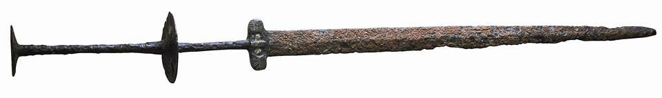

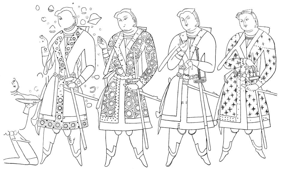

Hello. One of the oddities of early medival swords were "real zweihanders" they were accompanied with swords, which could be called today as half and handers. The longer ones possibly came from Chinese influenced area and the swords with elongated grips might have been modification for either hand protection or for double handed grip. There are more examples of pictorial and even material evidenceof theese pieces but i have reached my 1mb limit.
Btw. Chinese used such swords from bronze age onwards.
Attachment: 39.17 KB
Afrodisiada sword from 8th century Along with others from central asia.
Attachment: 12.03 KB
Sassanid disc pommel sword from 4th century. [ Download ]
Attachment: 104.15 KB
Sogdian half and handers in mural painting from 7-8ct. [ Download ]
Attachment: 60.86 KB
Bulgarian examples from 10-11. century with elongated grips [ Download ]
Attachment: 25.07 KB
Sword from auction with elongated handle. 10-11 century. [ Download ]
