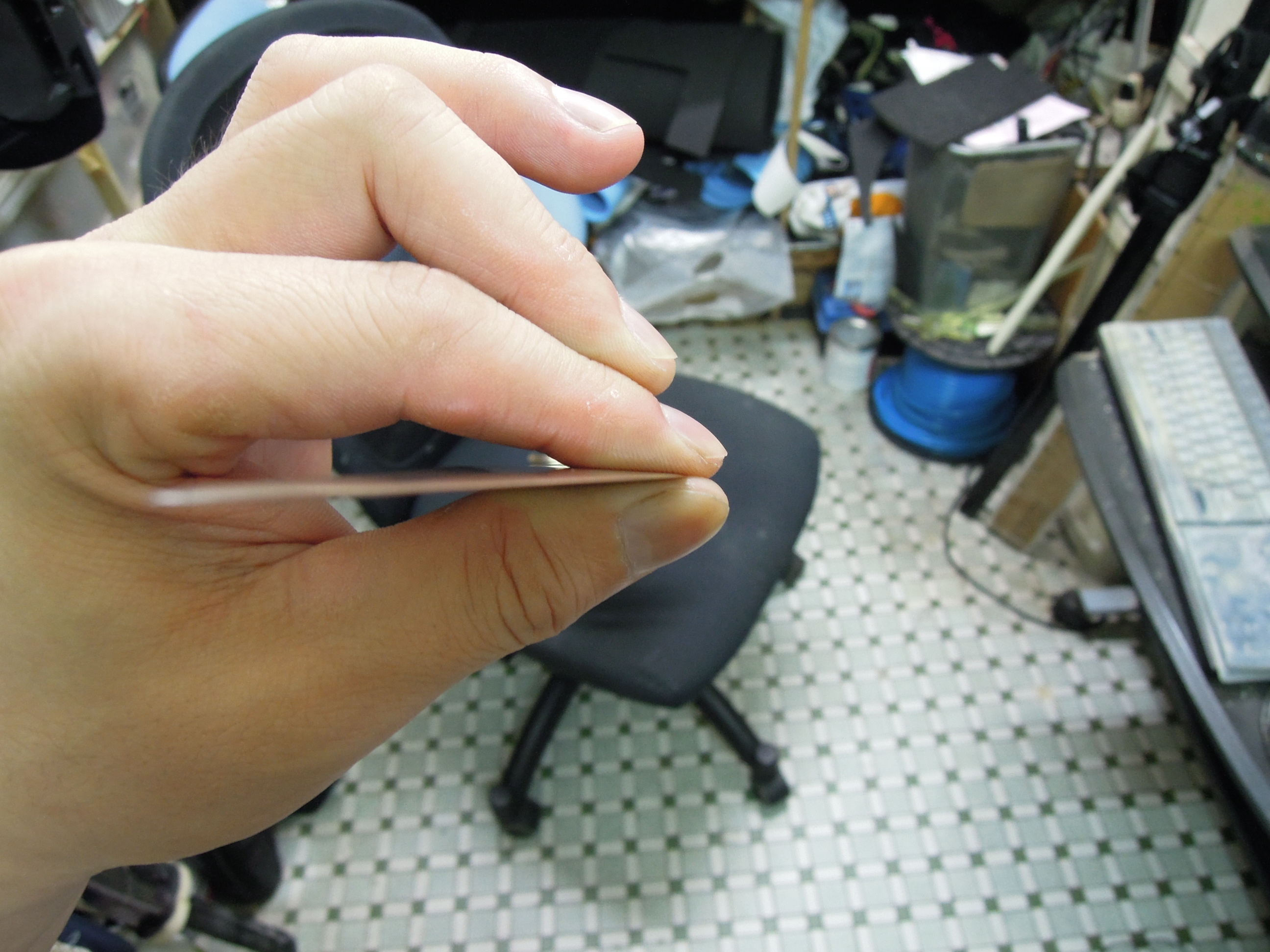

I think the sword can benefit from better steel and heat treatment. I've used sword with even thinner cross section from Longship Armoury and still hold up against the same type of target. That's my No Remorse's edge cross section in the photo.

The dao has a single bevel and a very small micro bevel that I gave it to form the apex. I haven't checked the RC for the blade.
It will withstand cutting wet newspapers alone but that means the sword can't meat any living bones. The damage the edge has suffered will take a while to fix but I'm leaving it on for the owner to inspect for the moment. It has a thick spine, thicker than a katana's spine, and forward balanced, thus not really that lightweight. It's really a chopper.

I checked the HRC of the edge and it's below 40 HRC.

You're right about any kind of contact will dull the edge. Going in and out of the sheath certainly will do it. Remember it's a wooden sheath! I did a 9 micron finish at 35 to 40 degree per side on the apex, so it formed the edge alright. Just that it won't hold against hard targets. I'm sure newspapers alone will be fine though, just dulling the edge but won't be rolling or chipping.
