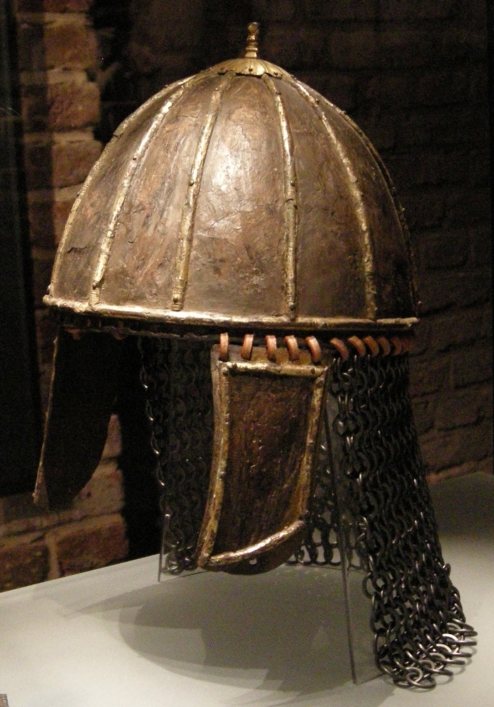

I *think* it's a little bit of a mash-up. There is a well-known Carolingian helmet with a brass frame and the panels mostly gone, though they may be iron (rusted away), I can't remember and don't have time to dig through my books! But I think the appearance of this helmet is taken from the archers on Trajan's Column, which shows segmented conical helmets with small cheekpieces and neckguards of mail or scale. It's not *too* bad for that, I suppose, though there are better options out there.
Agreed that horn is a perfectly good option, material-wise. I'd just want to see more information for the rest of the helmet.

The original helmet I was thinking of was found in a *royal* tomb under Cologne cathedral, and was sized to fit the 6-year-old boy buried there. The panels are horn, and are apparently wired together, while the bronze bands cover the seams. So there's nothing inherently wrong with the small rivets.

Here is a photo of the Koln helmet.
 Attachment: 356.48 KB
jamesarlen.com
