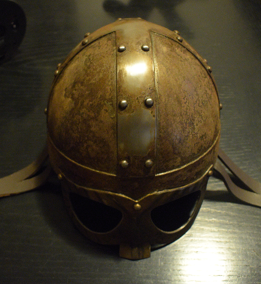

Hi i wonder if how picky they are with rusty equipment?
I did the citrus and salt it was high carbon and whent fast rusty?
It just surface!
I like rusty look more than shiny silver!
Do they pass rusty equipment?

If I understand what you're asking... then, pretty rusty.
In some periods a "russet" finish was used on armor and, I think, some sword hilt furniture.
It's basically a technique where the the metal is allowed to develop a thin, even patina of rust, and then the rusting process is arrested. The rest is an even oxidized layer that offers some protection against further rusting. I'm not an expert in the technique, but I've seen it done.

A russet/oil finish was a late 16th century to 17th century manner of finishing munitions armor, where linseed oil was spread over the piece of armor and then it was subjected to enough heat to give it a mottled brownish finish but not ruin the the temper of the piece.
even stabilized brown rust is still slowly eating away at the metal and if you were an aglocentric definition of a knight or professional man at arms you'd have someone to keep your armor in good standing.

Oh thanks all for reply didn't dare to have rusty equintment. I sanded it of it get to fast rusty!
Dont want to risk it realy Eek!
It going to fast down.

Regular polishing and oiling stops rust from forming, and smooth polished surfaces are slower to rust, to begin with. Or you can plate the steel with silver or gold, or paint it. Or just stow your armor safely, wrapped in oiled or waxed cloth, instead of wearing it while sailing. Happy
