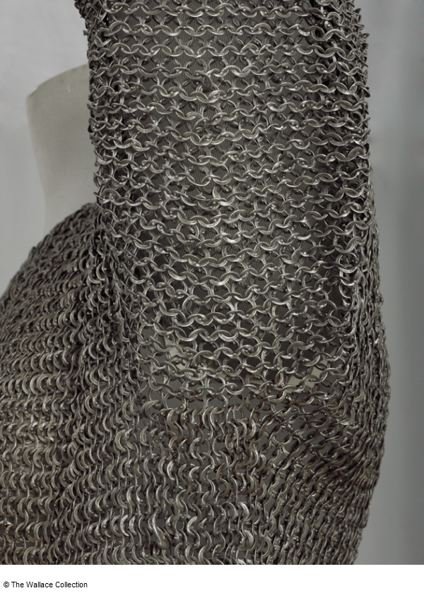

I'm closing in on the point where I need to decide about sleeve attachment on my hauberk. I've seen contemporary hauberks where the sleeve grain (4 in 1) is attached at a right angle to the body of the mail. I've also seen other sources where the grain of the mail body continues down the sleeve. I know its better from a defensive standpoint for the grain to hang together loose and close, rather than open and taut. For the latter reason I was considering attaching the sleeves at 90 degrees to the body. I've also seen what are touted as historically accurate reproductions with a continuous grain of mail from the body to the sleeve.

The norm for extant European mail shirts is to continue the roes of the body down the length of the sleeves, while joining the rows beneath the arm pit at a 90 degree angle.
Attachment: 317.44 KB
Wallace Collection A1, left arm pit [ Download ]
