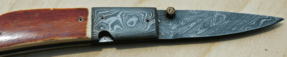

My latest knife made for me by a local maker from my own material...attached.
Attachment: 78.07 KB
