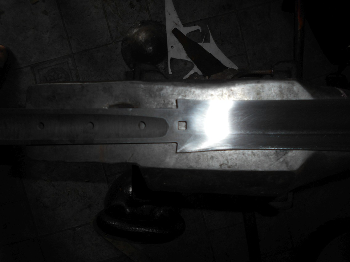

Also, thought I'd share this detail here instead of just telling Phil in private. We assemble most of our Messer models with sliding the cross down from the tip as it's a detail seen on several originals. We like it quite a bit, though it's by no means the only way. As the blade in question widens a bit towards the tip, the very base of the blade has to swell out a bit. The edge bevel curves up to the point of the base, making it the widest and thickest part of the blade, helping to lock the cross in place rather well. Normally, we'd peen the protruding points a bit to lock even more firmly, though a tight tolerance would make it somewhat redundant. This then can be filed or ground flush, or just smoothed down a bit. The shoulder area can be easily reground to accept the cross slid up along the tang, if necessary.
Also we're using square holes for the Nagels, which are 6*6mm (corners obviously radiused). Ideally, the shaft of the Nagel and the holes in the cross itself should conform to this, but it works well with a 6mm round stock too.
I've attached a snapshot of the shoulders, sorry about the quality.

Thanks for the construction details Adam. I love messers and always love to see new ones. Can you tell (or show) me what your distal taper is like?
I looked through some of your older facebook posts and found a very interesting prototype kriegsmesser you made. At the time you were considering adding it to the catalog but said you were going to wait for thicker stock to work from. I'm glad you did this because several of the messers I've bought from other makers have been either too thin at the shoulder or uniform width the entire length of the blade.

Ian: on the M3C Gottfried models, starting thickness is 5mm, getting down to about 3mm at the beginning of the false edge, measured on the spine. It's rather straightforward, maybe even oversimplified a bit. The fuller and the edge is more complex, and I'm not quite sure if I can describe it correctly. We are still grinding freehanded from waterjet-cut blanks in most cases, and grinding ends when the blade feels good in the hand. Not really the most exact method for sure, but we haven't got any complaints considering handling on Messers so far (or I just missed that message, like I did several).
