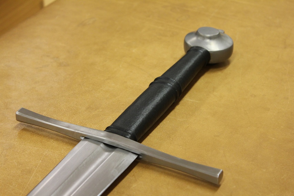

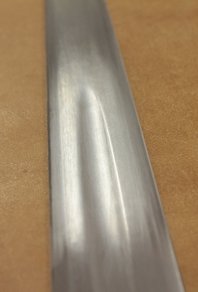

I have more pictures and videos, as requested.

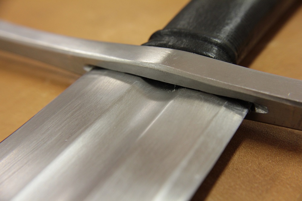

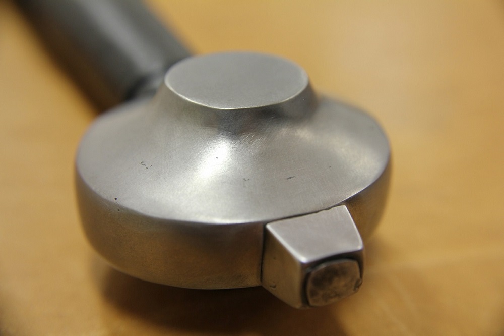

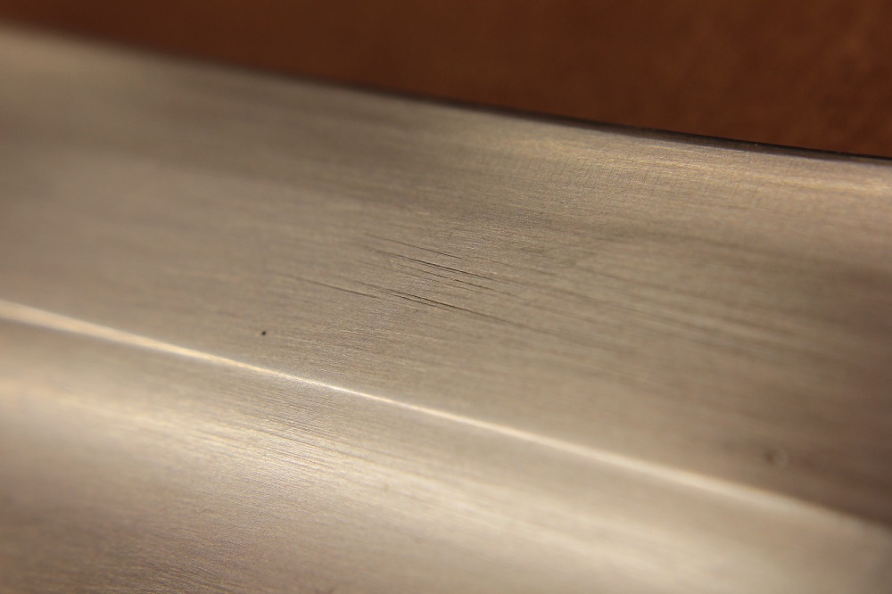

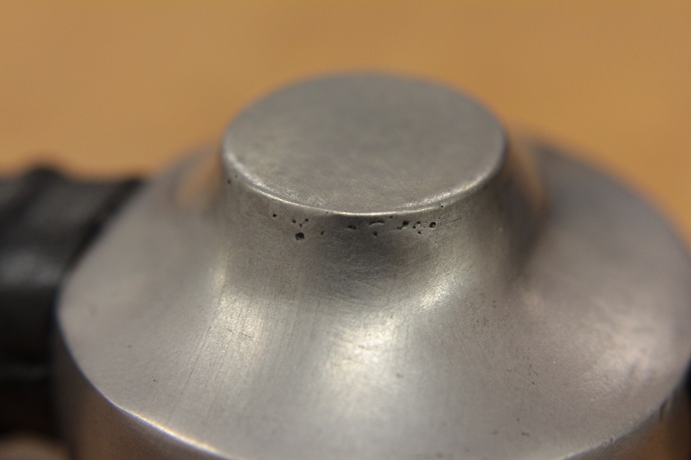

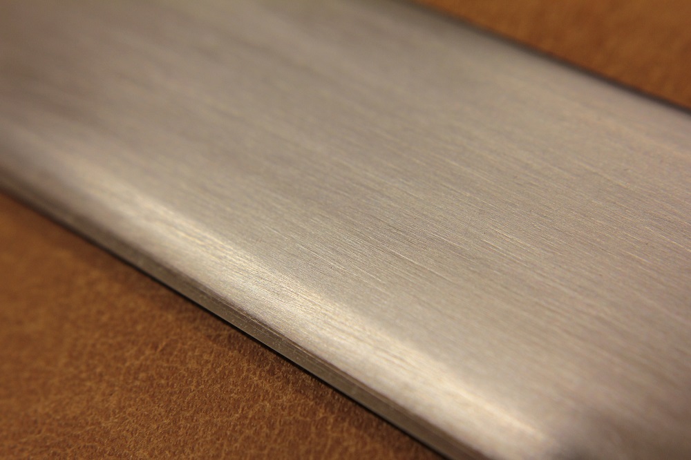

Various perspectives of the sword itself.

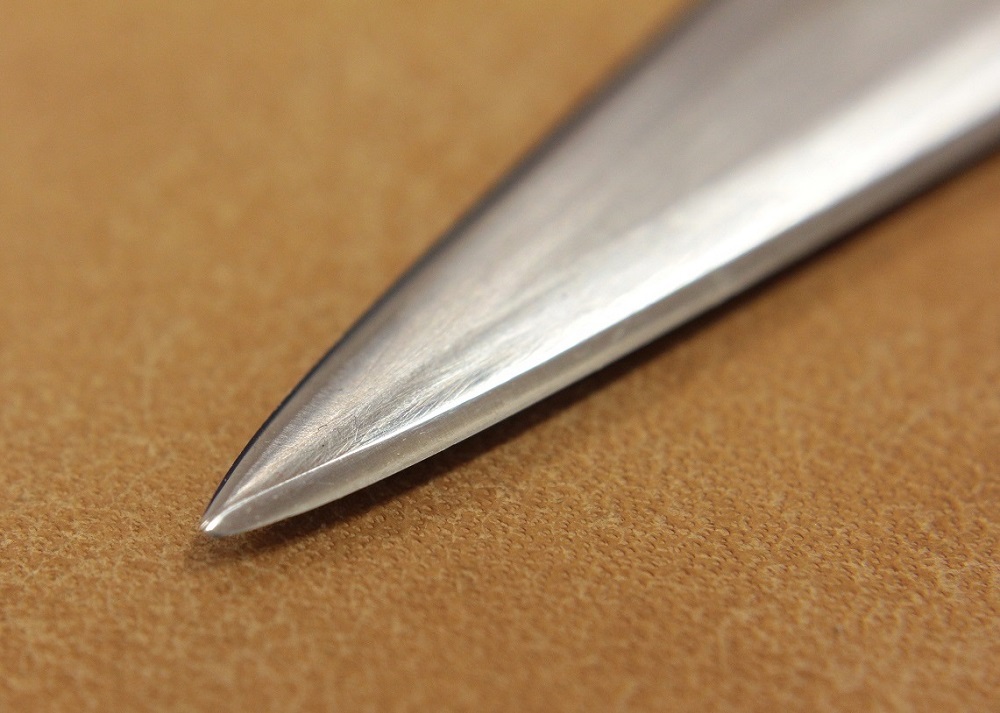

 Attachment: 109.23 KB

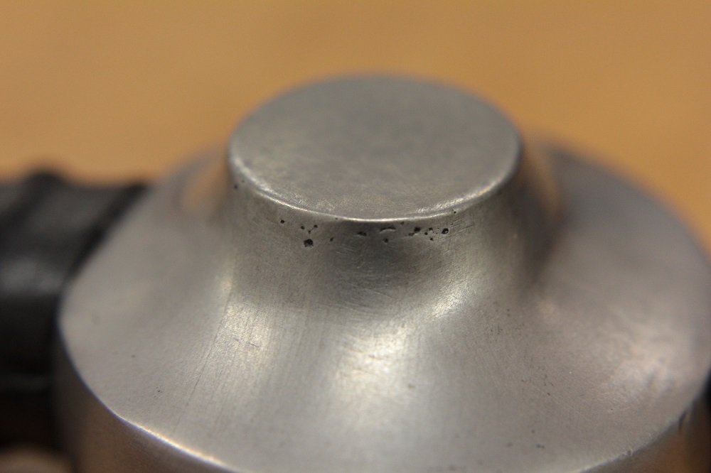

Pommel & Peen [ Download ]
 Attachment: 123.73 KB
Marks on Pommel [ Download ]
 Attachment: 145.01 KB

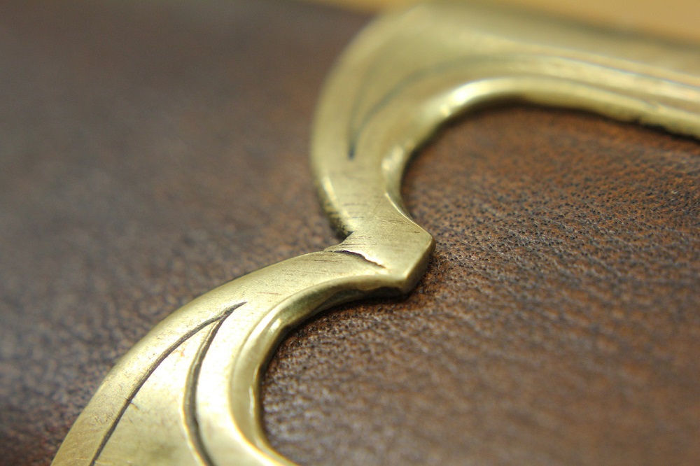

Grip and Cross [ Download ]
 Attachment: 142.63 KB
Blade and Cross [ Download ]
 Attachment: 172.78 KB
Hilt [ Download ]
 Attachment: 115.8 KB

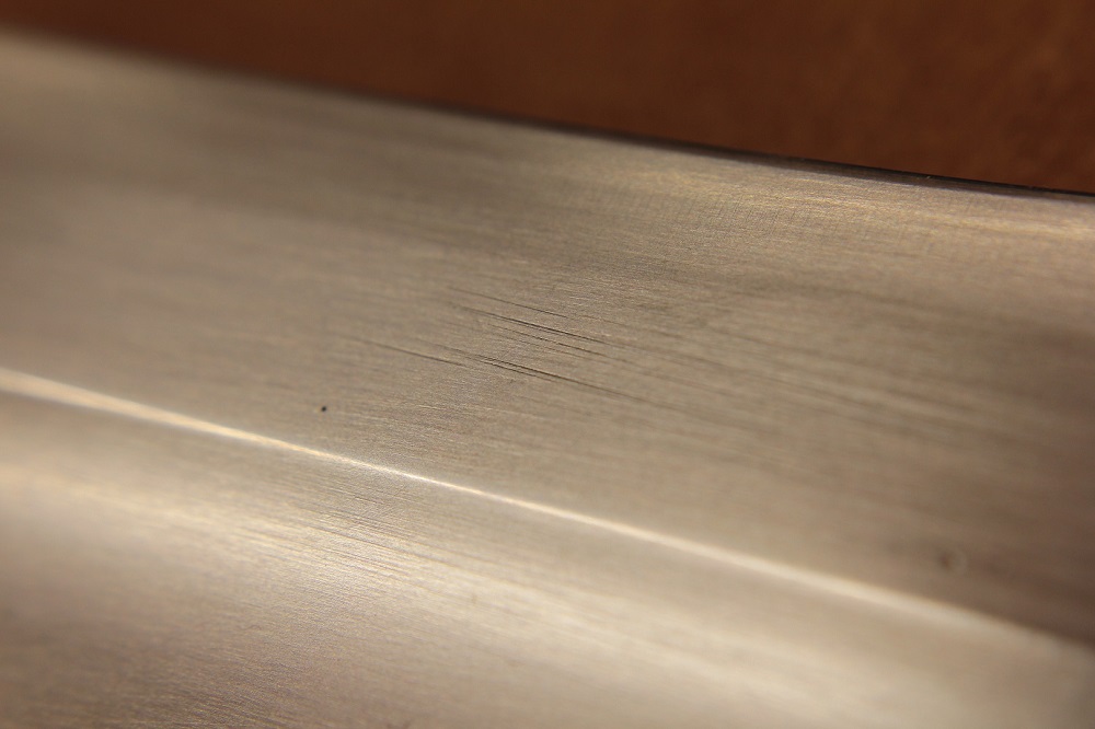

Marks on Blade [ Download ]
 Attachment: 125.1 KB
More Marks on Blade [ Download ]
 Attachment: 149.28 KB

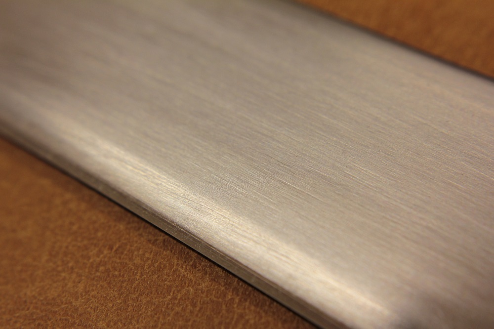

Polish change at the edge [ Download ]
 Attachment: 142.68 KB
Fuller slightly wandering to the left [ Download ]
 Attachment: 180.67 KB
point [ Download ]

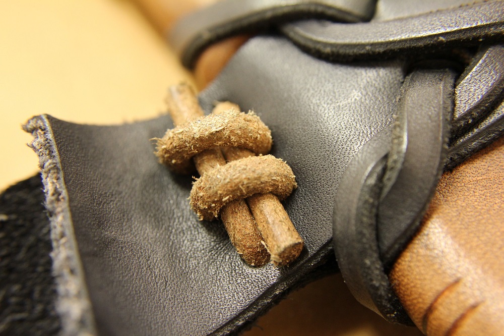

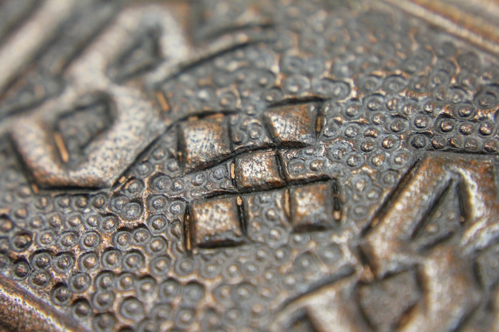

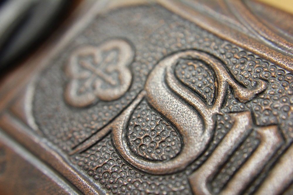

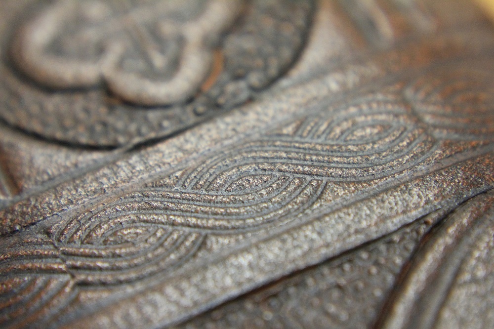

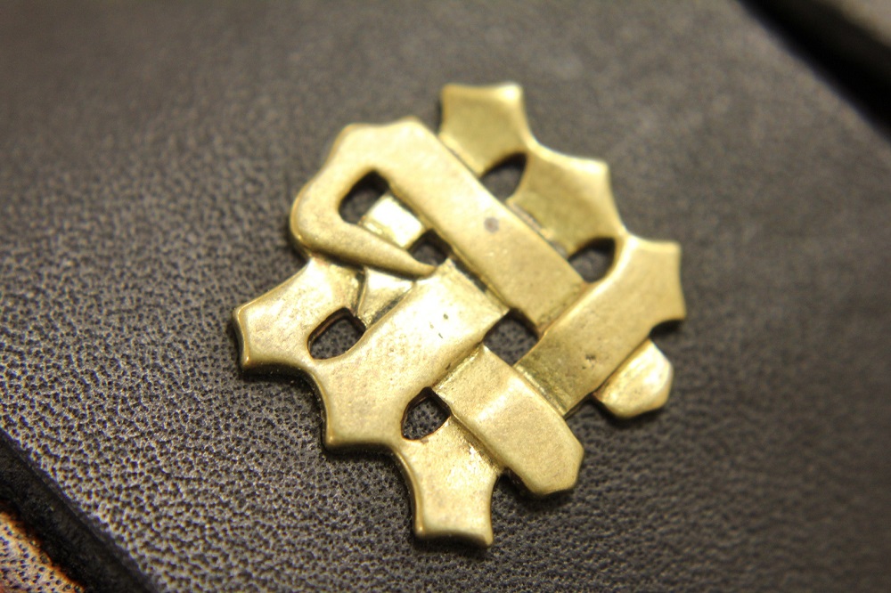

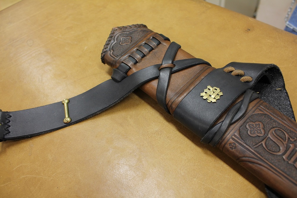

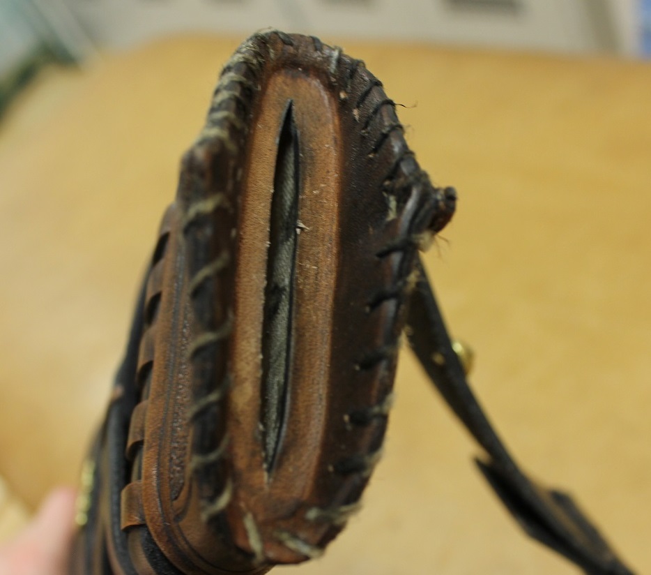

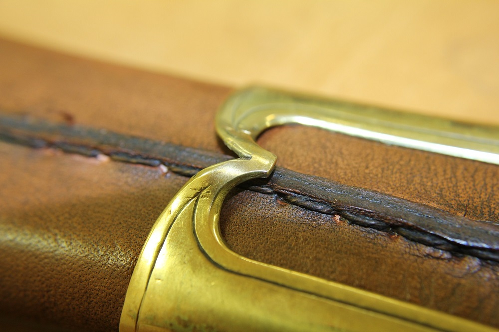

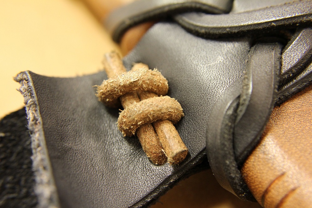

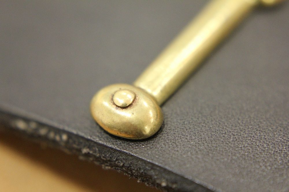

Pictures of the scabbard and belting
 Attachment: 226.22 KB
belting [ Download ]
 Attachment: 136.21 KB
mouth [ Download ]

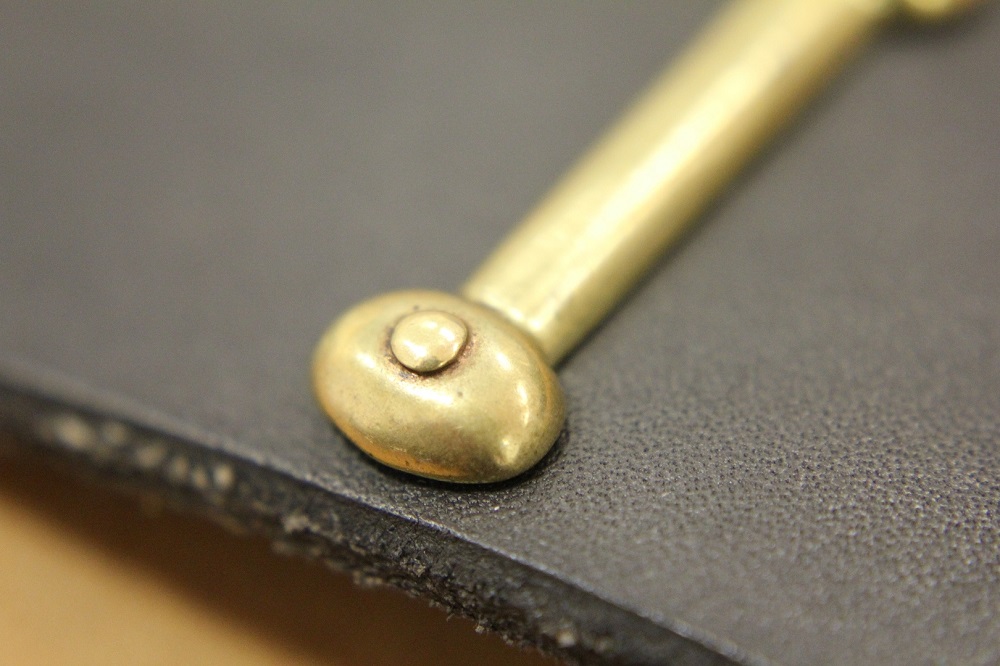

 Attachment: 231.89 KB
decorative pin [ Download ]
 Attachment: 175.02 KB
reinforcing "bone" on belt [ Download ]
 Attachment: 168.71 KB
tool/casting marks on chape [ Download ]
 Attachment: 173.72 KB
toolmarks on back of chape [ Download ]
 Attachment: 252.26 KB
knotwork [ Download ]
 Attachment: 241.89 KB
embossing detail near chape [ Download ]
 Attachment: 261.34 KB
embossing detail in the middle [ Download ]
 Attachment: 219.54 KB
embossing detail top [ Download ]
