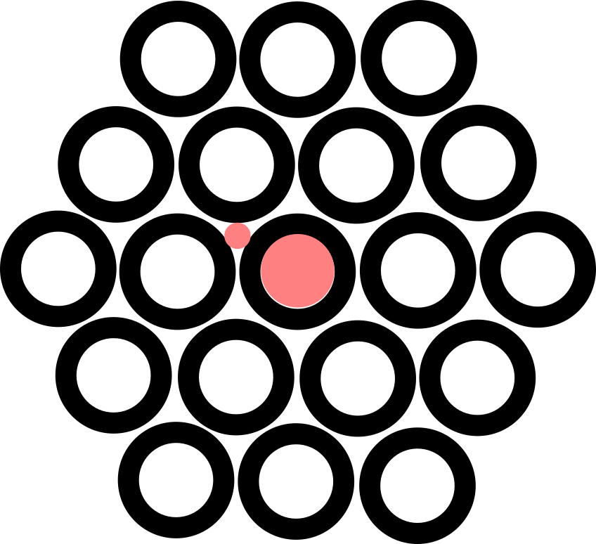

Andrew Gill
Joined: 19 Feb 2015
Posts: 150
PostPosted: Thu 05 Oct, 2017 2:48 am    Post subject:         Reply with quote
I'm no expert on eyelet armour, but here are a few thoughts and observations:
1.Eyelet armour has fewer metal rings (by a factor of nearly 2) than a similar piece of mail armour because the rings don't overlap so it will be lighter and possibly more flexible (depending on how thick and tightly bound the eyes are).
2.It will also use less metal, which may have been less expensive by the late renaissance than in the high middle ages, but this could still have been a factor.
3.The labour in stitching the eyes may have been significant, but I suspect that the cost of sewing labour was considerably less and more ubiquitous than metal workers capable of producing mail, so you could have more people making them, more cheaply.
4.The rings can all be made either by punching from a from a flat sheet, or possibly by winding around a mandrel. If the latter, I suspect they can be butted rather than riveted with far less loss of effectiveness than mail would experience. A ring opening doesn't compromise all the rings around it, or even its own attachment to the garment. So the actual metalwork required is simpler.
5.The tailoring is probably a lot less tricky, as you have a foundation garment to build on. The foundation is probably distorted or shrunk slightly in making the eyes, but this will be relatively uniform and by a constant factor across the entire garment, for a given ring size and fabric.
6.The rings are so close together in the extant examples that the gaps between the rings are actually smaller than the hole in the centre of the rings. See the relative sizes of the pink circles in the attached picture.
So the relative chance of a piercing weapon passing between the rings is actually rather small (if there is even a serious risk of armour failure associated with this). Also, remember that the people wearing the doublet aren't going to be standing still while you try to poke them with something sharp - the armour just has to stop or deflect the odd blow that isn't avoided or deflected with a weapon or shield.
7. Cutting at the armour will be much less effective than thrusting, because you have to cut all the many threads binding a ring in before you can remove a single metal ring. The blade may at best cut one or two per ring, and possibly less, considering that the whole garment is flexible.
So although it looks like a goofy idea at first, there were probably some good reasons for using it.
Edit: I may be wrong about the lower weight (point 1): I assumed that the rings were of similar size and mass to those used in mail, but they may be heavier.
 Attachment: 83.13 KB
Matthew Amt
Location: Laurel, MD, USA
Joined: 17 Sep 2003
Posts: 1,464
PostPosted: Thu 05 Oct, 2017 5:43 am    Post subject:         Reply with quote
Lighter, yes, but certainly not more flexible. These rings are not floating free as they do in mail.
Why get hung up on the cost? Metal certainly wasn't a significant factor by this time, but I strongly suspect that this kind of doublet was meant more for non-battle wear, best for strolling the town or going to parties. It was great against rapiers and daggers if you got into a duel, but I just don't see it being the armor of choice in war.
And this really doesn't look like something "cheap" cranked out for grunts, there was plenty of munition plate for those guys. This strikes me as something worn by gentlemen, or at least aspiring gentlemen, with enough coin to spend on something protective but still stylish. Being armored without being overt about it.
The folks who made things like this were extremely experienced. Any problems we might perceive were probably just business as usual for them.
Agreed with that last bit! But all of the threads on these doublets can be cut with any slash or prod. I can even see a point going between rings and just sheering open a line to slide through. But that's just me!
If it weren't for those (pretty unambiguous) historical references to eyelet doublets, I'd be inclined to think of them as almost amusement pieces, like those dinner forks with guns built into the handles. Cute but not serious. As Dan says, why argue with fashion?
Matthew
PS: Philip, thank you for the photos!
Philip Renne
Location: New Jersey
Joined: 11 Jan 2010
Posts: 38
PostPosted: Sat 07 Oct, 2017 12:44 pm    Post subject:         Reply with quote
Good points, I wanted to address these two specifically
3. Yes, you could recruit any grandmother, washerwoman or girl to put some of this together like a sweater, which would bring costs down.
6. My preliminary experimentation suggests this is the case, that the "gaps" are almost as well defended as the rings themselves.
I began a small patch of sample material from stuff I had lying around, in this case a single ply of cotton fabric as a matrix, artificial "sinew" the leather crafting stores sell, and a handful of 5mm 16 ga butted stainless steel rings. Obviously not historically accurate but a good enough approximation for what I wanted to find out. I sewed the rings very closely together so their was very little flexibility in the fabric but enough to work as a torso defense.
I jabbed the rings as randomly as I could and ended up landing in the intervals about 2 out of 10 to 3 out of 10 times after 3 or 4 trials. I then set the tip of a very sharp and pointy knife at the gaps and thrust one handed with decent force and did not penetrate the armor more than about a millimeter. After this I grabbed the knife with one hand and set the other other on the butt of the weapon and drove downward with my weight which did inflict a much better penetration, cutting a lot of the cordage but still nothing to threaten one's life.
I'm becoming more impressed with this armor form at least for lighter applications and would like to see how well it holds up when constructed from period materials.
