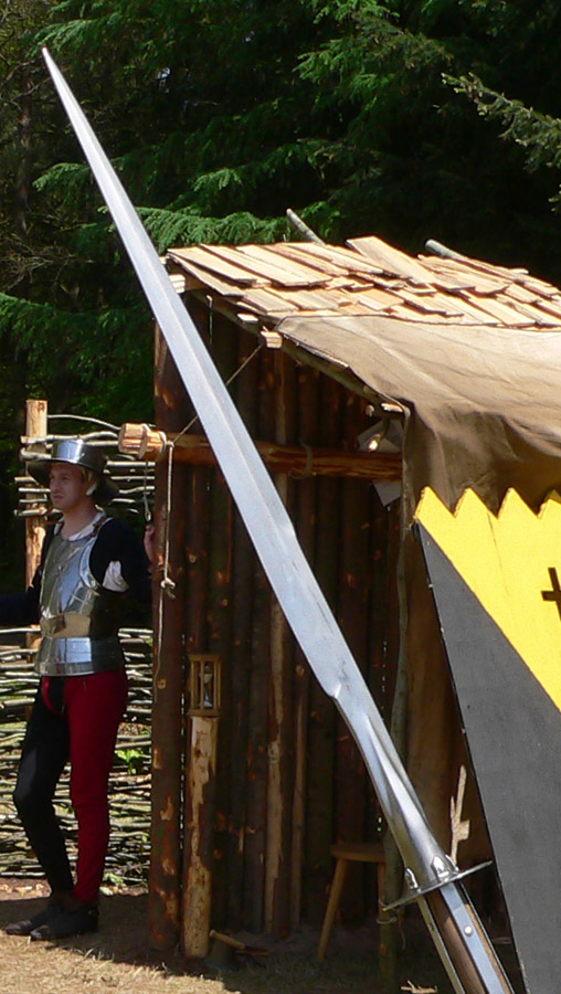

I've been aware of this distinction in miniatures for some while, but decided to seek other opinions. Here are two messengers from a single manuscript, BNF Français 95. One has a double edged spear head with medial rib, which seems quite normal for the XIII century. The other has a single edged spear head, perhaps we should consider it a glaive. This is not the only manuscript which shows both types in use, and it doesn't seem odd in a world where both double- and single-edged swords were in use, Does anyone know of any extant examples of spear heads with a single edge?

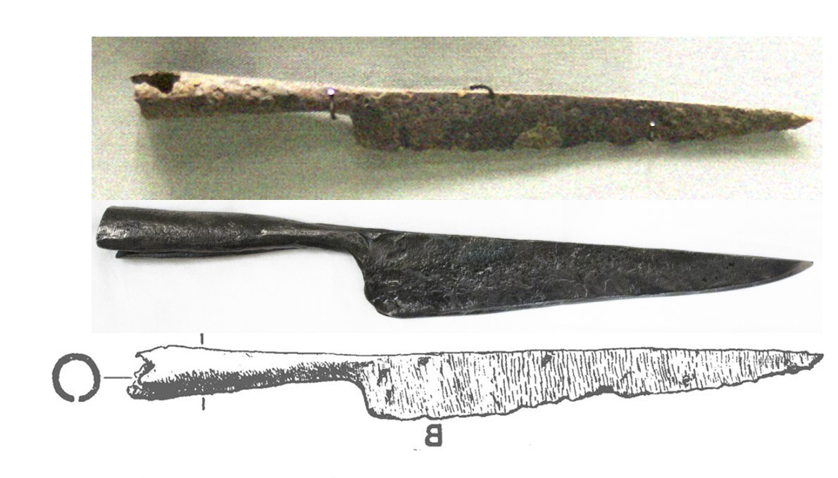

Thanks for sharing that woodcut Sean. The spear head scabbard is a cool idea that I'd like to see recreated.
If I remember correctly, there are two single edged spear heads in the National Museum of Ireland. One found in the Islandbridge excavation dated to the 11th century, and the other found at Ballinderry Crannóg dated to the 9th century.
I took this image from a now defunct discussion forum. I think that it's the example from Ballinderry.
Attachment: 120.43 KB

Looking back over my notes, the example I posted has a blade length of 115mm. The other example apparently has a blade length of 228mm but unfortunately I don't have an image.

Certainly socketed knives (#11 & 14) were known in the late Roman period. The benefits of such can be seen by the re-appearance of the modern Cold Steel product, as one can change the tool from knife to spear by the addition of a longer cane or sapling, which make me wonder if what might have been identified as a socketed knife might also be a socketed spear.

The overwhelming majority of the socketed single-edged blades in the archaeological record are farming and cooking implements, not weapons. The only way to confirm whether it was intended as a weapon is for the context to be properly recorded. If it was found together with other martial items such as shields and helmets, then it is likely to be a weapon. Otherwise the assumption of its purpose must default to a domestic context.
