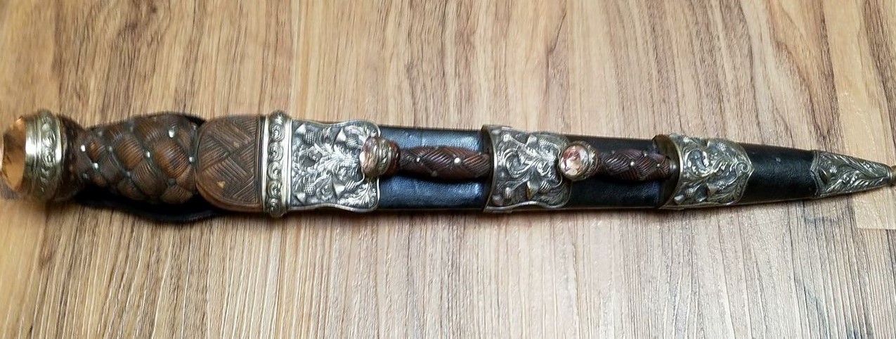

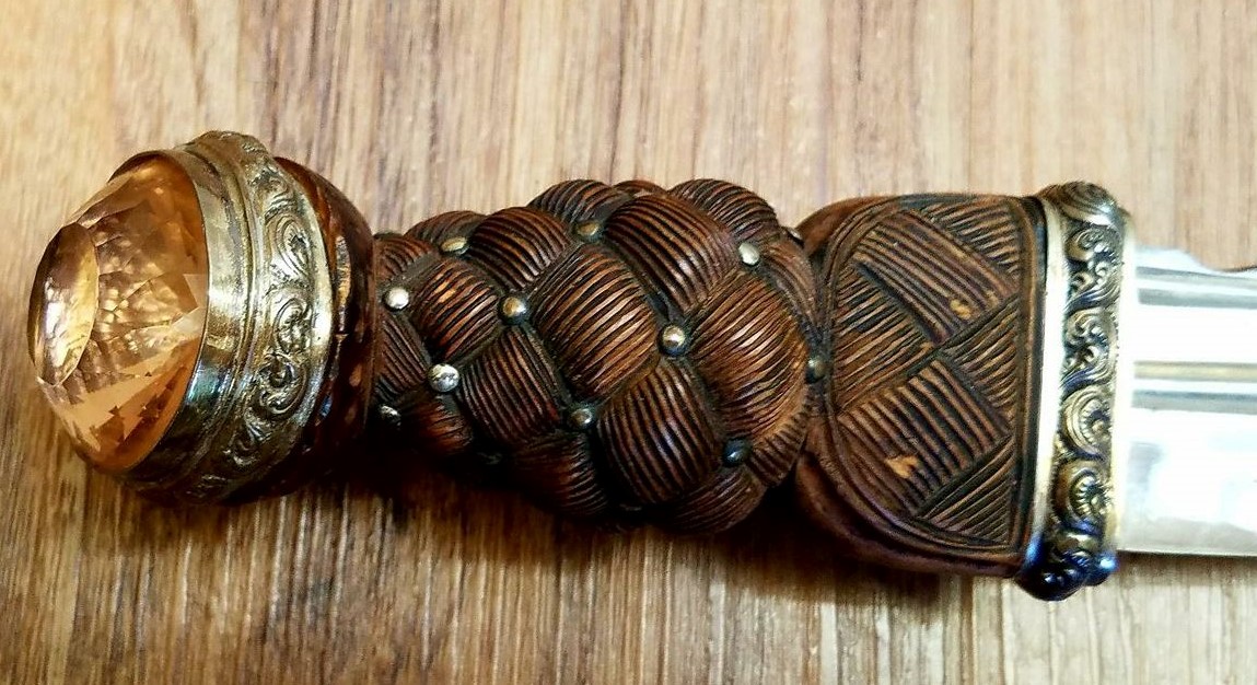

A friend has come to own his great-grandfathers dirk, and is seeking help in learning more about its origins. The dirk blade was repaired about 15 years ago by a Scottish weapons shop in the Carolinas, which estimated the dirks age around 200 years old with the main blade much older. The family name is Davisson, but I have no idea where they were from or which regiment they may have been associated with.
Your thoughts are much appreciated - thank you!

Richard Worthington
Posted: Sun 09 Jul, 2017 6:24 pm Post subject: |
It looks late nineteenth century to me. Possibly the same vintage as great-grand dad. It doesn't seem to be hallmarked, so it's probably got nickel alloy mounts or it's plated. Nickel alloys didn't come into common use before about 1830. Are the stones foil-backed?
Hopefully someone else with more knowledge will reply.

Posted: Mon 10 Jul, 2017 5:39 am Post subject: |
Would say probably mid-19th C rather than late, the grip hasn't fully changed into a useless attachment with extremes of size, shape and decoration . The stone mount has begun to rotate but the rest of the grip looks good and useable, blade looks funtional enough too.

Posted: Mon 10 Jul, 2017 8:48 am Post subject: |
Two hundred years old is unlikely. I agree that it could date from the mid to late 19th century but it could also be early twentieth century. It is in nice condition and has not seen a lot of wear. The leather appears supple (not dry and cracked) and 200 year old leather seldom is.
These dirks were made by many different companies in Scotland and England and frequently sold to officers in Highland regiments. They were seldom used and were an ornament and status symbol for the owner.
The dirks were nearly always marked by the maker. Have you found any hall marks or stampings any where on the sheath or the blades? That will be a big help in identifying and dating it.

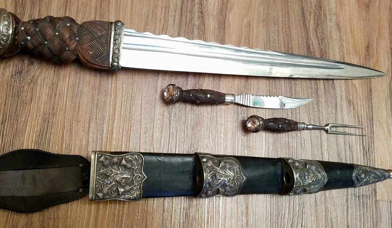

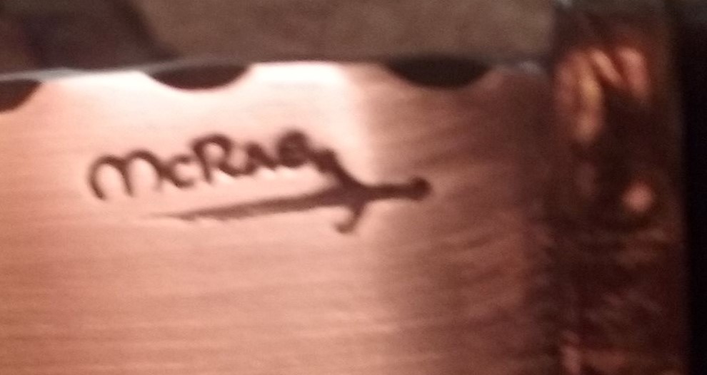

Posted: Wed 12 Jul, 2017 1:16 pm Post subject: |
Lin, my friend had a sgian dubh custom-made to match the dirk, by the fellow in the Carolinas. His mark is "McRae". Does that name seem familiar - it was made about 15 years ago.

David Wilson
Location: In a van down by the river Joined: 23 Aug 2003
Posts: 803
Posted: Wed 12 Jul, 2017 2:08 pm Post subject: |
Mike McRae is a well-known maker of Scottish-style dirks and sgians. He is still in North Carolina, and he is still active. His website is http://www.scotiametalwork.com/index.html where you can see several other pieces by him.

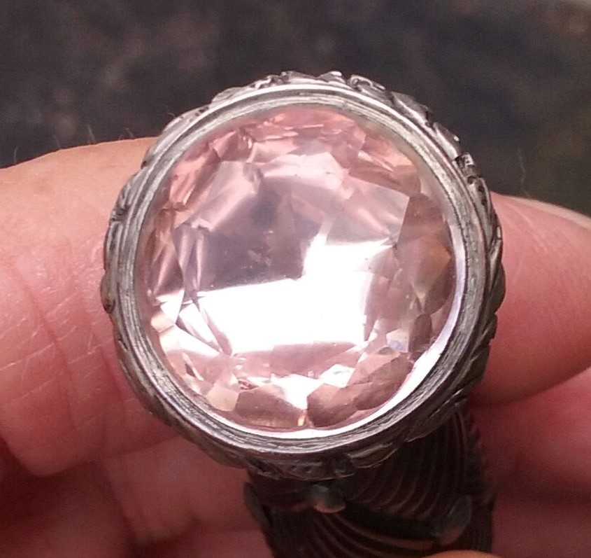

Posted: Thu 13 Jul, 2017 6:59 pm Post subject: |
Here's more from my friend, and a photo of the distinctly NOT orange stone!
"I seem to remember McRae telling me the design on the main blade was an older style design which made him suspect my dirk was a "remake" from an older dirk utilizing the old blade which is why he thought any marks on the blade may be under the handle."
"Here is a photo that best represents the stones true color....they are not orange but pink."
Does the color of the stone offer any additional clues to the time period, maker or place of origin of this piece? As always thanks for your thoughts.

Richard Worthington
Posted: Thu 13 Jul, 2017 8:13 pm Post subject: |
Cairngorms were the stone of choice for Scottish dirks in the 19th century. They are a Scottish variant of smoky quartz with a nice orange-yellow colour.
Later imitation Cairngorms are bright orange glass. Earlier glass stones had a metallic foil underneath for colour.
Cairngorms, the real ones, became scarce due to their popularity, so other stones were sometimes used as a substitute, or just because.
The pink stone in the most recent image looks like a gemstone to me, not glass. Possibilities include pink topaz and pink tourmaline, but I'm just guessing.
