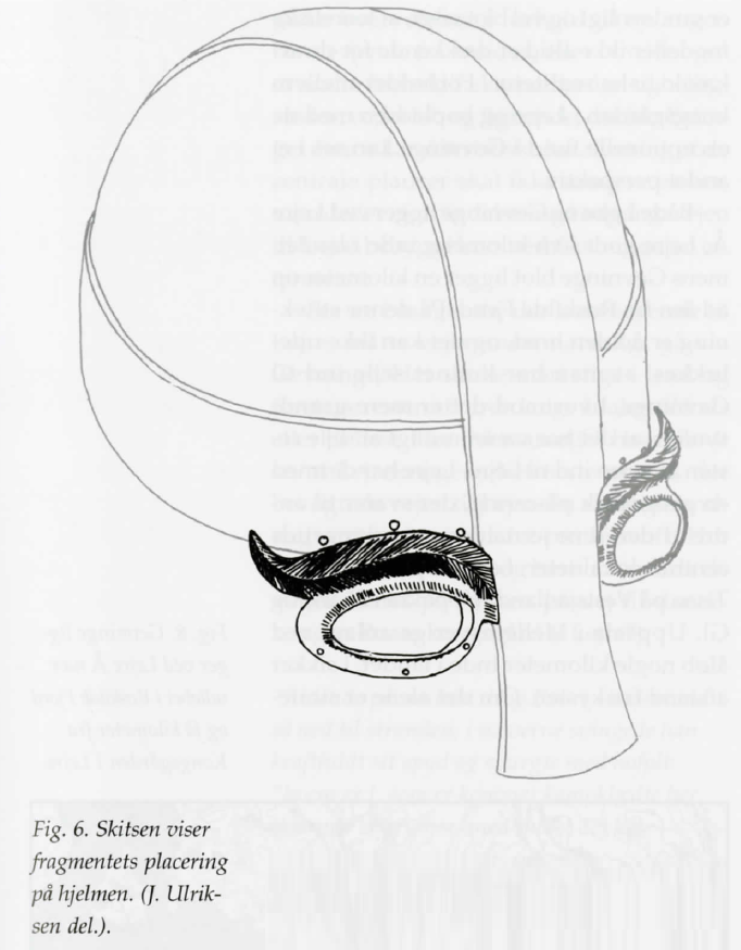

Nothing like replying to a thread three years after the fact, but there's now a Wikipedia page on the Gevninge fragment which contains most of the published information on it. There's also a relatively new (2015) book by Tom Christensen (Lejre bag myten: de arkæologiske udgravninger), but it is unfortunately only in Danish.
Christensen dates Gevninge to 500–1000 AD, which accounts for the fragment being dated to either the late Iron Age or the Viking Age. Paul is right, however, that dating the piece based on its stylistic characteristics suggests a tighter date (550–700 AD per his paper).
It is interesting that the fragment has three holes, presumably attachment points, on both its top and its bottom. This suggests a slightly more elaborate helmet than that sketched by Christensen (2002, see attachment). It could, for example, fit onto something such as the nose/eye guards on the Vendel I (picture) or Valsgärde 5 (picture attached) helmets.
