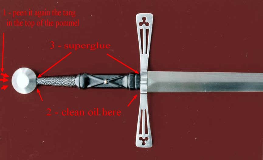

Fulvio Del Tin got back to me and recommended three simple actions:
1. cold repeen (as described here http://www.foxtail.nu/bjorn/bonk_eng.htm)
2. oil removal
3. a drop of superglue x2
(please see the image attached)
He also was not too optimistic about low viscosity adhesive (see his reply below).
So, I thought I should try superglue before peening, and it actually worked well.
I removed the oil from the sutures between the wooden grip and the cross/pommel with a thin paper towel and added a drop of superglue at each side.
The handle is not making a crackling noise any more.
Surely, this may be just temporary fix. In case the porblem recurs, I will then repeen.
Hope somebody else may find this handy!

Occasionally it happen that the grip become loose after some time, the grip is made in wood. I suggest to repeen the tand in the top of the pommel and normally this is enough to solve the problem.
As I told you before, two drops of superglue are also helpful.
I have never used low viscosity adhesive inside the grip and do not suggest you to put much of this glue inside the grip since the sword could not be disassembled easily in case of exceptional maintenance work. But you can eventually try to put just a small quantity of this adhesive after you reppened the sword.
Attachment: 40.63 KB
