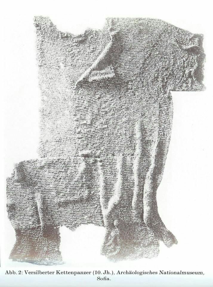

Luka Borscak
Posted: Wed 02 Aug, 2017 12:33 pm Post subject: |
Covered with silver is simply said "silvered". There is a silvered mail shirt from Bulgaria, 10th century supposedly. Probably byzantine manufacture.
