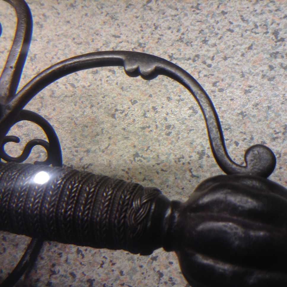

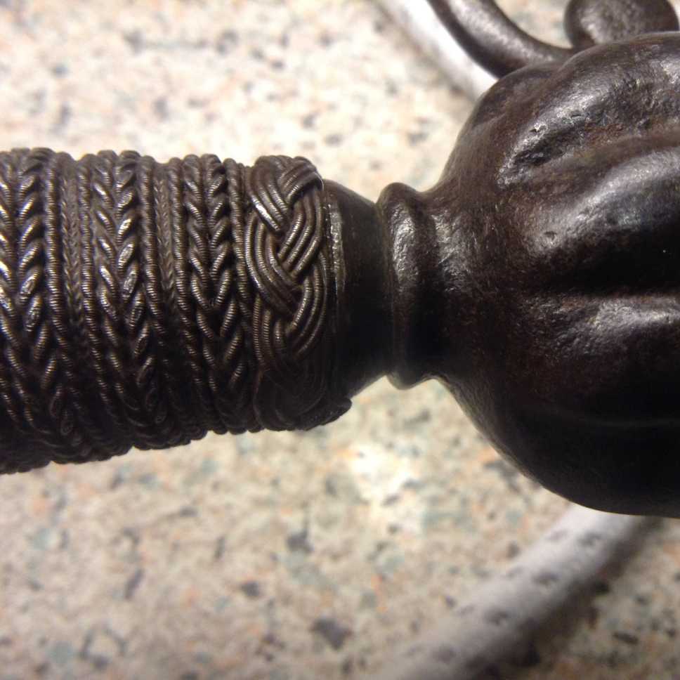

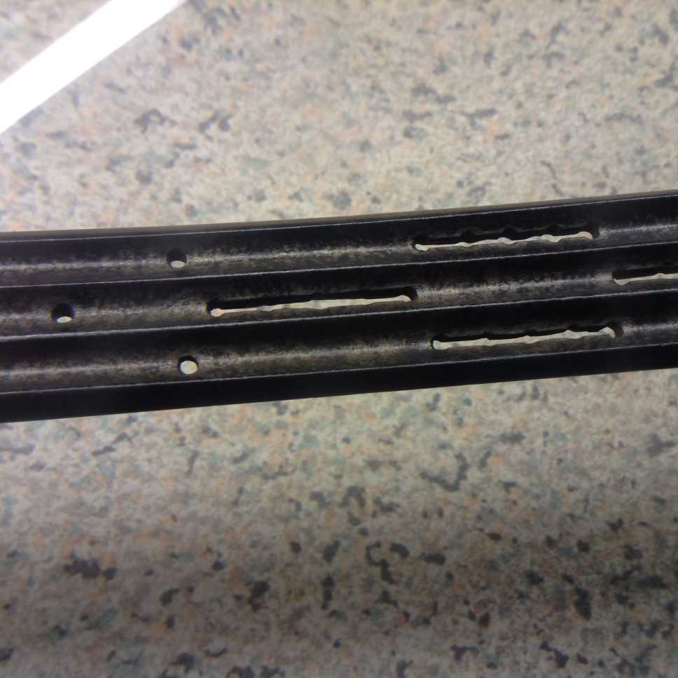

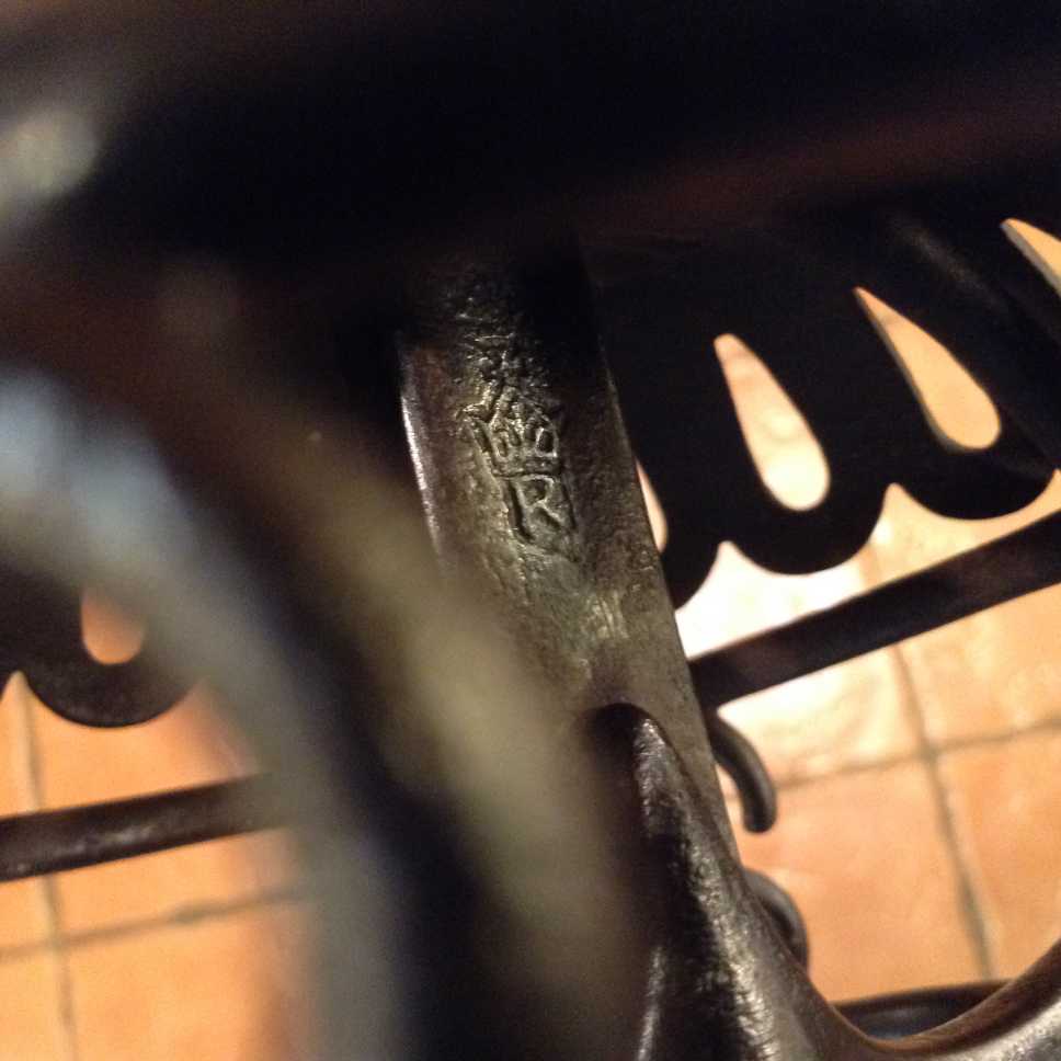

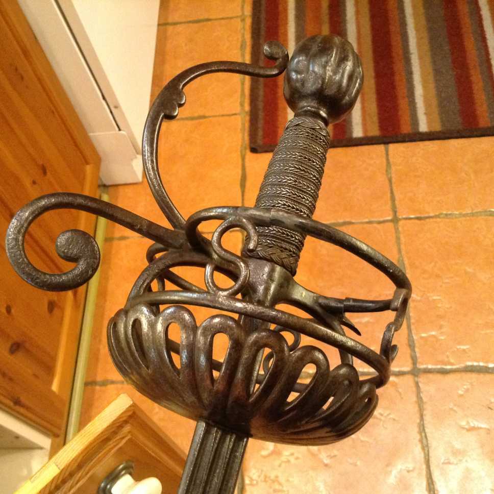

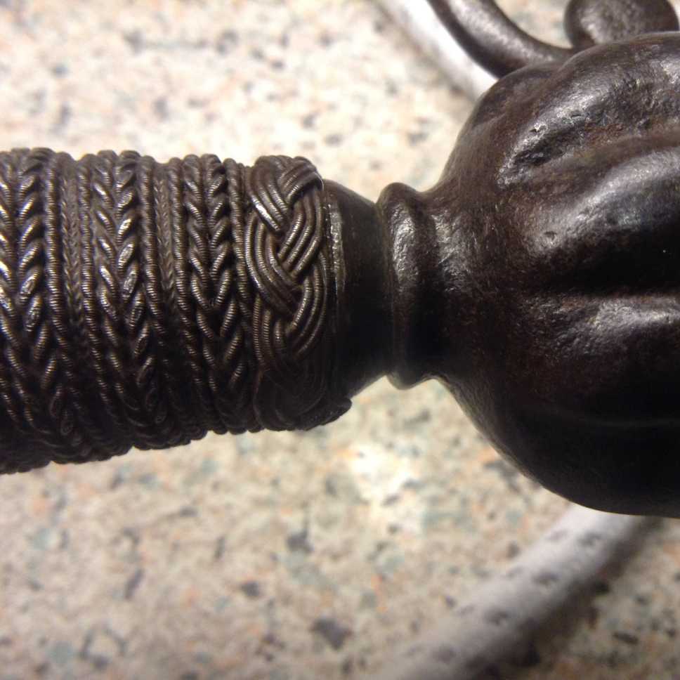

Hello guys , would like some feedback on a recent acquisition which is outside my normal field of collecting , it is a rapier overall length 50 1/2" , blade from tip to front of pierced guard 42 1/4" , blade has fretted slots and holes in the triple fullers , above the guard are rings with four S. Shapes around it , forward facing quillon ( 1 absent ) curved knuckle bow and heavy pommel , wire bound grip with Turks heads , overall weight 2 lb 13 oz , armourers mark of a crown surmounted with a cross and the letter R , condition is as found in Ireland , any points or advice is appreciated as my field is British military longuns . Many thanks Gary

Hi Got this. Mail from a friend showing an armourer. Fernandez Ruiz of Toledo ( 1617 ) crown with cross and letter R ?

Sorry my mistake , that should have been Francisco Ruiz ? Possibly , would be nice to see another few of his stamps on other swords though to compare . I have been advised that I have measured the blade length wrong as I measured to the shell guard , apparently you should measure to the crossguard , having done this the blade length is actually 44 7/8" . Thanks. Gary

This thing is huge! As such, I think it is real, the extra long rapiers of the early 17th century are not that popular in reproductions if I recall correctly. Though it is somewhat suspiciously light, could you find where the balance in the blade is?

Actually 50,5 inches of full length is not that long for a rapier - I saw historical pieces with blades of 50 inches long, or even more. That's in fact an average length for the late 16th century/early 17th century swords of this type. The rapier is light (about 1,27kg, if I am not mistaken?), but not that much, it is also included in the average area that I saw on historical specimens.
Have you the blade length including ricasso, from quillons to tip? And the balance as well, from quillons too? It can be a good clue.
Could you also tell us the blade thickness on the ricasso, and the blade cross-sections? Is the blade sharp, or is it fully blunt, without real edges?
The two things that actually puzzle me are the pierced blade and the hilt shape. I've seen many parrying daggers with pierced blade, but never a rapier, as far as I remember. The hilt is quite unusual.

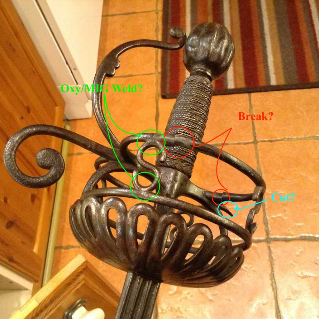

Overall it looks pretty good, I respectfully disagree with Guillaume, concerning the blade punching --this is not that uncommon on rapier blades.

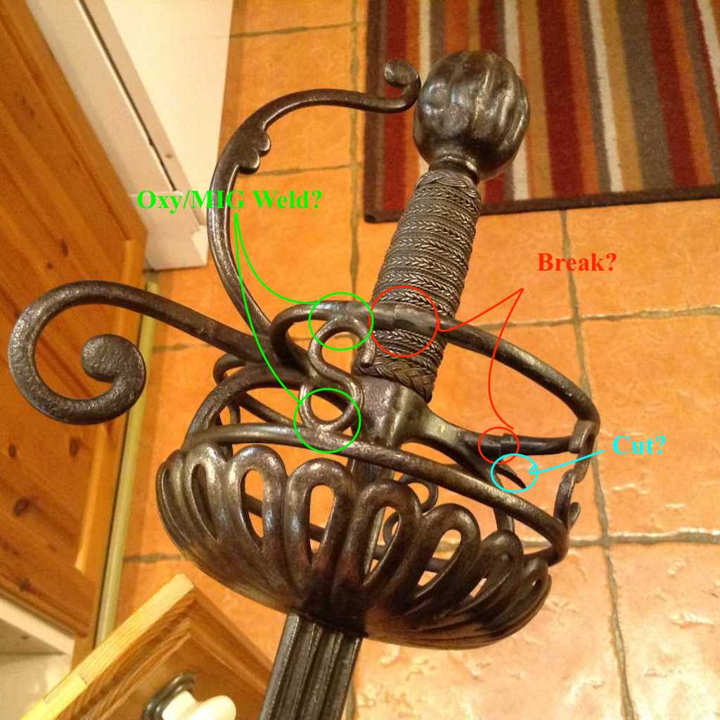

My concern is that it looks pieced/built up. The blade, grip, and pommel look authentic... possibly Spanish.. but the guard looks suspicious, possibly Victorian. I'll look into it further and see what I have in records.
The issue is a break on the upper side-ring, and it looks like the cross-guard on the false edge was cut purposefully? The last thing is the S between the upper and lower side-rings looks spot welded with an Oxy-fuel weld... which is obviously much more modern! See attachment! This contrasts with the overall matched/aged patina which has a good, uniform, appearance.
I think you might get more help if the topic title is changed.. something akin to: Real or Fake 17th Century Rapier from Ireland?
I'll have a look around and get back to you!
That's what I would spontaneously said - a maybe original blade, but a hilt changed later, maybe middle or late 17th century. That is often seen on historical pieces, both on rapiers and daggers.
