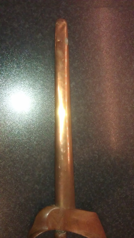

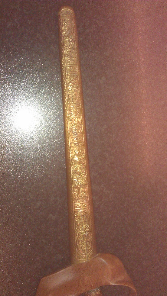

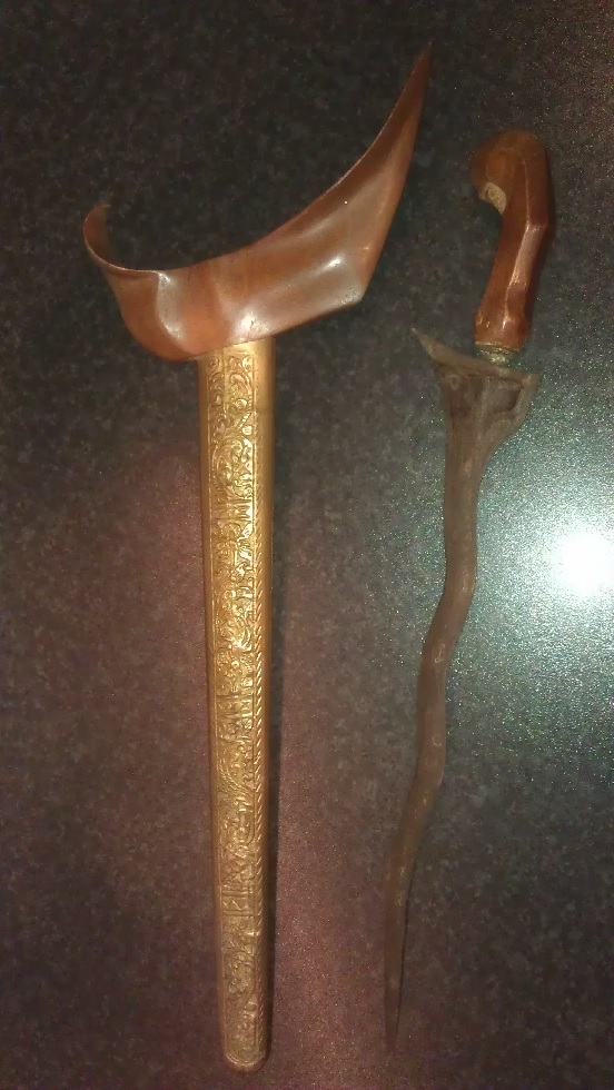

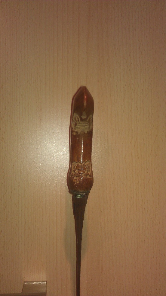

Patrick Vonk
Posted: Wed 18 Jan, 2017 1:46 am Post subject: |
Thank you all very much for your comments. They have already been very informative. It took a while, but as advised I have uploaded some more pictures to help determine how much this particular specimen is potentially worth.
Attachment: 241.13 KB
Attachment: 188.91 KB
Attachment: 163.95 KB
Attachment: 139.45 KB
