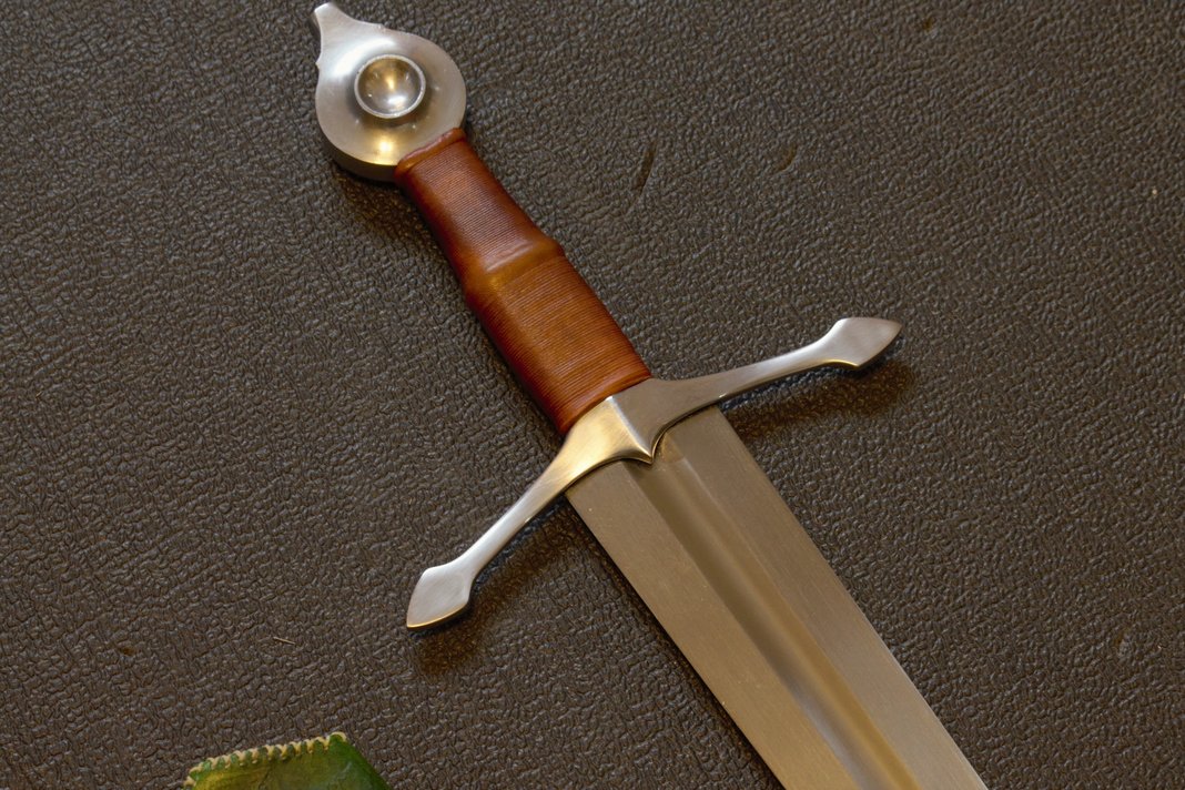

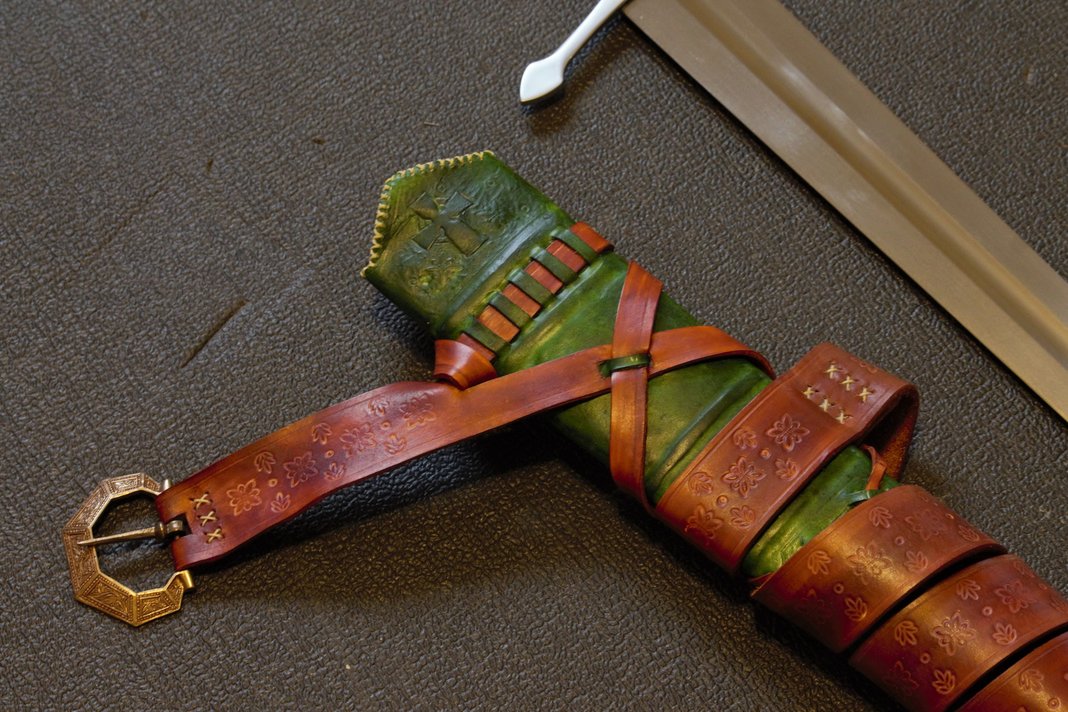

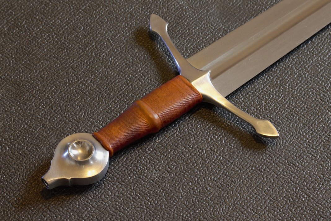

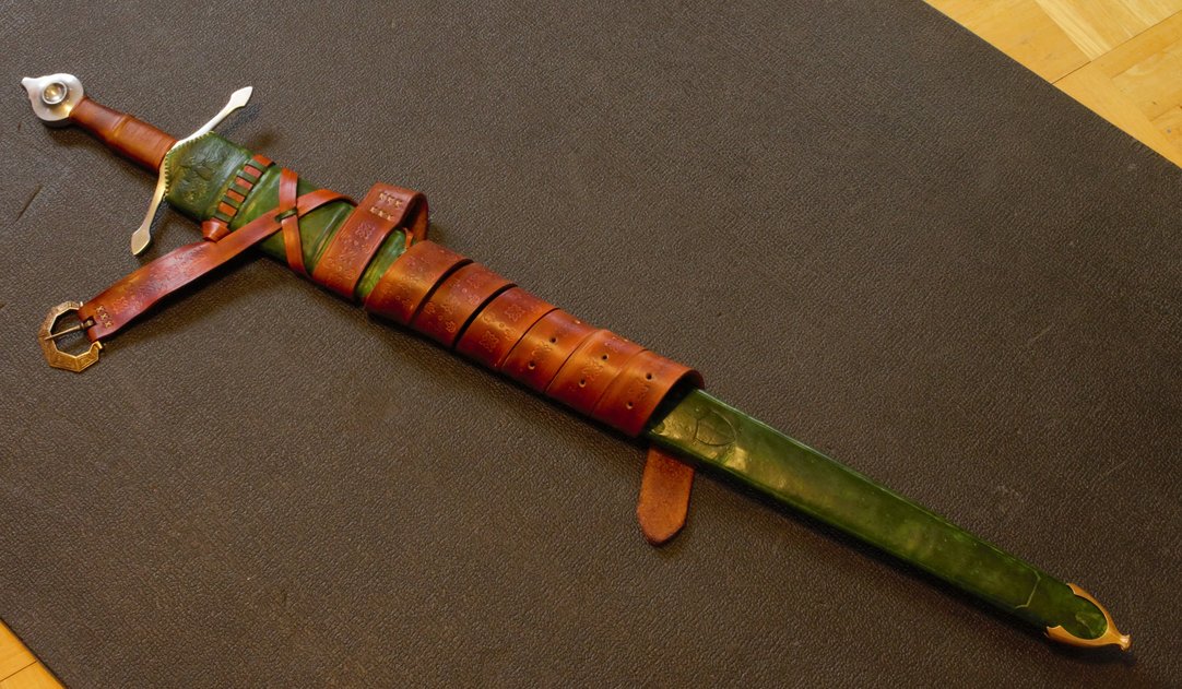

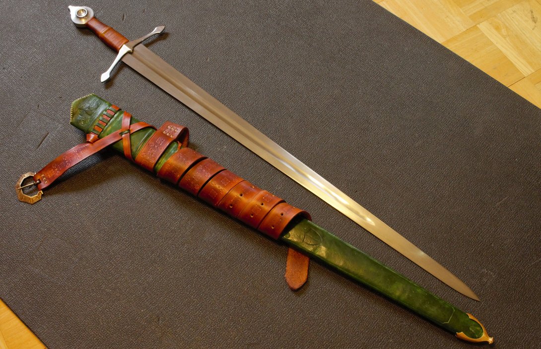

I wanted to share a personal project I've been working on; an H/T EMSHS blade paired with The Printed Armoury's "Dunvegan" fittings(and one of his Knightly chapes for the scabbard). I built the scabbard using linen and hide glue over poplar slats; the inside is also lined with wool felt that's been treated with gun oil. The leather cover is glued on some areas in addition to being stitched up the back; the scabbard fits tightly enough that it can be held upside down without the blade falling out. The method I used is certainly effective, but I did note at least one drawback; after the linen has dried around the slats, surface is uneven and rippled. This can be remedied somewhat with a belt sander, but there's a limit to what can be done without compromising the integrity of the core, thus resulting in a surface that is not as even and refined as on high end scabbards. Any commentary on the differences/effectiveness of different methods would be greatly appreciated.

Julien, in regards to finish, all the fittings I received came with a mirror polish that I sanded down to a satin finish. Again, the quality is not entirely consistent here; the Dunvegan and Viscount fittings I got have small dings and scratches, while a Zurich set was completely immaculate. I agree though, I would love to see more designs, even simpler ones.

Thanks Ryan. Here are the stats:
Overall Length: 38 3/4in
Blade: 32in
Blade width: 2 1/8in
Weight: 2lbs, 8oz
POB: ~6 1/4 in
Compared to the average H/T EMSHS(for stats: http://kultofathena.com/product.asp?item=SH2404 ) , this one has more blade presence and cutting power, for about the same weight. It doesn't feel heavy or cumbersome, but is also not as nimble in the thrust compared to other Type XII reproductions available. If you enjoy cutting oriented swords, this one would fit the bill. Or if you just like the Scottish theme...
