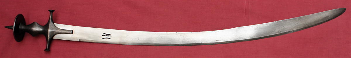

First of all many thanks for your time and information, it has made for very interesting reading. I'm surprised that it was felt these swords were somehow inadequate as the one I have appears to be very substantial and well enough made, I wonder if various cutlers interpreted the specifications differently or as nowadays the quality of steel varied quite a bit from maker to maker. I have attached a photo, I think I'm correct, of a Light Cavalry Trooper within the correct time period with one of these swords at his side. I really like the blade on your Officer's sword the 'pipe back' reminds me of the 'yelman' found on Indo Persian, Caucasian and Persian blades the purpose of which is to increase the cutting ability of the blade at the point which includes the CoP, see attached photo of an Indo Persian sword of mine which has this feature. You are correct in that I did ask on the SFI Forum a question regarding an Officers H.C. sword of mine and you did indeed help with this. The record for this sword only has dates and unfortunately no names, the previous owner whom I eventually was able to contact had already researched to this point, I didn't know this at the time of posting on SFI. This still leaves the question of the sword's ownership, see photo with initials on blade, would be nice to find out more. Thanks again for your help.

That is a great photo! I love these period photos of soldiers with their weapons. Happy The yelman on my officer's P1821 is the nicest I have seen on this pattern and is much more Eastern in inspiration than others. Thank you for posting your example. I will see what I can do about helping you identify the owner of your sword. The monogram is extremely helpful. Happy
