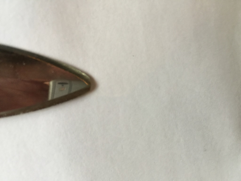

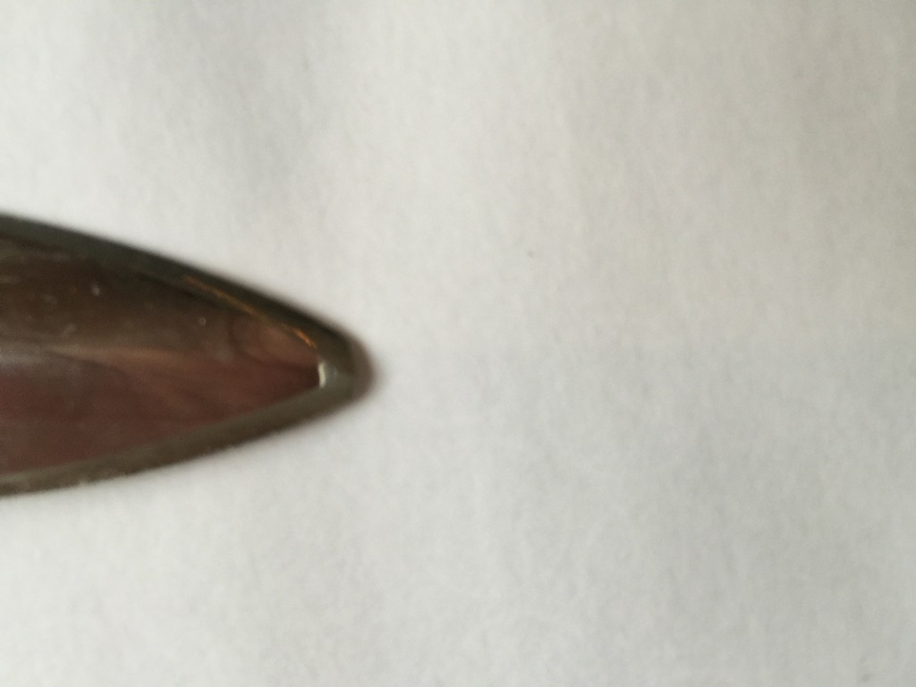

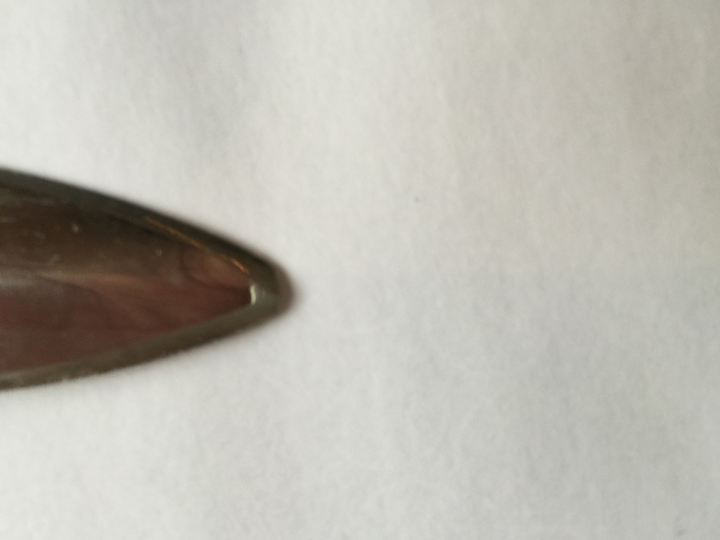

Ulfbehrt sword; this thing, even though I paid the sharpening, could not cut anything, even though the edges looked like they were somehow done, but very rough. When I took a look at the tip, it was gone, this thing was totally cut off. and the sharpening was not nearly even. Ok, this is not bad, that can be handled. But the blade itself looked bit of misaligned/dent on the top 1/3 of the blade, as if it had been used and manipulated to almost straight (sorry I cannot get a pic of this good enough, so ou have to count on my word).

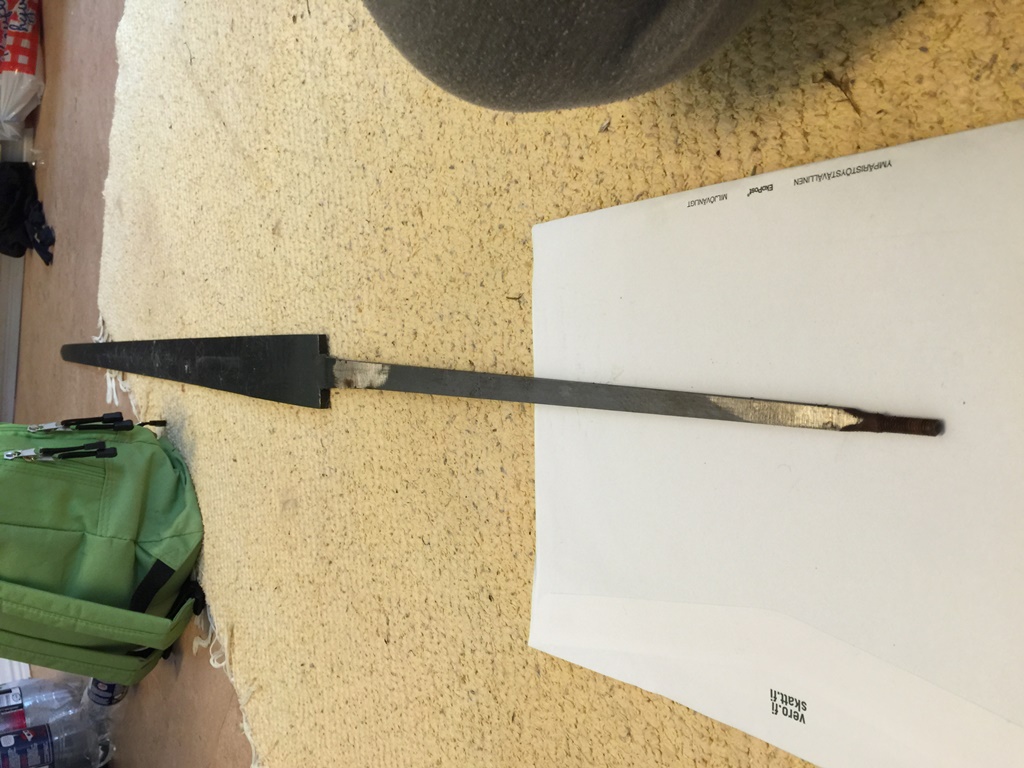

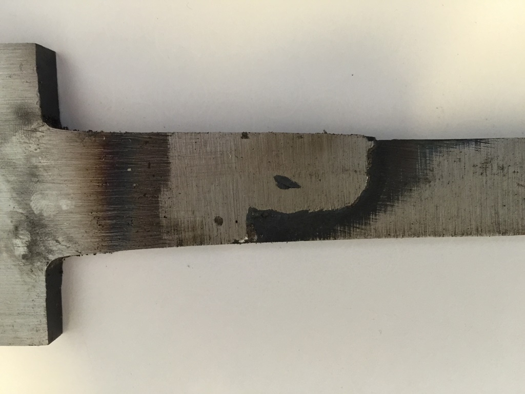

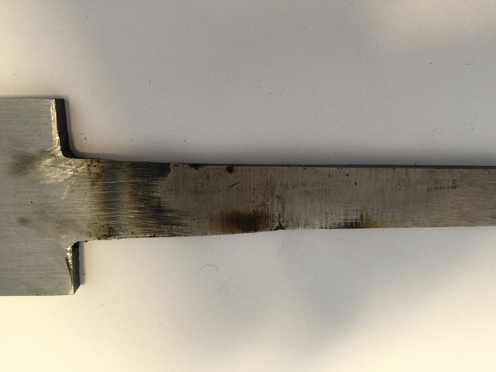

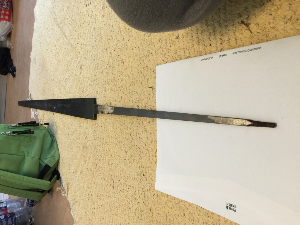

Lowlander; now this was more interesting. I noticed the same misaligment/dent type as in the Ulfberht (naturally this was my first reaction to check). I thought ok, I think I can live with these. But when I I started to assemble the guard, and

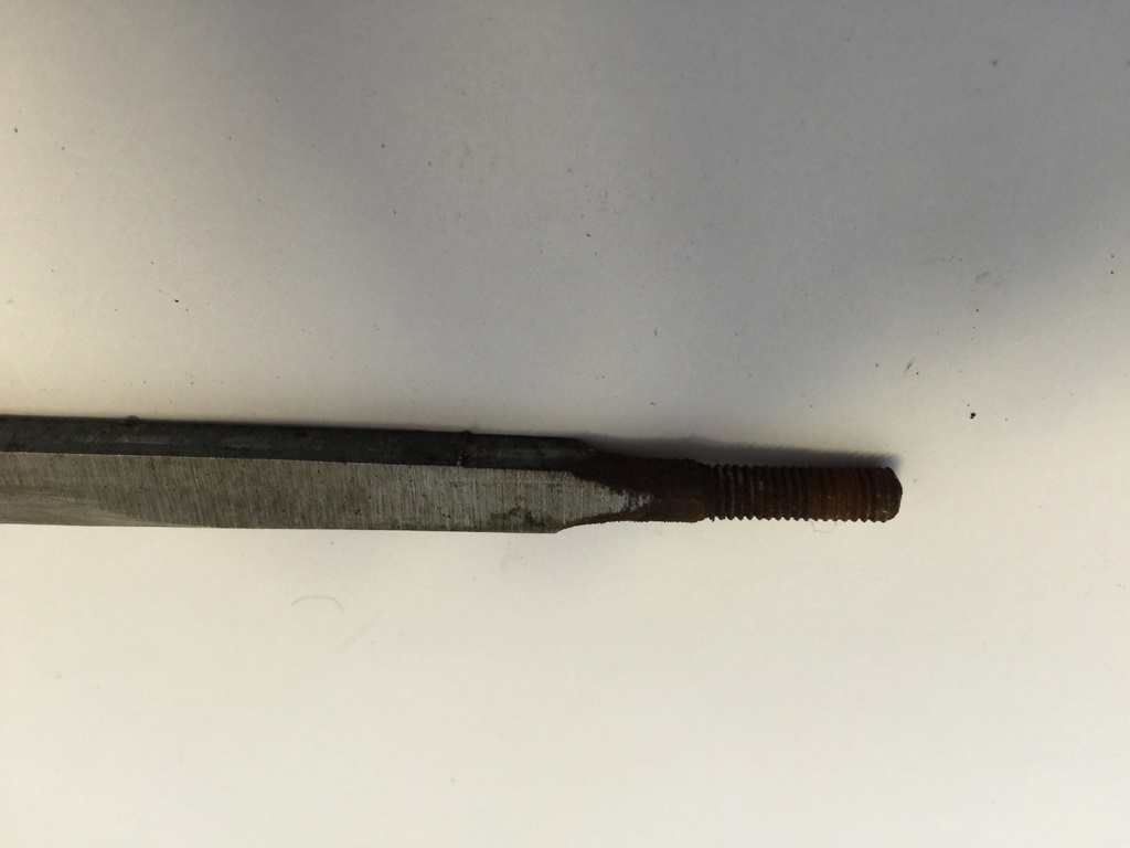

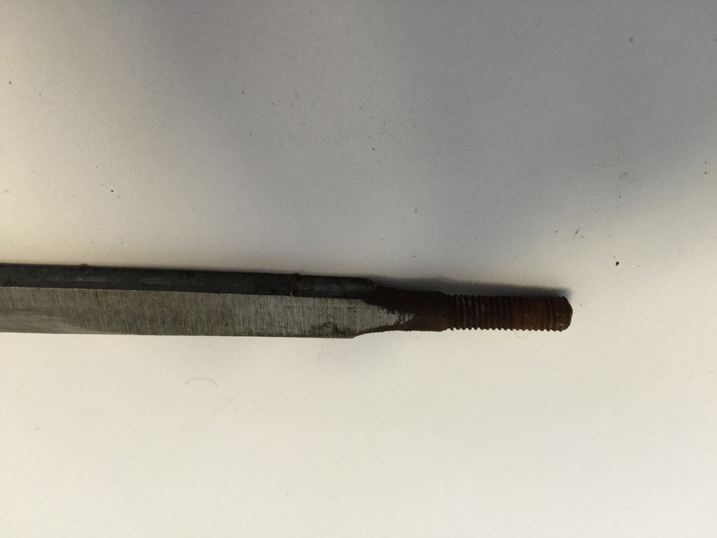

- when I removed the pummel, I noticed the threads were completely rusted (see pics rusty end 1 and 2)

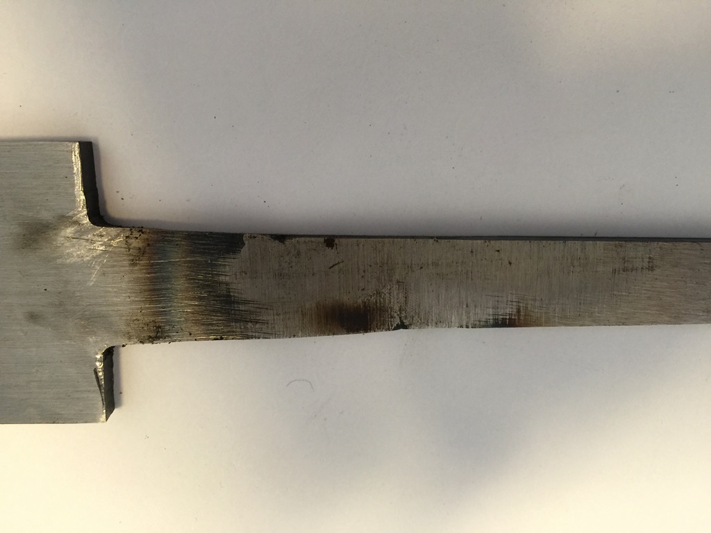

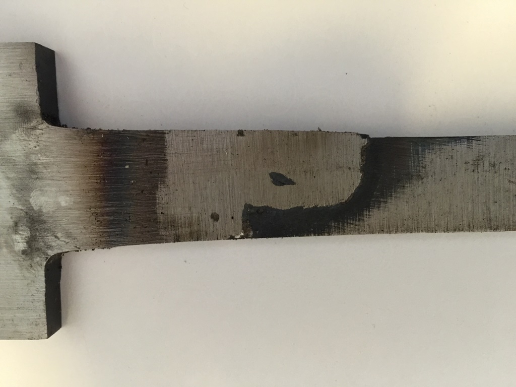

- when I removed the handle, I noticed a big weld looking section (see pics Hanwei weld and Hanwei weld 2), which has been like sandpapered with a really rough sandpaper, file or something of sorts (you can see the lines from the pics how they go different directions)

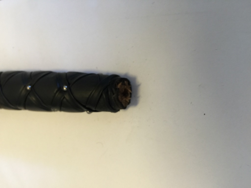

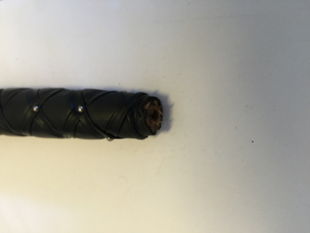

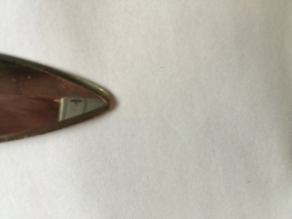

- Also the handle’s pummel end is already looking like it has been used and wood falling apart (see pic handle end)

Based on the pictures you've shown, I'd have some questions but I don't think these are second hand. I've always heard that KoA inspects products before they ship and unless something happened to the Windlass in customs (which can happen), I would have thought that might have gotten caught at inspection. That tip is not on par for my experience with Windlass products, but its also not out of the realm of possible for them I suppose.
From what I can recall of my purchases from Kult of Athena packaging was reasonable. Not on par with high end special made boxes, but reasonable.
The Hanwei, I don't know what to think because I don't know the product. Looks like they welded that threaded section to a tang stub. But that's a very non-expert opinion and its not necessarily a problem. There are makers who assemble this way without issue. Ever. There are others that are less successful doing this. Its not what I like and I'd really want to know if Hanwei are all that way. If they all are (they likely all are) you don't have a problem.
Good luck with this. I hope you somehow end up with a happy outcome.

As far as the lowlander, thats how it's constructed. the two areas in question are where the blade is welded to the tang and where the tang is welded to the rod stock for the screw on pommel. the weld bubble is ground flat . The fraying on the end of the handle is because the grip is made out of a cheap fiberboard; durable enough with the two steel end caps but one of the reasons why you're able to pick up a 70" greatsword for south of $300.
the edge being wavy down the windlass is most likely a windlass thing. they are budget swords. The edge of my Windlass revolutionary war sword also wanders off true despite the spine being straight; to be expected on a $130 blade.

That actually is what I think about many of the bargain swords out there. those welds are probably okay. most grips are no good unless you're at the top of the market, and provide one of the easiest ways to improve a sword. we can talk you through the grip upgrade if you'd like to try it. you'll never wish for the original.
