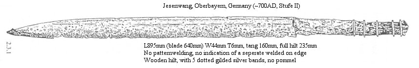

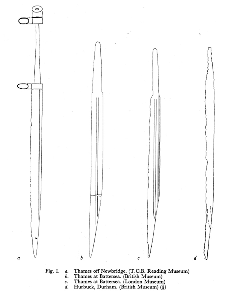

From the small amount of evidence we have of hilts, they seem to have been quite bland. But also, much much long then the one they put on. The normal size for the hilt is about 23cm, some may even have been longer. One full tang variant shows that the hilt was divided in first a straight part starting at the blade side, then a waisted part. From earlier saxes, we know that many were covered in thin leather. I've attached some examples.

Thanks Jeroen. I like the look of the langseax in the diagram above too. Is there an original pic available for this and an idea of dimensions and weight?
