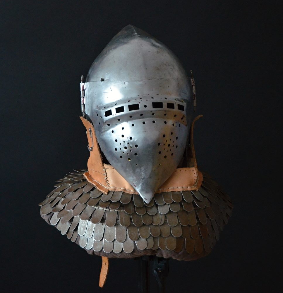

PostPosted: Wed 02 Mar, 2016 8:59 am    Post subject:         Reply with quote
Dear Bernard,
I've done a good share of HMB (We call it "Heavy Metal Buhurt" though), so I know exactly how it works, and what requirements the equipment needs to fulfill.
First off, this kind of sport takes a huge toll on your equipment. Expect heavy denting and deformation within a good year of use. Keep that in mind, you might need a helmet every few years...
This is the one I use for HMB:
Keep in mind that the larger the holes, the weaker the material holding your visor together.
I wouldn't go larger than 8mm, the design shown on your last example image is already about perfect.
Reason is, as I said, HMB takes a heavy toll on your gear... so if the holes are too large, there is too little metal in between, and breakage from heavy hits is more likely.
When you get pollaxed in the mug, you really want that visor to hold.

PostPosted: Mon 07 Mar, 2016 4:26 am    Post subject:         Reply with quote
You're welcome!
Yeah, I can breathe okay in it.
Breathing while wearing a helmet will never be as easy as with a raised visor or no helmet at all though, always keep that in mind. Razz
One last suggestion: Make the hinge of the visor and the locking mechanism (You NEED a locking mechanism in HMB) as solid, thick and reinforced as possible from the very beginning. You don't want those to break.
