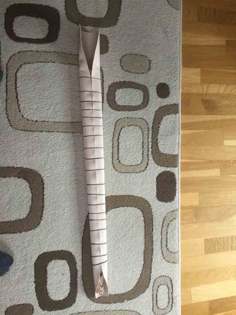

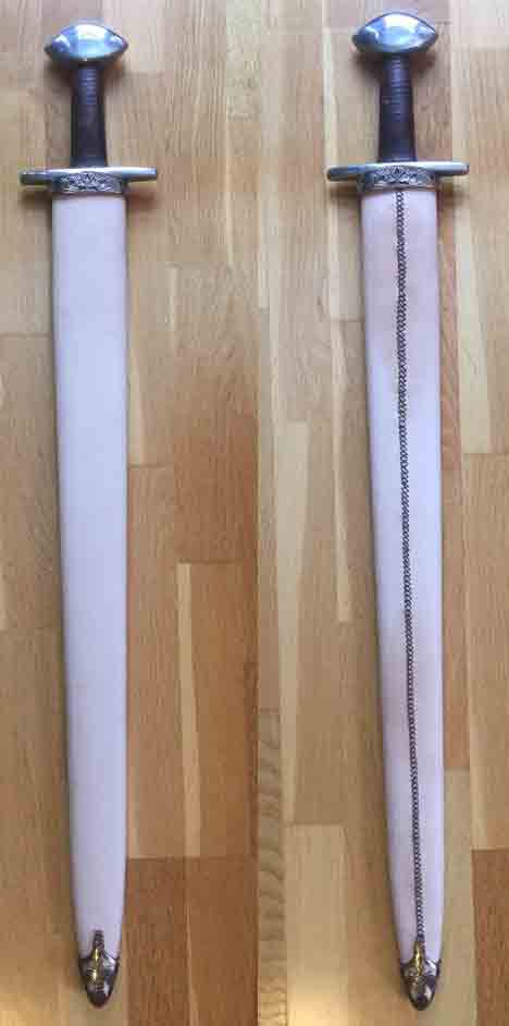

I'm building a scabbard and so far i've been learning leather working by messing things up so I thought I'd go get some advice for a change. I've finished the core and am about cover the thing with leather for the second time since I messed up the first one a bit. Does anybody here have experience with this?

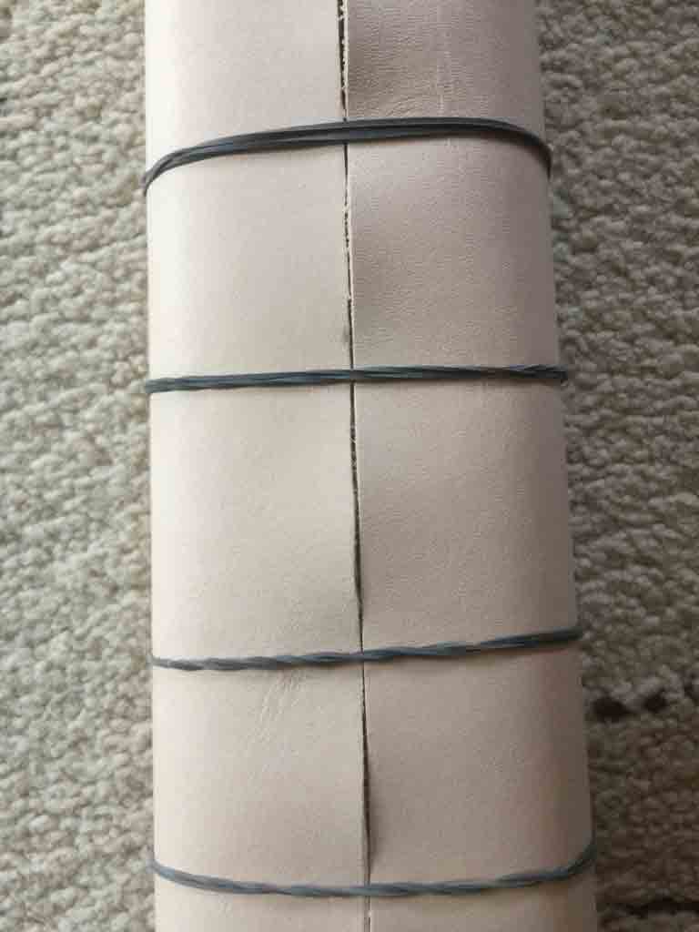

  • I What do you guys use to punch the sewing holes in the leather? I tried an awl and a spiked hole marker wheel but the holes ended up not quite matching which resulted in a crooked and messy seam. Should I be using a fork-chisel? It makes slits instead of holes but they are regularly spaced and easier to sew.
  • Should I soak the leather or can I just sew it on while it is dry? It looks to me as if the only part I might have to soak and wet-form is the chape area.
  • The first time I tried my hand at this the I made the leather about 10 cm longer than the scabbard and soaked it but it shrunk to the point where it was about 1 cm too short but there seemed to be little shrinkage breadth wise across the scabbard. Does it matter in terms of shrinkage whether you cut the leather strips head to tail or back to belly?
So far I've got the leather cut down perfectly so that the edges of the leather just barely touch down the entire back of the scabbard and plenty of material left over at the top but this time I'm going to be more careful.
Edit: There are no fancy raised decorations or lines on the scabbard, just a plain leather covering.
 Attachment: 37.36 KB
 Attachment: 26.17 KB
Harry Marinakis
PostPosted: Thu 03 Mar, 2016 12:18 pm    Post subject:         Reply with quote
Congrats on your scabbard, looks great so far.
Everyone has their own preferences as far as technique is concerned.
Never try something on your scabbard that you haven't practiced first on scraps. Your scabbard is not for experimentation and practice. Make a mock scabbard and try some different techniques until you are comfortable.
I use a pricker that marks holes every 3/16 to 1/4 inch and then I punch holes with a diamond shaped awl. I don't mark or punch the entire edge, I work in sections so that the holes stay aligned.
You can sew wet or dry, as you please.
Wet leather is a joy to work with, but it is very susceptible to scratches. Also you cannot use waxed thread because your fingers will transfer wax to the leather and then the leather won't dye properly. Most people seem to sew wet and they dye the leather, but on occasions you may have to dye first and then sew dry.
I never pay any attention to which direction I cut the leather, head to tail or back to belly, I don't see a difference.

As others have said - work in sections (about 4" long). Mark a line on each edge about 1/8 inch US from each edge BACK. Run your stitching wheel down ONE SIDE. Punch your holes with an awl, but STAY ON THE LINE.
Don't use the wheel on the other side - instead, make a small mark on your line DIRECTLY OPPOSITE to the holes you just punched on the other side.
Stich. Do not stich the last set of holes. use these as an index point for you next run with the marking wheel.

Yes, I measured the scabbard's circumference every 10 cm and the chape end every 1 cm and then made a paper template. My first mistake was to assume this would could be transferred directly to leather, it can't. The leather covering ended up being too small so now I cut an excess of 5-10 mm on one side of the leather, fix it to the scabbard with rubber bands so that it overlaps and then use a leather marker pen to mark exactly where to cut. Then I trim it down with a very sharp pair of scissors. It is tiring to apply all those rubber bands for every test fit of the leather but the seam ends up looking very nice. It also helps to draw a datum line down the length of the wood core with a CD marker (I varnished the wood) to make sure the seam is centred when you are sewing

Must comment on paper templates in general. What you experienced is very common - it has to do with the PAPER being far THINNER than even 2-3 Oz leather, and the fact that the leather wraps around.. Try to make a shaped throat locket from, say, 4-6 Oz leather? It gets worse. Paper templates are great as long as everything is FLAT.
When in doubt - take a scarp of the leather you plan to use, wrap it AROUND the core area you are working with, mark the ends where the leather meets. Now use THIS measurement on a paper template. Repeat (probably many times). You will end up with a paper template that accounts for your leather thickness.

I make a template from tinfoil and masking tape, wrapped around the scabbard. Cut that up the back and use it when marking out the leather. I allow an additional 3mm seam allowance and then, once I've stitched it, I trip off the excess and rub the seam flat (early medieval scabbard seams are serpentine, so this is perfectly authentic).

Well I sewed the leather on dry which went rather well apart from a few misaligned stitches. The chisel worked great. There were a few bulges in the leather, especially at the cape end so I wet the whole thing down with a sponge without completely soaking the leather. This caused it to shrink a bit and the bulges went away. It also had the side effect of letting me slide the leather over the varnished surface of the wood core to straighten out most of the crooked seam sections. It's not a great seam but considering this is my first stab at building a scabbard I'm pretty happy.
 Attachment: 15.49 KB
Harry Marinakis
PostPosted: Sun 06 Mar, 2016 10:41 am    Post subject:         Reply with quote
Good job!
