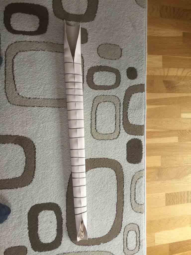

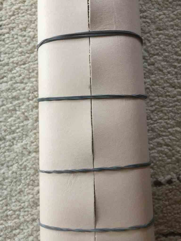

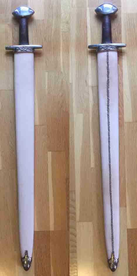

I'm building a scabbard and so far i've been learning leather working by messing things up so I thought I'd go get some advice for a change. I've finished the core and am about cover the thing with leather for the second time since I messed up the first one a bit. Does anybody here have experience with this?
- I What do you guys use to punch the sewing holes in the leather? I tried an awl and a spiked hole marker wheel but the holes ended up not quite matching which resulted in a crooked and messy seam. Should I be using a fork-chisel? It makes slits instead of holes but they are regularly spaced and easier to sew.
- Should I soak the leather or can I just sew it on while it is dry? It looks to me as if the only part I might have to soak and wet-form is the chape area.
- The first time I tried my hand at this the I made the leather about 10 cm longer than the scabbard and soaked it but it shrunk to the point where it was about 1 cm too short but there seemed to be little shrinkage breadth wise across the scabbard. Does it matter in terms of shrinkage whether you cut the leather strips head to tail or back to belly?
So far I've got the leather cut down perfectly so that the edges of the leather just barely touch down the entire back of the scabbard and plenty of material left over at the top but this time I'm going to be more careful.
Edit: There are no fancy raised decorations or lines on the scabbard, just a plain leather covering.
