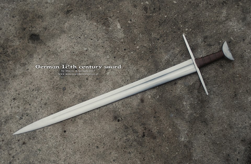

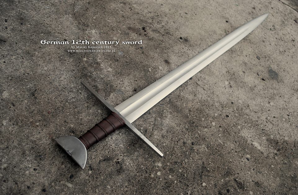

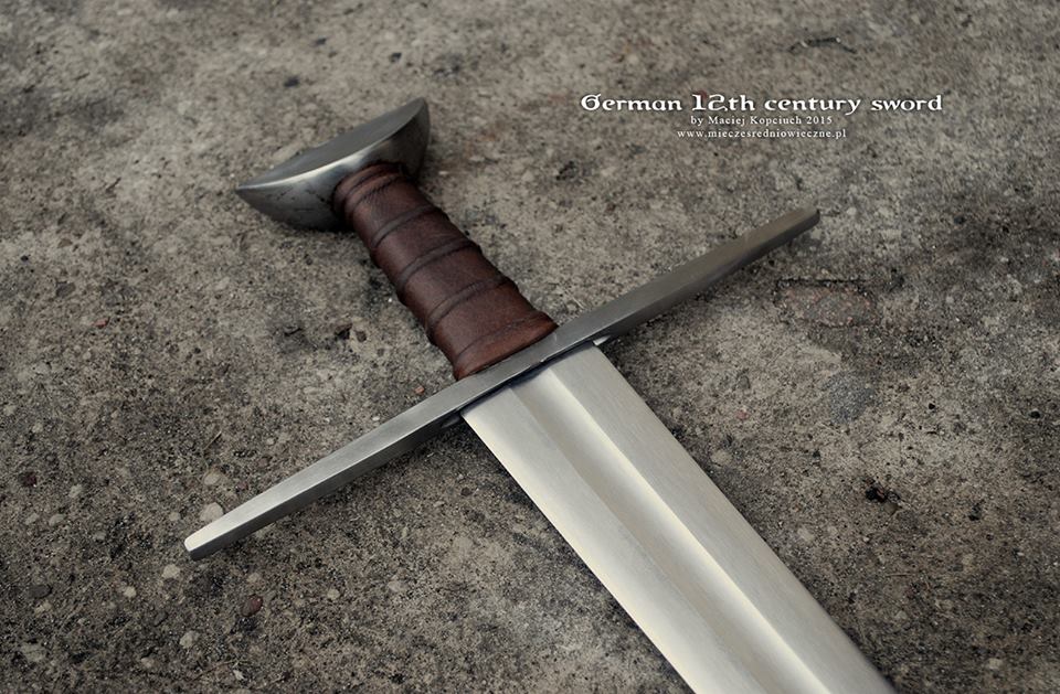

Hi J.D.
I also have a sword from Maciej and it's pretty awesome piece.
I'm posting the images that he shot,because of the quality.
P.S. My sword was based on one from Christie's too,sold long time ago and now in private collection.
P.P.S. Dating of the sword is mistaken by Maciej,it's 13th century,instead of 12th.
Regards,
V

I like that piece very much. At first glance is similar to one of mine (in the avatar to the left) but it has a more roof-shaped top on the pommel, whereas my type O is more boat shaped. Yours also resembles a Swiss sword and one of the Naumburg sculptures.

Yes,my sword's pommel is type N,a bit earlier than type O.The "roof top" is narrow,instead of curved.
The blade is 30inches long and massive.Even my poor hands are feeling the power and potential of that weapon.

Viktor, how much does your sword weigh? How well does it handle? Does it feel good to wield it? I would guess that the Point of Balance is fairly far down the blade.

Hi Roger,
Well,the sword weights 1200gr. and it handles very well.
I'm not a trained one guy,but it doesn't tire my hand.
Point of the balance is very well precised,a bit below from center of the blade towards the crossguard.
In conclusion - that is a heavy and powerful sword which maneuvers fast and doesn't beat your hand.
