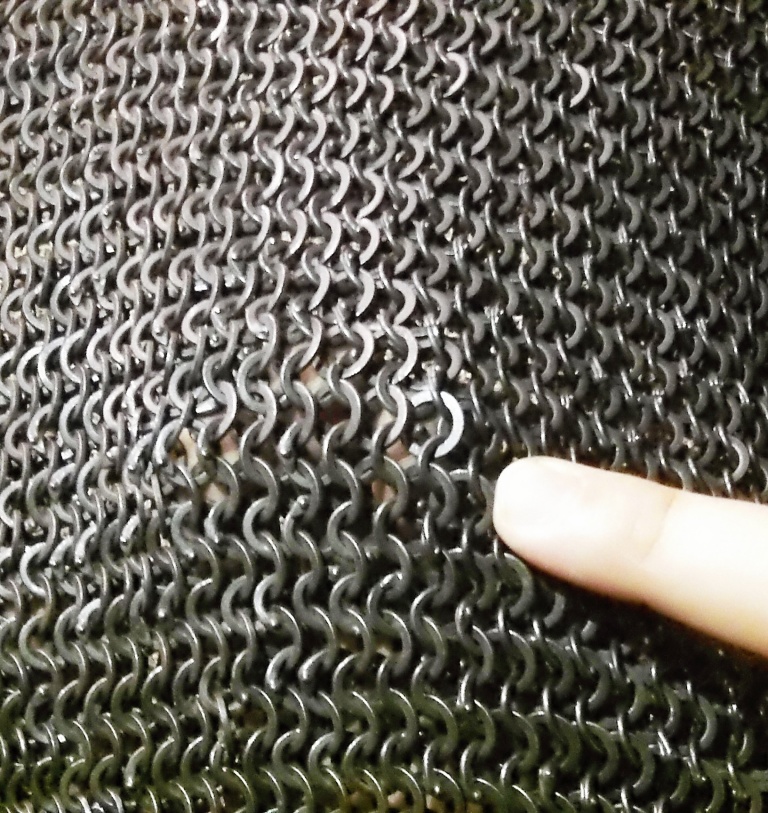

Julio Junco
Joined: 08 Jan 2006
Posts: 16
PostPosted: Sun 13 Dec, 2015 11:55 am    Post subject:         Reply with quote
I know it only in mm but I think is ok.
You can roll the wire in a 7 mm mandrel and when you do the overlap the ring go smaller than 7 mm innternal diameter. Nice and more dense but more work. And the Viking Ages mails can be bigger than 8 mm.
I put photos with 7 mm ID and 8 mm ID so you can see how it looks. The wire look the same 1'3 or 1'5 mm, only more resistent withh thick wire.
Julio
