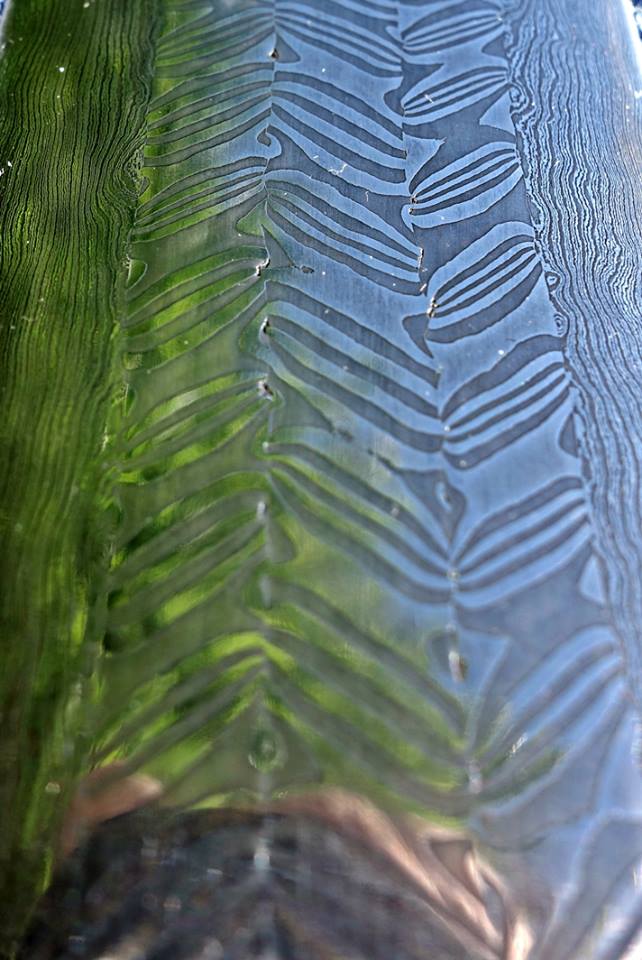

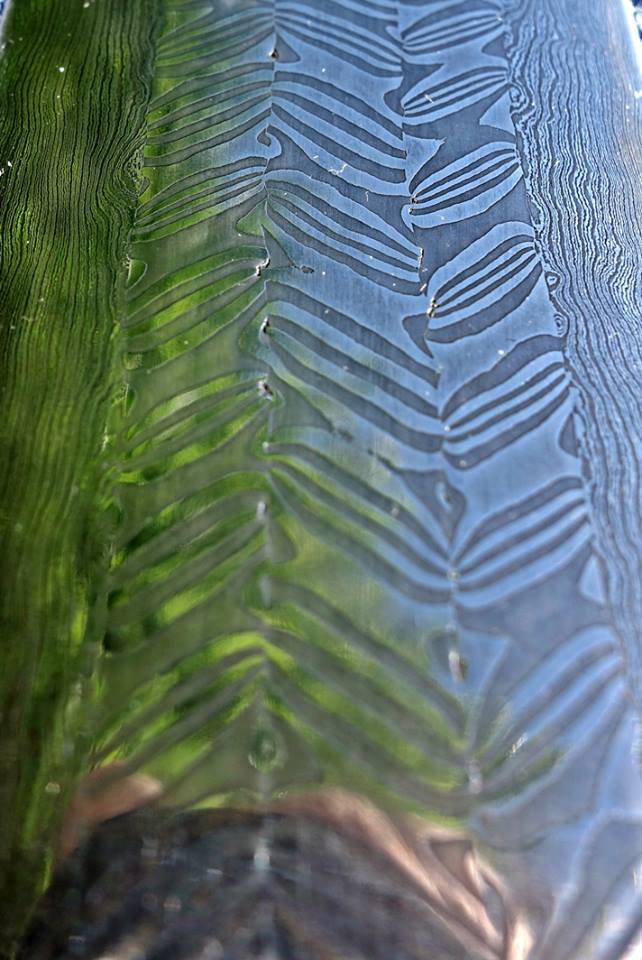

Neither of these has anything to do with "Damascus steel", which was a form of crucible steel imported to Europe from India through Damascos, hence the colloquial name; it's more properly called wootz.
What you see here is called pattern welding, i.e. several rods of varying grades of iron/steel are twisted around each other and forge-welded together to produce a single piece, which is then usually lightly etched to accentuate the visible pattern formed by the different metals. You can produce surprisingly precise patterns by carefully varying the way you twist and fold the rods. The pattern on the Mad Dwarf sword does seem larger and more chaotic than the others, but it is there, and if we saw more of the blade I assume we'd see it repeating several times along its length with some random variations each time.
Originally pattern welding was a method of regulating the carbon content and other impurities (some desired, some not) and thus the structural qualities of the steel - it's the same principle as with Japanese folded steel - but ever since we learned to make monosteel, i.e. steel with a homogenous metallurgical make-up throughout, like on the famous Ulfberht swords from the late Viking age, it really just looks cool.
The first three swords posted to this thread (including the one you posted, though it hasn't been etched and polished yet) all have a pattern-welded core, with edges made of a separate piece of harder steel welded onto it, as does the historical artifact David posted; Mad Dwarf's sword has the entire blade made of the pattern-welded material.

Just to clarify, the cutting edge of mine (a reconstruction of the Valsgarde 8 sword by Vince Evans) is also patterned, as you can see from this close up.
As (I believe) does the Bildsø sword.

Ah, yes, sorry - what I was trying to say is that the Mad Dwarf blade seems to be made from one piece of patterned steel, while the others have separate pieces of different steel for the edges, also pattern welded but in a different pattern from the core. You can see this on the WIP sword Sean posted, too.
