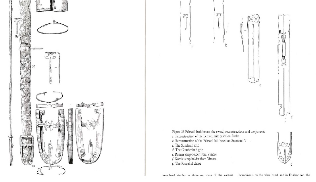

2) Look at mid-fifth century blades from a wider context. The best candidate from Britain would be the Feltwell spatha, which was hidden in the hypocaust of a bathhouse. Probably brought to the country by a Germanic warrior (possibly invader, possibly foederati), the blade, hilt and scabbard fittings are well preserved. The organic hilt fittings (wood or horn) have not survived.
Here's the drawing from the site report. I've got some photos as well if you're interested. It's on display in the Norwich Castle Museum.
Attachment: 120.83 KB
