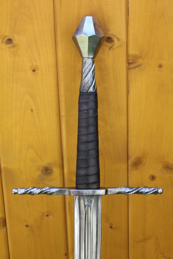

The sword handles surprisingly well for its weight, which is in no small part due to the heavy pommel which moves the center of gravity closer to the hilt. The simple spiral leather wrap feels smooth and comfortable and is soft enough to offer decent grip. It's significantly better than other grips I have seen from the same maker. The shape of the pommel and the rearward part of the grip can make training bare-handed a bit uncomfortable, so gloves are recommended even for solo drills unless your hands are tough enough anyway. The main caveat could be that it can feel wobbly if you take a blow to the flat of the blade.

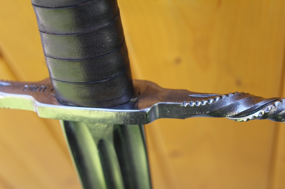

The hilt is solidly assembled and has not loosened up so far. The crossguard is apparently also not only wedged in place but brazed as well. The pommel is peened.

Since it's more than just a training tool the appearance does play a role. It's certainly not a historical reproduction, but it's definitely pleasant on the eyes and looks very neat when worn on the belt at a fair. The large grooves are machined, the small "nicks" and "teeth" decorations are incised by hand and give the hilt an almost pompous appearance.

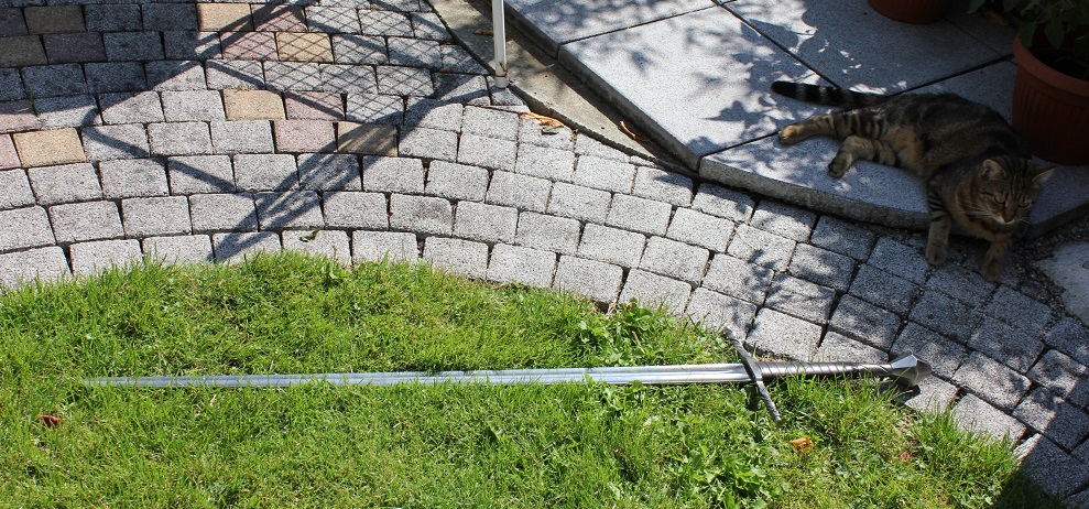

Obligatory cat for scale. [ Download ]
Total 1 [ Download ]
Hilt [ Download ]

Crossguard assembly [ Download ]
