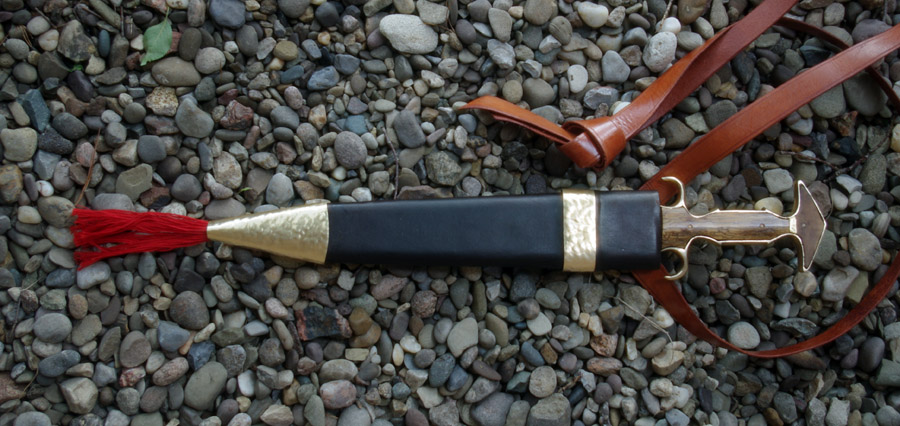

Well...... Here's what I did for my scabbard.
Poplar core
Leather sheath
Leather strap
Hammered bronze chape and band
Red wool threads

Harry, you did a great job on that handle. The mammoth and gold look awesome. Just stunning, I love the mammoth texture and color. Well done. The scabbard looks really good too. Since there is so little surviving example I guess the best we can do is try to stay in the spirit of the age and place with good materials. Would you mind putting a pic up of the back side of the scabbard so we can see how the scabbard is attached to the baldric?

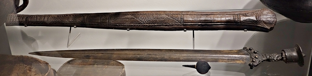

This one...from Store Kongehoj, dated to 1400BC. The earliest example of a tradition of carved wooden scabbards that lasted for at least 1800 years.

PostPosted: Fri 06 Jun, 2014 8:01 pm    Post subject:         Reply with quote
Wow...that's actually pretty stunning. To have lasted so long with such a nice carving...Thanks for that. Do you know if the scabbard was lined with anything like wool or felt?

PostPosted: Sat 07 Jun, 2014 12:20 pm    Post subject:         Reply with quote
No evidence of a surviving liner in it or any of the other ones I know of from Scandinavia.

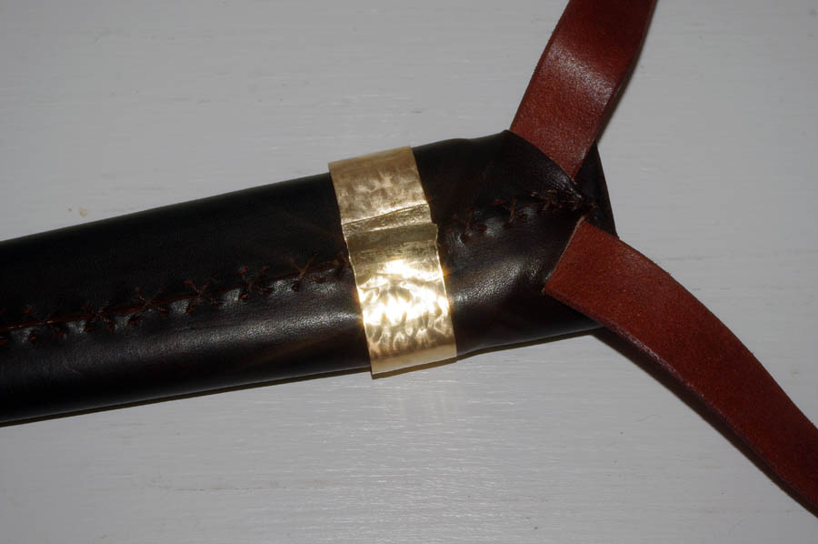

Harry Marinakis
PostPosted: Sat 07 Jun, 2014 7:58 pm    Post subject:         Reply with quote
Here is a photo of the back on my scabbard. The baldric strap was glued across the front of the wood core, then the strap tails were crossed behind the scabbard and exit the leather cover at a 45 degree angle. No historical precedence, just a practical solution.

Good grief Matt, that's a stunning scabbard. I have a fair few of Neils blades here...sorely tempted. I'm thinking maybe the carver was trying to evoke a horses head with the design at the top maybe?
