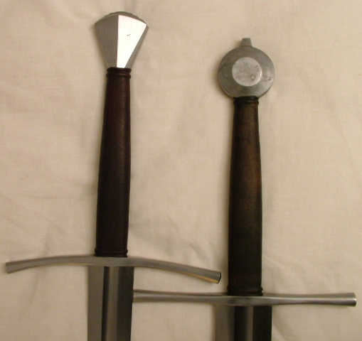

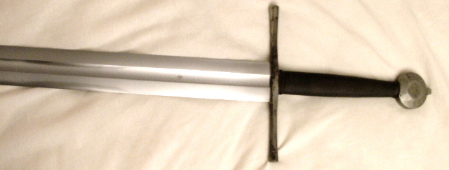

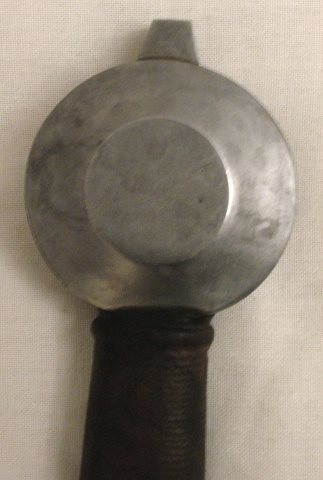

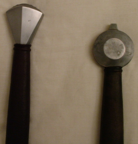

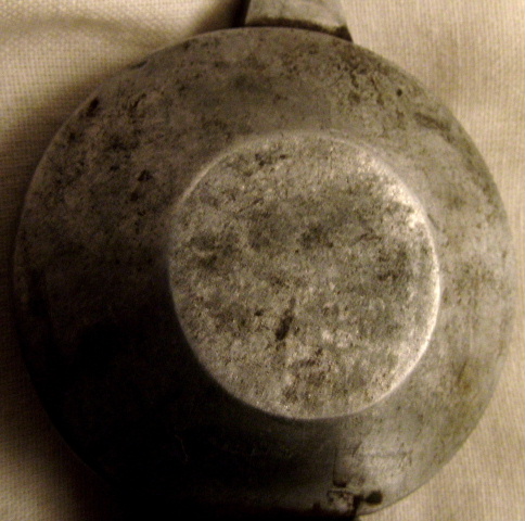

PostPosted: Fri 04 Feb, 2005 5:31 pm    Post subject:         Reply with quote
Sean Flynt wrote:
Alexi: I can't wait to see the results of your antiquing experiment. I suspect Peter and the Albion folks will be very interested as well.
Well here are few shots. It has not gotten yet to where I want it to be, but patience ...and more acid will do.
Alexi

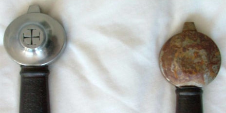

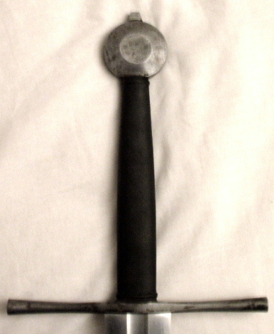

PostPosted: Sun 13 Feb, 2005 7:11 pm    Post subject:         Reply with quote
Here is what the pommel looked after 3 days of lemon juice. This is before cleaning the lose rust off. I do not think I will stop here as the pattern is not random and "natural" enough. For a comparison : a clean Albion pommel from the NG Baron.
Alexi

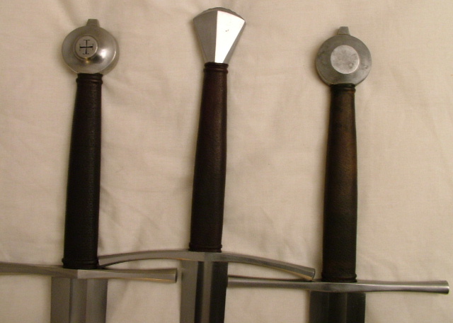

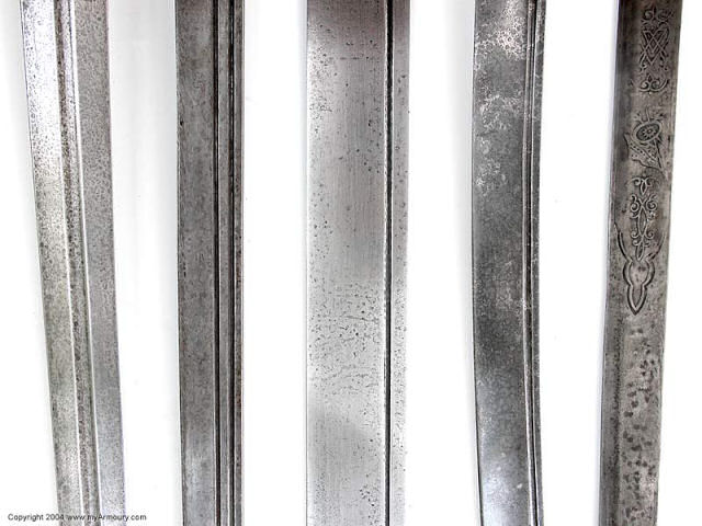

PostPosted: Fri 18 Feb, 2005 8:57 pm    Post subject:         Reply with quote
Here is the "after" shot. I also rusted the guard. I kind of like the contrast between the darker hilt componets and the bright blade. Lemon juice is the "bomb". Sorry for the lights. If I had better lighting, I could take more detailed shots to show the patination more clearly.
Just remember: acid rusts, metal but also removes rust easily.....so annoying sometimes.
Alexi
 Attachment: 65.04 KB
 Attachment: 55.39 KB
 Attachment: 105.65 KB
Stephen A. Fisher
Location: Kentucky USA
Joined: 17 Oct 2003
Posts: 455
PostPosted: Fri 18 Feb, 2005 9:20 pm    Post subject:         Reply with quote
Hey Alexi,
Poor Albion Duke. Cool Seriously, It looks great. I like the contrast as well. Although, I think the blade would look great if was given the same treatment as Seans MRL Falchion. It will give it the 'Could care less if the hilt is rusting, need to keep the blade clean look.'
(pictured in the middle)
 Attachment: 53.67 KB
